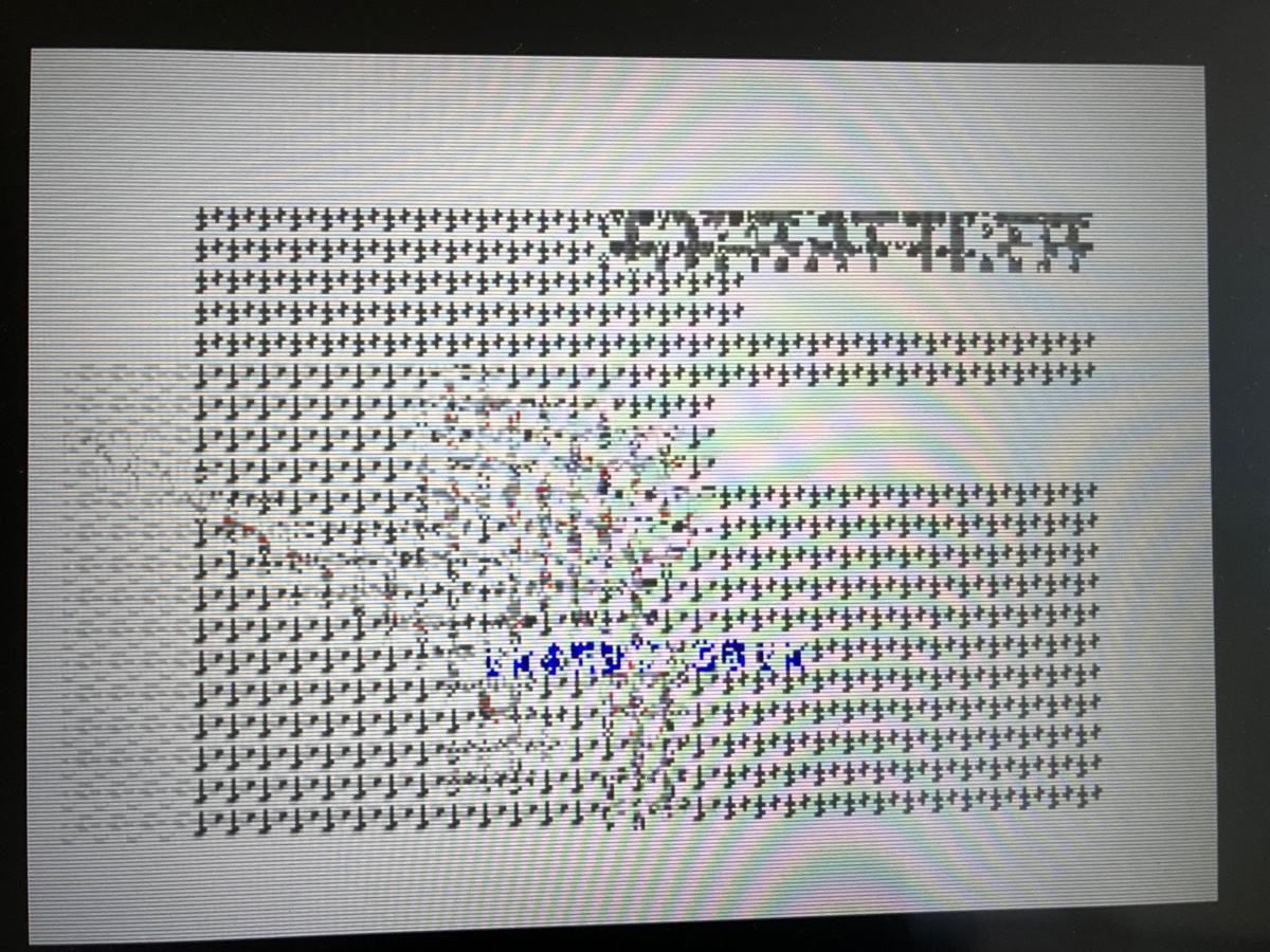

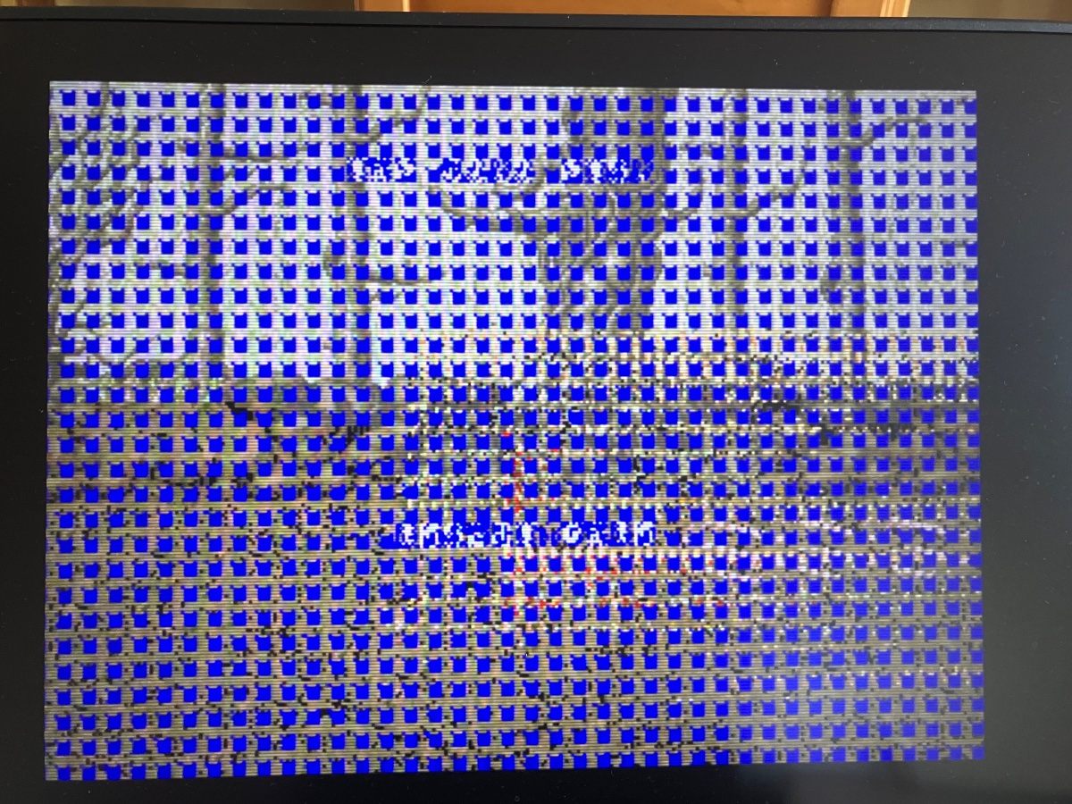

Thanks to your nice video, I have removed 8751 chip !
I have now an image on the screen but It’s totally glitched.
Is this possibly due to the motherboard ?
Anyway thank you for your help.
Your motherboard, 68000 CPU and Z80 CPU all look correct to me.
Pull EPROMs 1, 2 and 3 from the Multi board and verify them again in your programmer. Also make sure you didn't get EPROMs 6 and 9 mixed up.
I have rechecked all the EPROMs (the 6th was bad and I reburned/verified It) and I’m still having a glitchy image for each game I select :(

Hmm... strange. We'd have to check the contact of each ROM chip with its socket on the multi-board. I'd also check the condition of the pins on the four connectors between the multi-board and the System 16 motherboard. Is the multi-board oriented correctly (see minute 5:00 of my video).
Are all the DIP switches on the motherboard set to OFF?

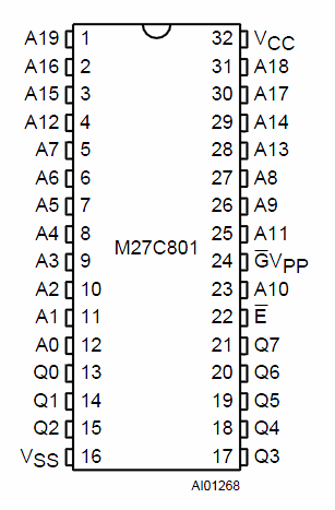

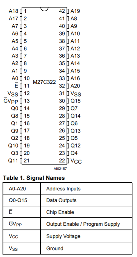

In my opinion, it's a loose connection in one of the ROMs on the multi-board. Do you have a logic probe or oscilloscope? I would check for data flow on the Data Outputs pins of ROMs 27C322 and 27C801 (Q0-Q15 for 27C322, and Q0-Q7 for 27C801). If either of these pins shows a sustained "1" (5V) or a sustained "0" (0V), instead of alternating 1s and 0s, you've located the fault. This test must, of course, be performed with the board powered on. This way, you'll accomplish two things at once: checking the status of the sockets and determining if there are any remaining faulty graphics ROMs.
