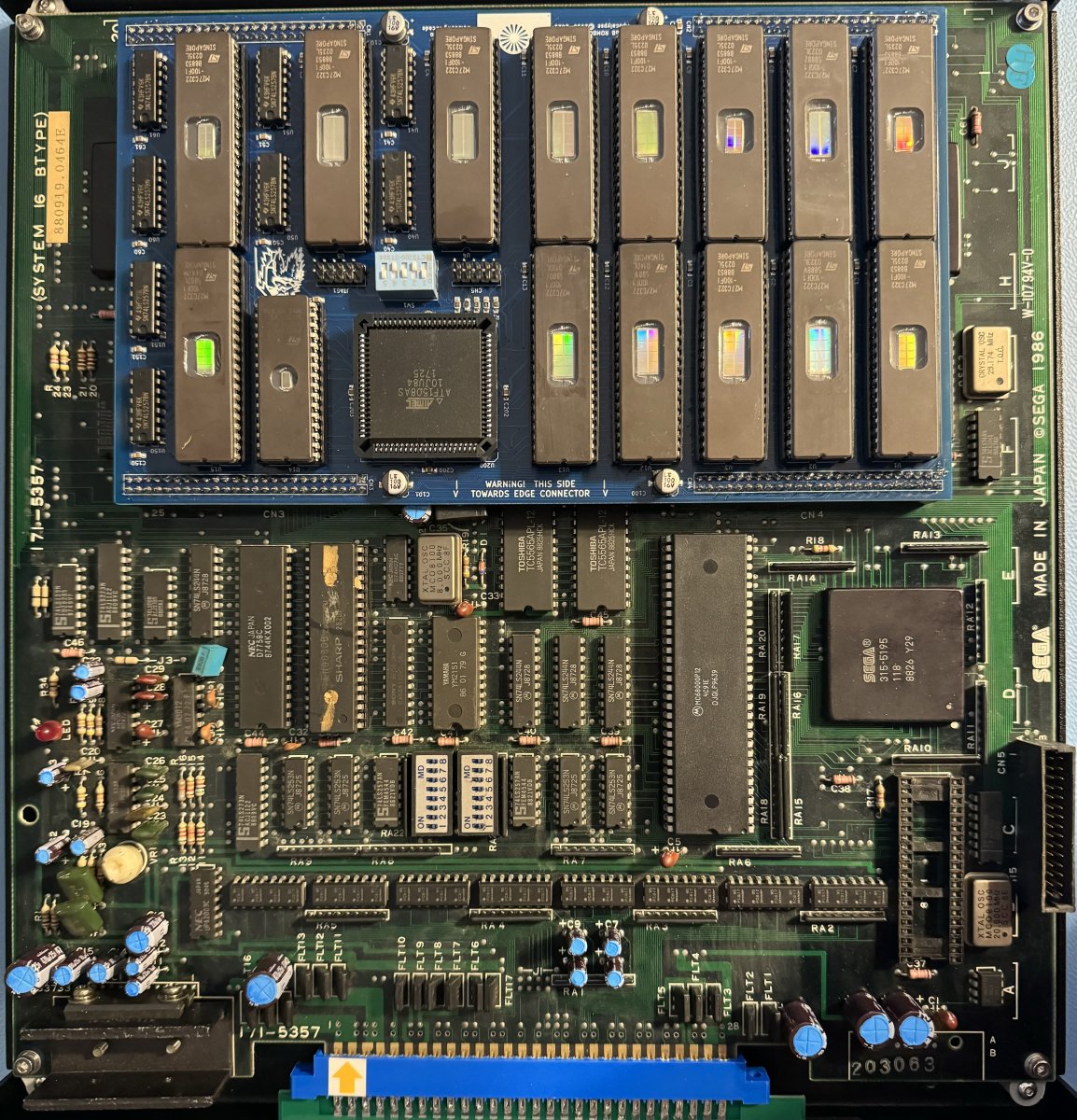

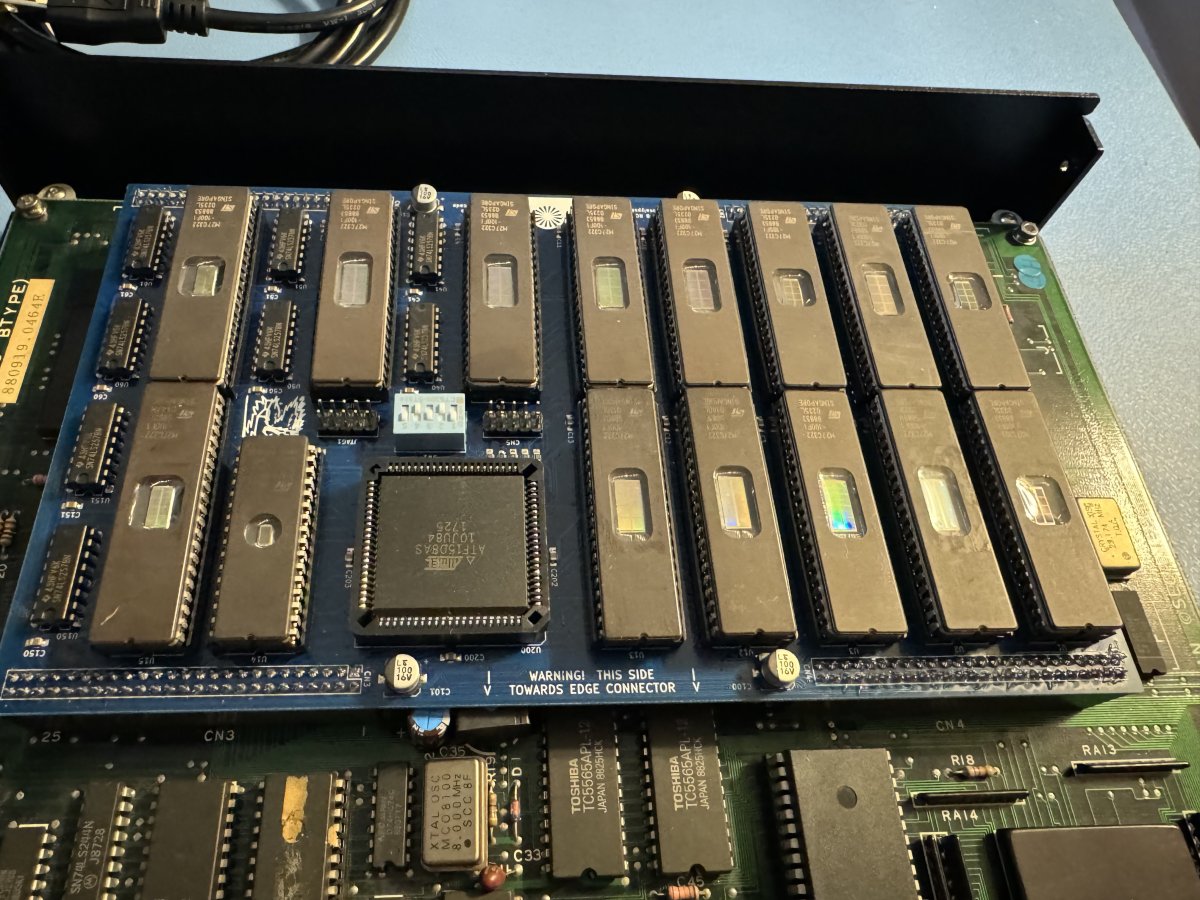

Can we see a pic of your install?
I tried removing and reinstalling the multi a couple times, same behavior. I’ll try reburning rom 1-3 one at a time next unless you notice something I missed here
Just an update on my testing. I rewrote and verified ROM 1-3 and 14, no change. I pulled a few others and they verified just fine as well. I got tired and ordered a full preprogrammed set from buyicnow using the same rollup pack images. I verified each then swapped those in today and I get the same issue.
I did notice that I used a 68000 P12, would that potentially cause any issues -- I figured it would be underclocked and work fine but I figured I should mention it?
Otherwise i'll pull the multi and check for any cold solder joints, etc. If you have anything else i should check out please let me know. I have all the DIPS on the donor mainboard set to OFF as well -- originally they had DIP5 on for each of the DIP switch sets --that didn't seem to make any difference either.

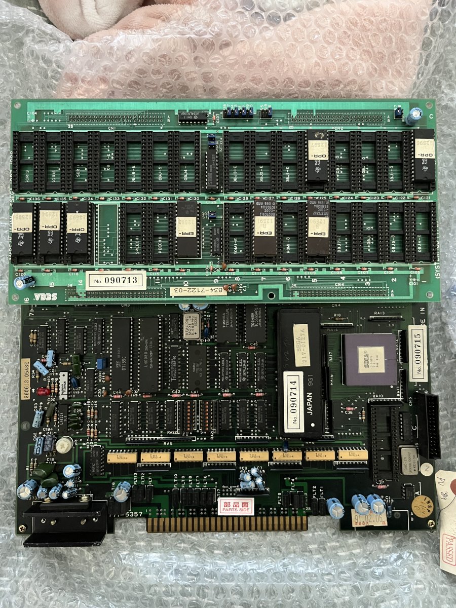

I picked up this Sega 16B board as a donor… not sure if I need to look at swapping CPUs? (I can see it mentioned in here that some boards need a CPU swap)
Thanks
Yeah you would need to replace that big black box chip with a standard 68k chip.
@DRAGONKZ … yes sir , you should replace it with an mc68000p-10 👍🏻
