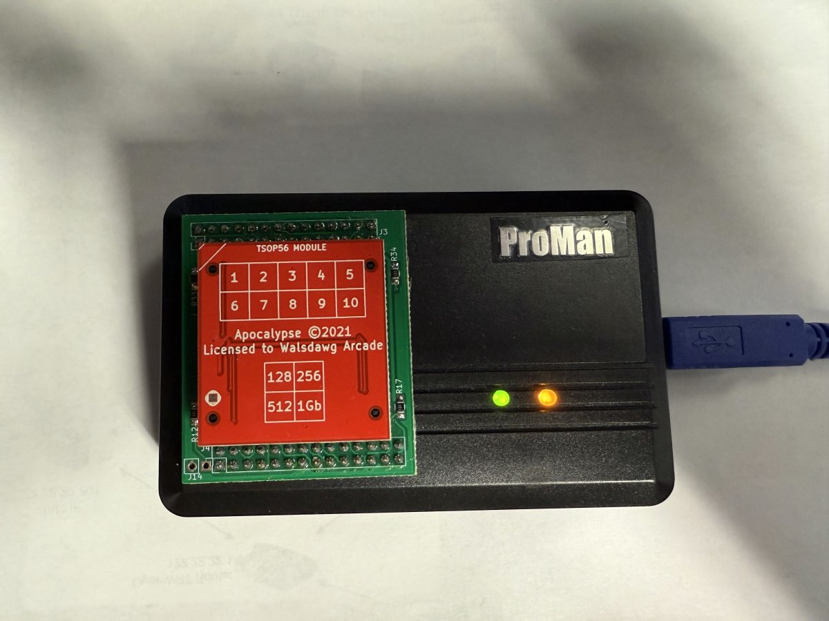

for completeness: I downloaded the same software for the proman from the CPS3 instruction pdf from this post and ran the NOR06x_beta_x.exe (063 and beta_D) as of this post.
the orientation for the adapter and module for my setup is different from the earlier post.
