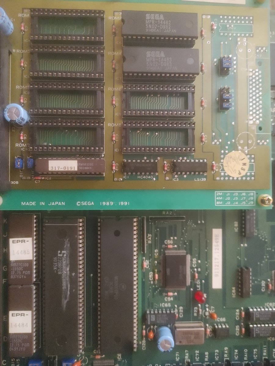

Here's what the pcb looks like before I mess with it, plays as is.
Submit to mame just the two mask and 2 epr?
Yes please, though labels/markings match what's already in MAME.

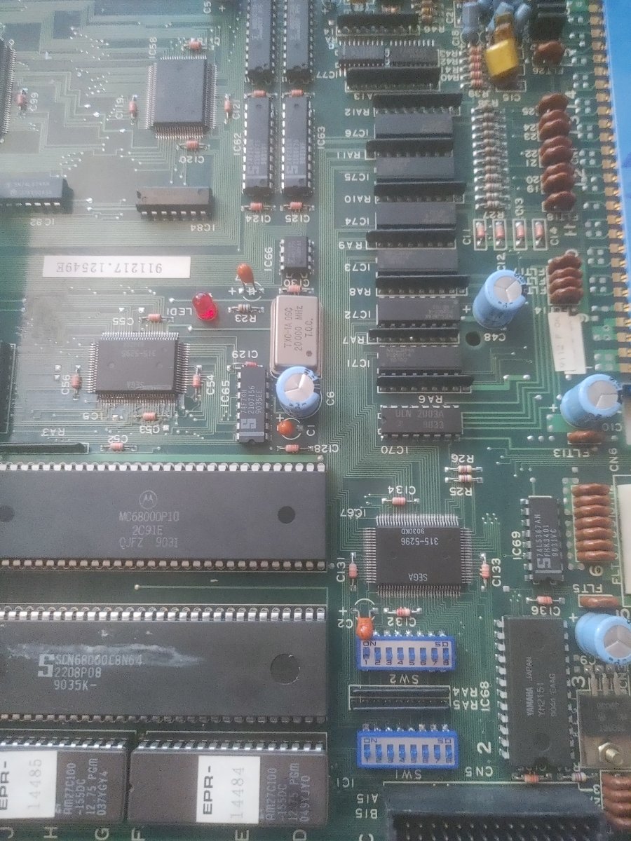

I dug a bit into MAME's sources and found there was a dipswitch for 2P/4P mode, and by default (OFF) game is 4P:
PORT_MODIFY("DSW")
PORT_DIPNAME( 0x01, 0x00, "Play Mode" ) PORT_DIPLOCATION("SW2:1")
PORT_DIPSETTING( 0x01, "2 Player" )
PORT_DIPSETTING( 0x00, "4 Player" )
So maybe by setting SW2:1 to ON game would boot on the multi?
I will play with the dipswitch tonight to see if I can replicate the behavior.
So my board is being temperamental now (needs a recap) but I can confirm when it was booting in 2 player with no 3/4 player board jumper 1 was the only one set to on.
So it is worth trying setting the dip 1 to on if someone wishes to play this game.

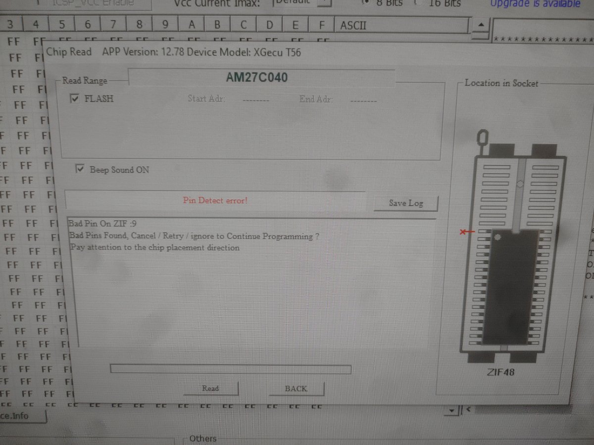

Okay. So dumped the chips.
Think I found my board fault. Pin 9 bad mask rom?
I was able to get them to dump as a 27c040 by ignoring the fault, nothing else worked and they match the mame source thru the verify function.
That's pin 9 with respect to the ZIF socket on your programmer. So it's pin 1 on your chip. On a regular 27C040 that's the VPP pin which requires around 12V for programming the EPROM. A mask rom wouldn't have any need for that so that pin either has some other function or it's NC. Either way, it's enough to confuse your programmer.
