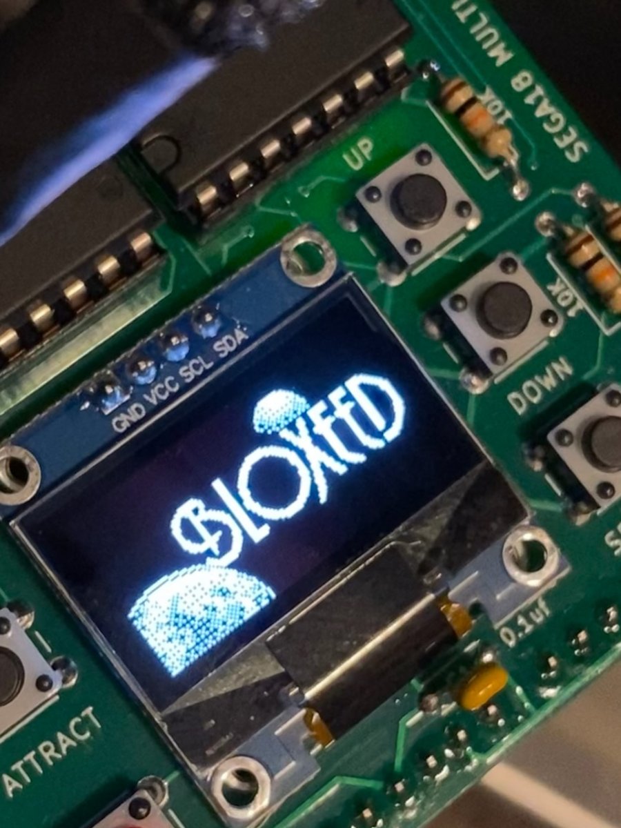

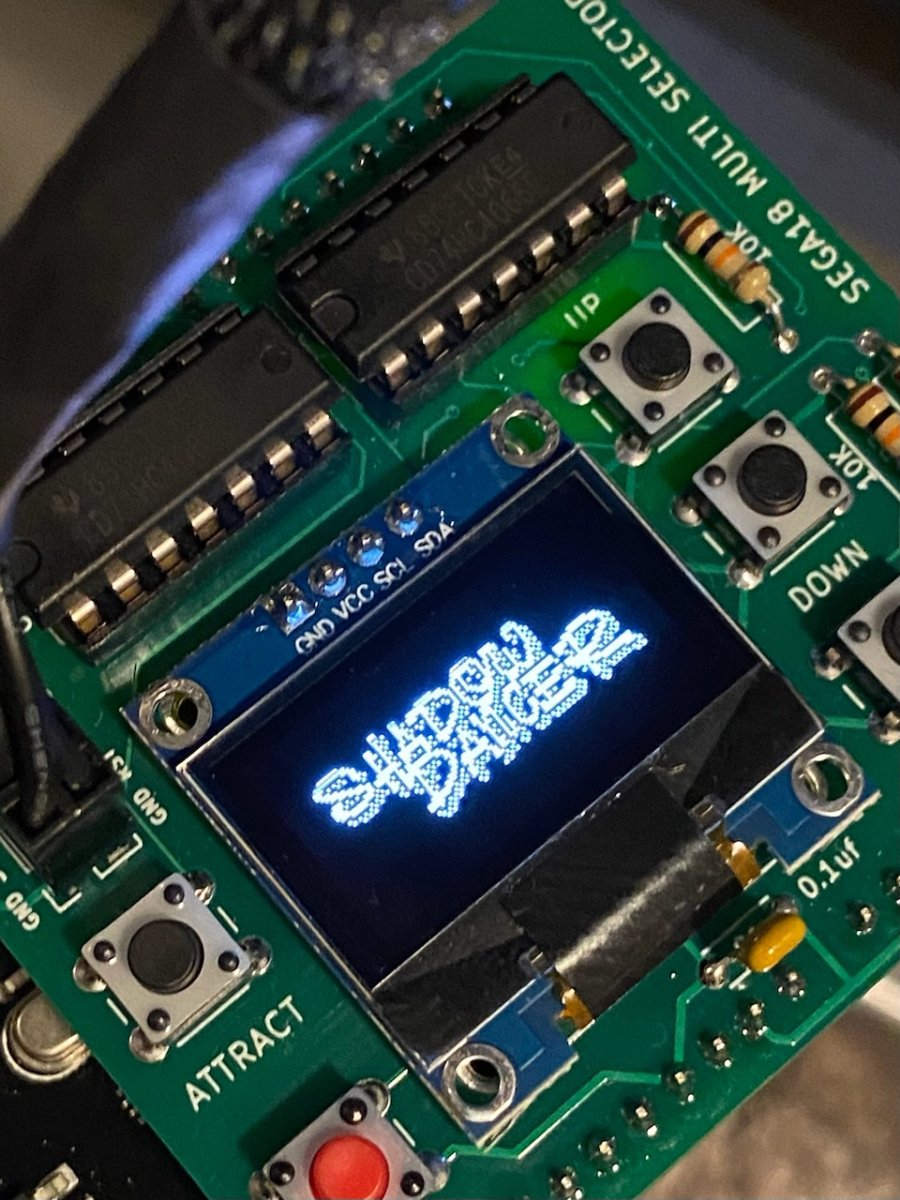

Sega18 OLED selector

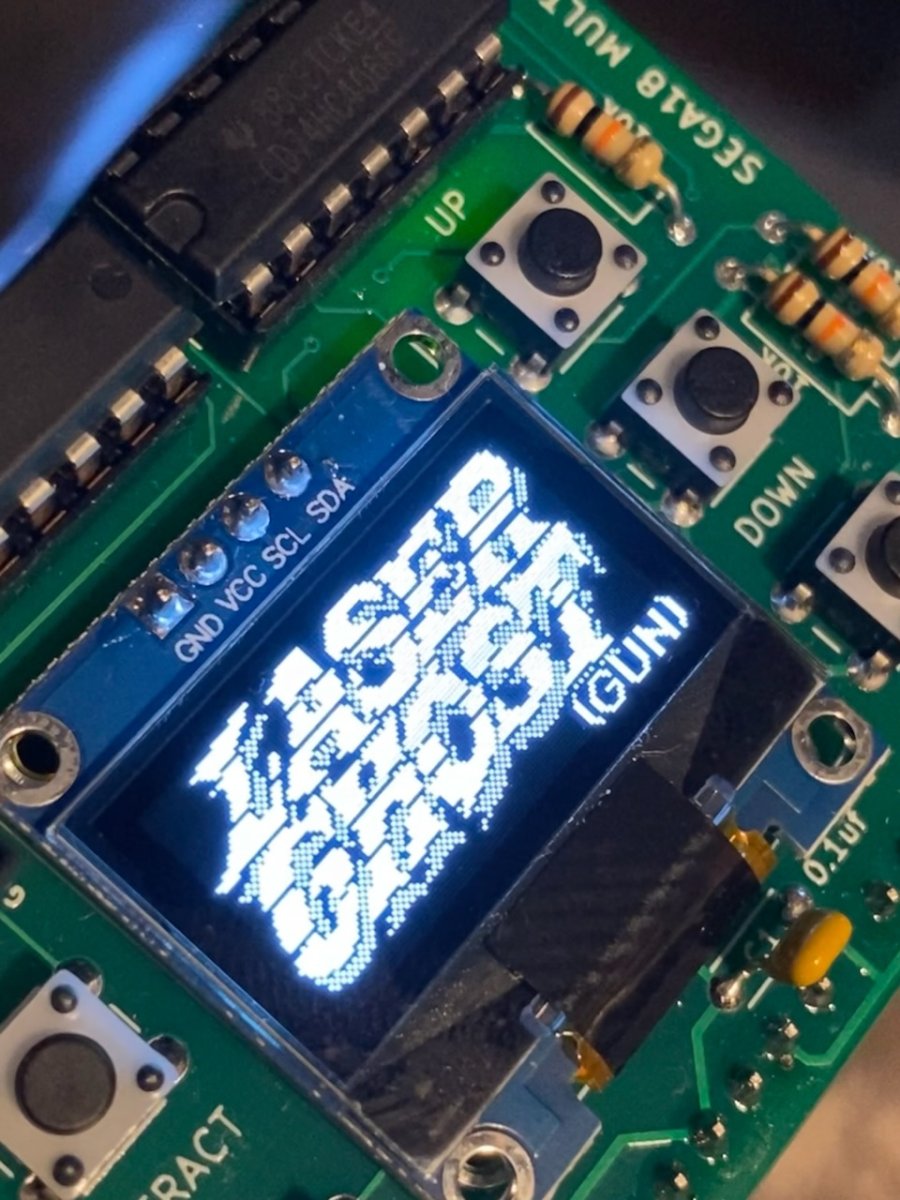

Any thought of adding the 4 duplicates and adding in the differences... eg: Alienstorm 2player vs Alienstorm 3player
DD Crew, Wheres Wally and Laser Ghost are duplicates as well
Could be easily done with maybe an indication at the bottom of the image. Like a 2P/3P symbol or text.
I’ll look into it.
@opt2not
We would different images for these:
Alienstorm (2-Player)
DD Crew(2 player)
Laser Ghost (Gun I/O required)
Where's Wally (Trackball)
Alienstorm (3 player)
DD Crew(3 player)
Laser Ghost (Joystick Hack)
Where's Wally (Joystick Hack)
I am not planning to sell them but I have provided everything needed to build them
Wonderful work you have done for us SEGA fans, too! Thank you so much.
It seems that the boards are not too expensive to get made at oshpark, and free worldwide postage. I will be making up all of yoyr boards for the S16, S18, ST-V and hopefully S32 eventually? I will also be in for an M92 and M84 when/if they happen.
@opt2not
DD Crew(2 player)
DD Crew(3 player)
Updated the zip file with the following icon changes/additions:
