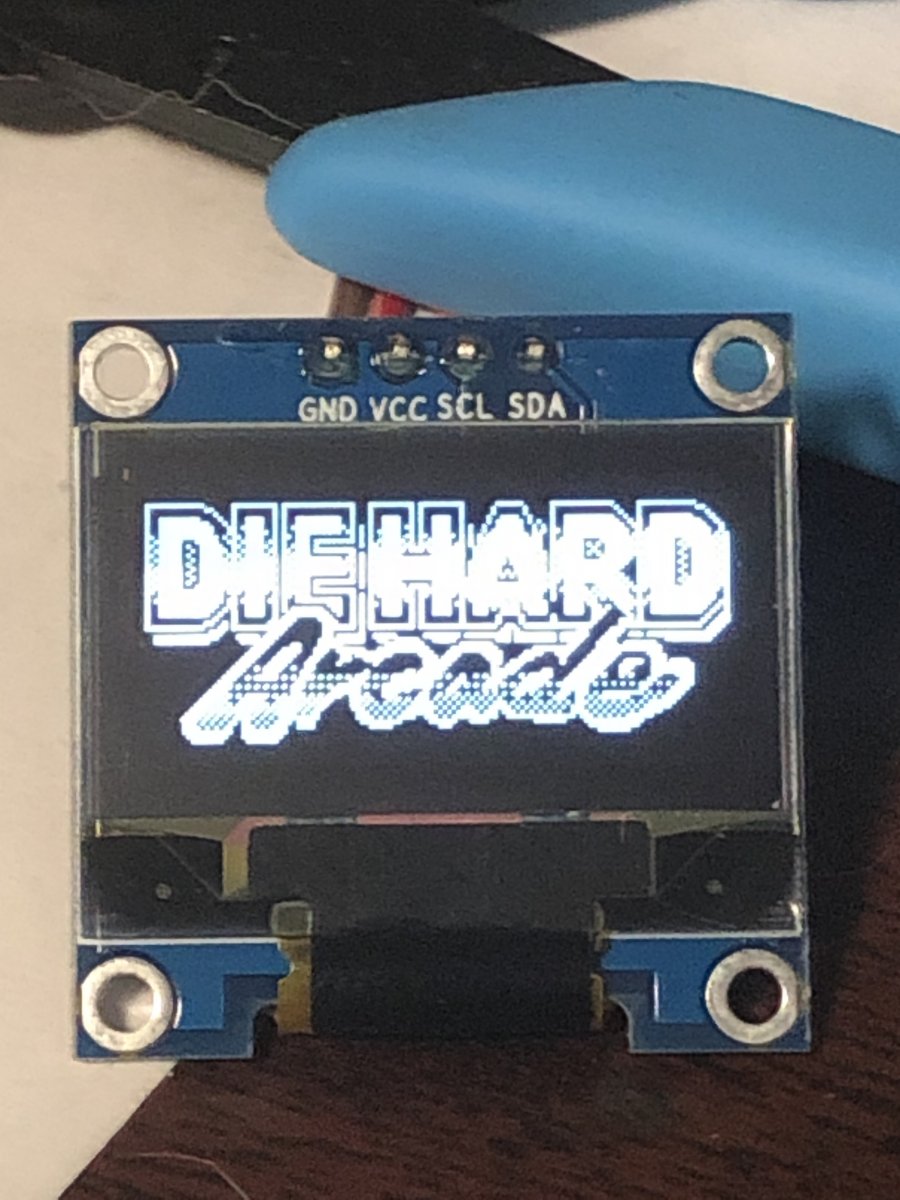

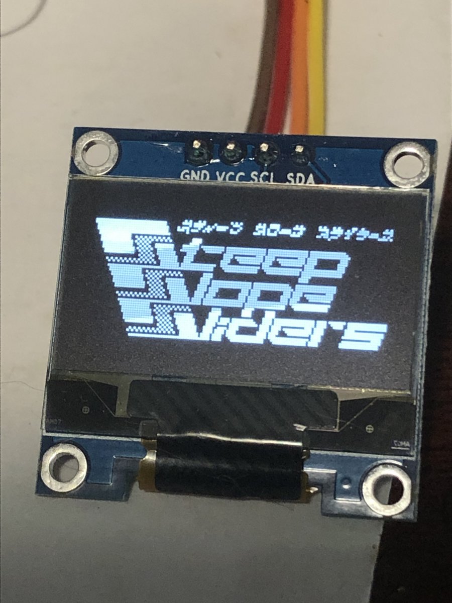

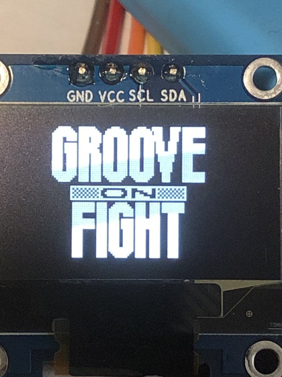

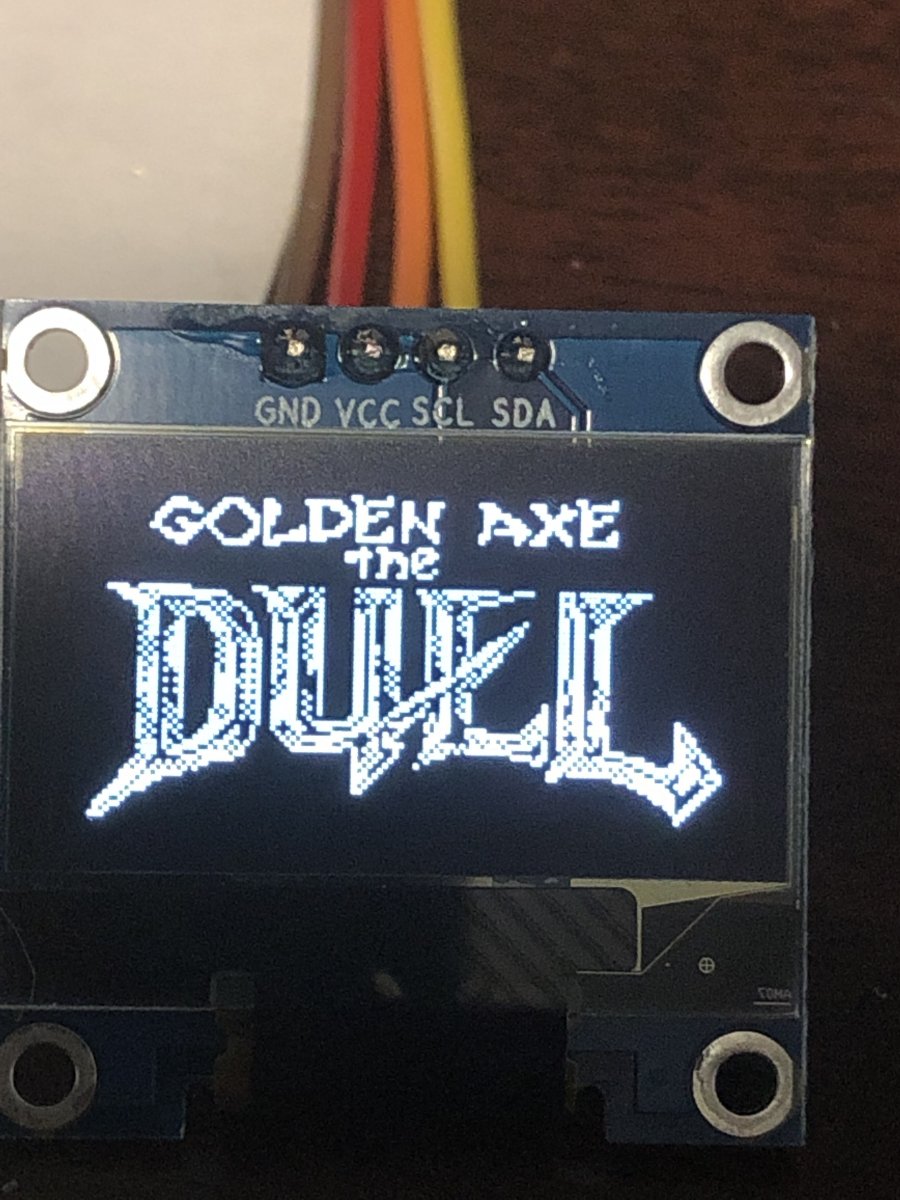

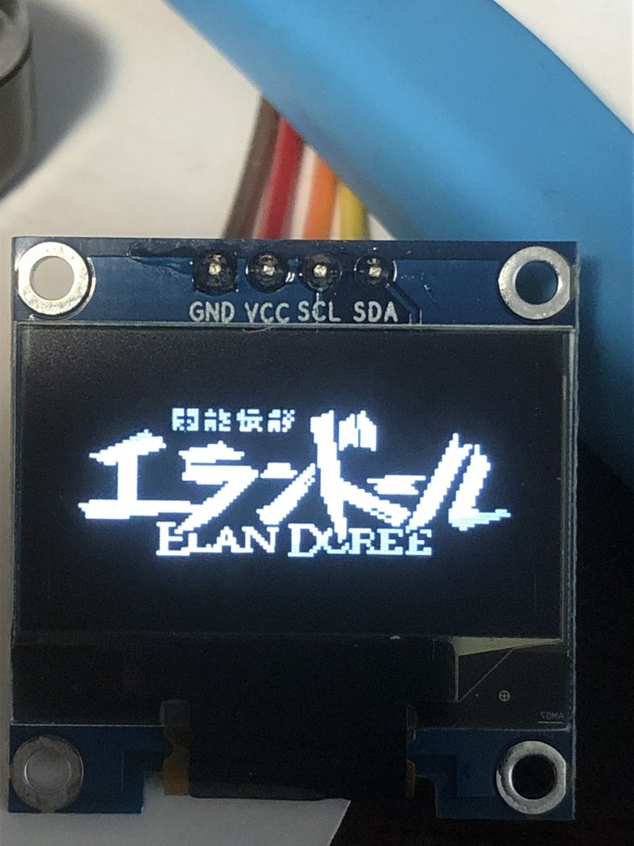

I cheated. I filled the background with a black and white sunburst gradient. Then I did an ordered dither 1-bit reduction on it which resulted in this:
Then made an outline for the text and just overlaid it.
