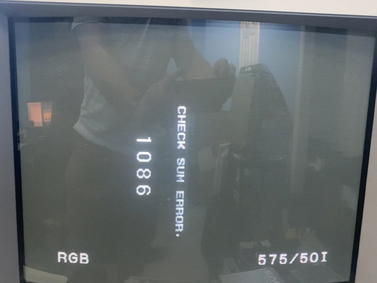

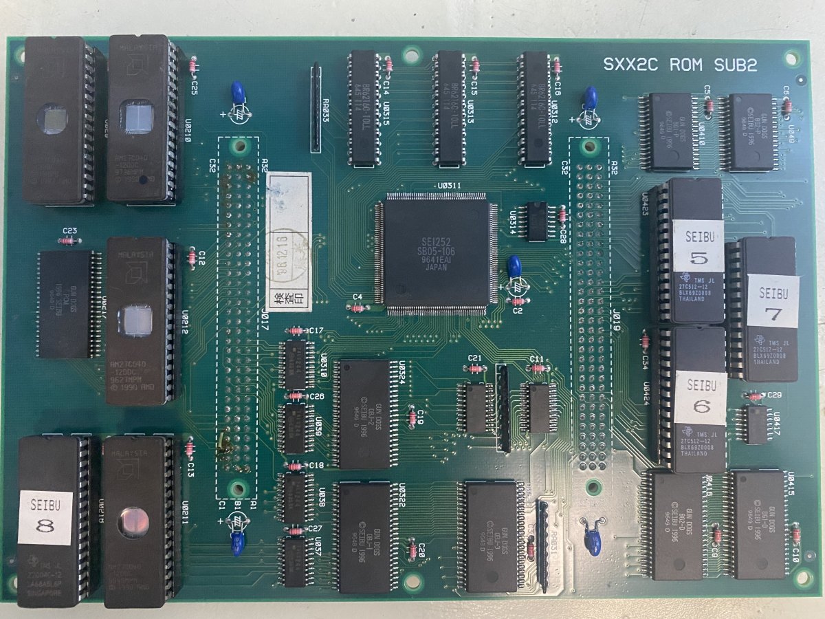

Does this fix this issue?
If this is a V2.0 board try flipping the jumper at JP072 and then power back on to see if it reloads the cart.I have a board that is now showing CHECKSUM after a battery swap.
I'll check this out and report my findings.It's not 100%, but it will likely work.
It doesn't. Tried with 2 carts.If this is a V2.0 board try flipping the jumper at JP072 and then power back on to see if it reloads the cart.
H buddy i have the same error did you patch your cart files or a mame files?

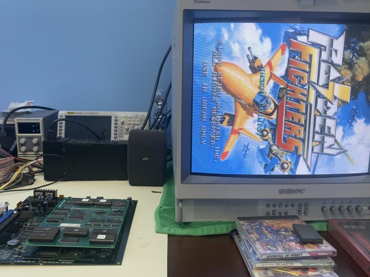

Can you share those files? I patched the mame files burn them but the error persistI patched the MAME files since that was easier and faster than dumping all the ROMs from my cart.
