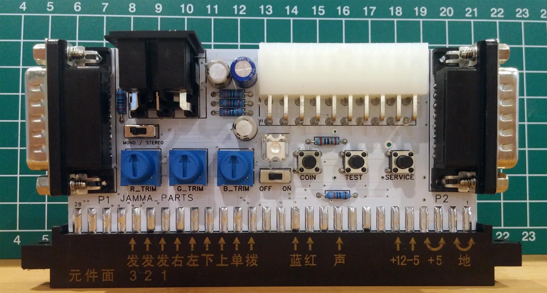

I did want to ask if there wasn't a better location to place the DB15 connectors instead? Like at together side by side on the long edge?
That's a good point and something I've considered. Perhaps a version 2 candidate which I'll elaborate on further down. For now things are laid out according to PCB design considerations. Power is situated close to the source, video and audio lines are well separated and insulted via a large ground plane and so on. Also size of the PCB has been kept minimal to keep costs down. Sometimes there's a trade off between what's best physically and what's best electronically, if that makes sense.
I'm actually toying around with another design concept in the background. I'm developing it so that everything barring controller inputs is on the main PCB. By everything, I mean all power, audio and video outputs (including RGB, s-video and composite). The controller inputs will be a completely separate PCB that docks on top. This will allow for let's say Neo-Geo and Mega Drive controller inputs on the one board. I can add rapid-fire and kick harness support. I can develop different controller boards for say Snes or Saturn or perhaps 4 player output and the end user can simply swap boards out pending on which controller scheme they would like to utilise.
Here's where it all begun, if anyone is interested. These are pictures of the very first prototypes I made. The one where I'm holding it in my hand is the very first one I ever produced and assembled. It's very crude and simple and obviously things have come a long way since, but it works and is extremely compact at 112mm x 50mm and it all had to start somewhere.
No worries, I would be down for a second revision if this can be done. For fighters and stuff, connecting USB cables from the side may be a bit difficult. I would say that things like power, sound,. video ect are placed to the sides as they are not constantly plugged in and out and are out of the way. I am also not sure on the 3 buttons' placement but cant offer any suggestions off the top of my head right now.
