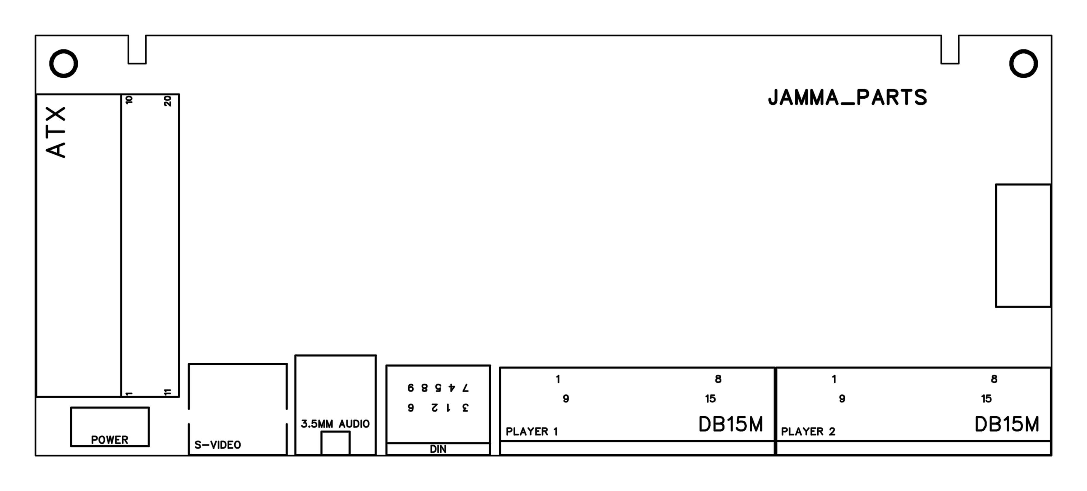

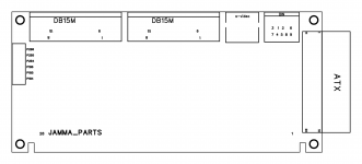

Just an idea... How do people feel about this layout?
ATX power on the right, angled kick harness connector on the left and 2 x Neo controller ports, Mega-Drive/Genesis 2 DIN and s-video DIN on the rear edge.
No separate video board for composite video and s-video, it will all be contained on the main PCB.
Composite video to be available from the Mega-Drive 2 DIN via standard Sega 5 pin AV cable or via scart cable wired as composite video as sync. This also means I can include a switch so one can choose sync straight from the arcade game or the regenerated sync from the RGB to composite conversion. The generated composite video will be cleaned and that stripped signal can be selected for sync.
Would need to add audio RCA breakouts for the s-video or perhaps even better, a 3.5mm headphone style jack.
I think that looks better too. I did want to ask, why the need for composite? Isn't it better to run anything above that for output?
Thinking about the buttons for coin and test etc, the closer to an edge they can be the better for easy access to them with your fingers. Although is there no way to make it a button combo for test? Ie start, select, 3 kick buttons or coin from the joystick buttons such as select/options from an external USB stick?
Regarding composite, I guess it's just nice to have options available for people without access to RGB monitors. I'd like to keep it as well as s-video as s-video looks gorgeous, just a pity it's not a common format. Their presence doesn't impact on RGB output, it may even be advantageous to have a generated composite video signal as this presents another option for sync. I may consider ditching s-video to reduce parts and save space, plus I won't have to deal with separate audio outputs, but the image is exceptionally good so I kind of want to retain it. I could always utilise the existing Mega Drive 2 DIN for audio output to be used when utilising an s-video output. E.g. just use a Mega Drive RCA AV cable to extract audio when using an s-video cable. If I redesign the main PCB to incorporate the composite / s-video components then costs are reduced as I don't need to pay for a separate video hat PCB. If people don't want anything other than RGB they have the option of saving money as I simply won't populate the PCB with the components required for composite / s-video. I could even use the Sony CXA2075 which is being used for the RGBS to composite / s-video conversion as an RGB video buffer negating the need for a separate RGB amp such as the THS7316.
A lot to digest but I think I may be on to something.
Regarding inputs, what you're proposing would required a microcontroller of some form to interpret and output those button combos accordingly, as well as a rewire as TEST and SERVICE aren't connected to the controller ports. It's possible to incorporate but possibly more hassle than it's worth. It's not really an issue as START and COIN are available from the controllers and the only other main button that is used it TEST. I've never had a problem accessing these buttons from the supergun PCB.

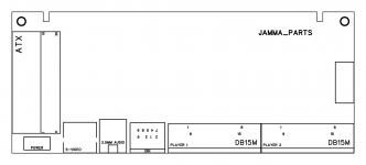

So... Here's what I'm currently thinking for a revised layout.
RGB and composite video available from mini 9 DIN.
Separate s-video connector.
3.5mm audio jack as an additional audio output. Mainly there to cater to audio when utilising s-video. Switched connector so when a cable is inserted it cuts the audio to the DIN.
Power switch bottom left and kick harness connector middle right edge.
I think it would work well. Thoughts?
The access to the test button shouldn't posse any access issues but, some hacked roms do freeze and need a reset or to enter into the test menu to reset.
Also I see that at game meetups you would definitely need an extension harness as I think people pressing on the test button can flex the jamma connector placing stress on it.
If you can consider adding this feature that would be great.
