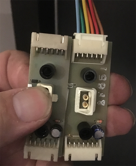

Well, two pictures attached. The one with Spare written on it was actually from the Time Crisis 4 corner, the other one is a frame I picked up that we had in storage, it mentions HOD in the name and have seen them online for sale, however we do have a House of the Dead 2 and 3, but HOD3 is in storage somewhere and might actually be for that.
If you look carefully, you will nice one module is fractionally smaller, the light layout is the same (should have moved my thumb), but the screw pitch might be out too and I cannot get the original plug in as its all different, how anoyying!
I have a feeling that the guy who attached the plug to the 'out' and not 'in' fried it, do you think I am right? test's so far indicate that the entire 10 models on the left hand player are fried and I am getting 11.5 volts at the pins.

The wider module is original OMZ equipment that Namco used, the thinner one is the Sega Version.
Namco bought off-the-shelf version of the equipment while Sega had them modify it slightly.
I see this all the time in manufacturing, a customer will say I want THIS part in your catalog but I want you to put my part number on it and change the dimensions ever so slightly.
functionally they should be cross compatible.
Konami used the off-the-shelf version in World Combat and Lethal Enforcers 3. The gun cpu board in a Lost World Jurassic Park and World Combat look identical except for the Sega rebrand. Taito also used this equipment in games like Music GunGun and Gunslinger Stratos. I predict they used the off-the-shelf version too.

quick update: I got the SEGA sensors (well half) working this morning, the IN connector is still same size as the regular size connector, so I could plug them in anyway.
It made me more hopeful in getting it working fully.
update.. had one sensor wrong-way-round and corrected it on the Sega array, tested it on HOD2 and it worked and then tested it on TC4 and both guns 'did something sensible' as i had it 90degrees for wiring reasons.
So, its the little sensors !
