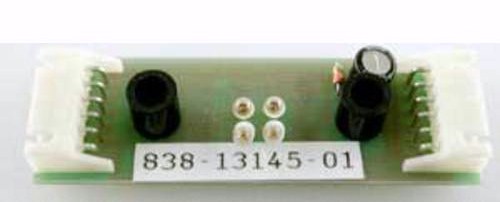

So The issues I was having with the Gun tracking is really just the guns having trouble seeing the IR LEDs... if you're too far from the screen then they aren't bright enough and you get a "Screen out" even if the gun is pointed right at the screen. If you're too close then the distance between the LEDs is too much that they're no longer in the gun's field of view and you get a "Screen out". As it was about 5ft from the screen was a "Sweet spot where the guns would track, but even just pointing it towards the edges of the screen put it out of range of the other edges and made the whole thing unplayable.
I tried both the Vertical Jurassic Park Style led modules and the horizontal HOTD2 style led modules and there was no real difference. I contacted Ken @ irepairsega to see if there was as way to increase the sensitivity in the gun sensors and if he knew the LED specs so I could maybe swap to some brighter ones. This led me to some interesting discoveries.
1. There is no way to increase the sensitivity, the only way to increase range is to increase the output of the LEDs.
2. Ken worked with another person who built a projector based setup exactly like what I'm doing and they used the 4-LED modules found in some of the Deluxe cabinets and had good tracking up to 12ft.
3. the LEDs in these units are specially designed for the company that made the tracking equipment (OMZ). they operate at a non-standard wave length so they wont work with "normal" IR LEDs. Apparently Keven even found the LED manufacturer at one point and ordered every catalog led they made in the same spectrum range but couldn't find a working replacement. So the only option is to use the original LEDs.
So My best option is to find a set of those 4-LED modules PCBs.

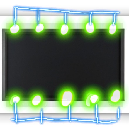

How important is the placement on the sensors around the monitor?
Building my own monitor case for 50" screen.
you'll want them evenly spaced but it doesn't have to be super precise.
basically put the corner LEDs in the corners (they should be beyond the edge of the screen)
put the middle LEDs in the middle,
then the remaining ones just go half way between the corners and the middle.
my initial tests I just taped them to a piece of cardboard and eye-balled the spacing and it worked fine.
on the real cabinets the corners are rotated 45deg and this is mostly sothe angle of the LED points more towards the center of the screen. they'll work without doing this but, I recommend it if you can as it DOES increase the gun's visibility of the LEDs.
it's hard to find a good picture of this, but you can see how they're arranged here:
then the remaining ones just go half way between the corners and the middle.....

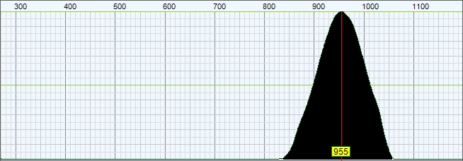

The Light Spectrometer I purchased came in today. I used the awesome free Theremino Spectrometer software: https://www.theremino.com/en/downloads/automation
after pointing it at every light source in my office to see what it spit out, I hooked up one of the IR LED modules to a power source and got this:
the peak seems to fluctuate between 955nm and 958nm but it's got a fairly wide spectrum with the tail reaching as low as 850nm and as high as 1050nm (which seems to confirm the 950ish peak).
So now to find some super bright LEDs in this spectrum :D
