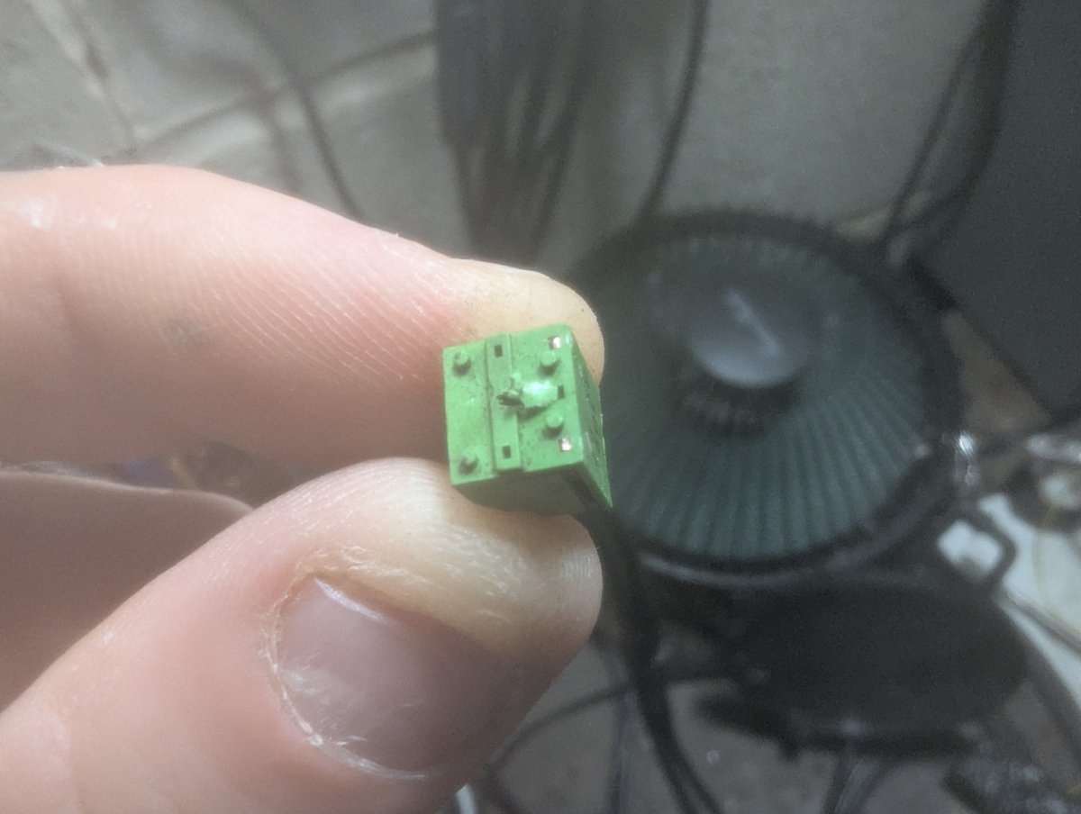

Edit: Yeah, the adjuatment knob for 5v fell right off. Thanks for confirming what's going on! Can easily solder it back on .
Yeah, the piece broke off. Is there a good place to get a replacement part ? It looks like this would be difficult to through-hole resolder. Let me know if I'm wrong tho too please!
