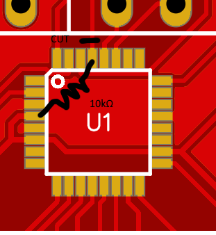

That's an interesting problem. Does anyone know if pin 9 is electrically connected to anything in an AES? The first thing that comes to mind based on the behavior you are describing is that the microcontroller is being held in RESET when you have it in MVS mode.
There should be a pullup on the RESET pin (as close to the reset pin as possible). Cut its trace so that it doesn't go to the DB15 plug anymore and connect it to VCC via a 10K resistor.

I found some 10k resistors. Will attempt this surgery "ASAP".... which might be tonight or this weekend.
Getting the SNES port out is going to be a PITA, the holes could be a little wider on the next revision to fit these (measured like #17 AWG, ~1.15mm).
Soldering directly to the IC leg might be tricky and it will be complicated to re-program the AVR in the future. Perhaps cut the trace near the R1 area, peel the soldermask and solder the resistor.
The microcontroller has an internal pull-up resistor on RESET, so adding the 10k pull-up resistor should not be strictly required, however cutting the trace for reset will definitely confirm if reset is the problem.
This worked! I cut the trace near the SNES connector, was pretty easy to access if anyone else has this issue. Torn on adding the external resistor.
