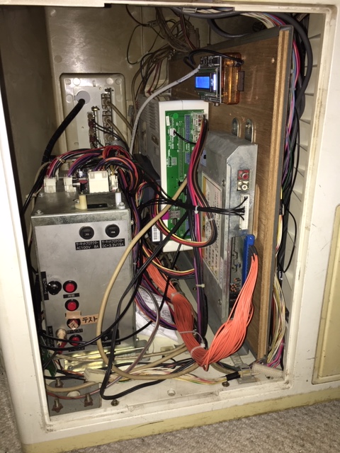

Nice one :thumbsup:
I've been making do with a Naomi --> Capcom I/O --> Konami JAMMA adaptor --> Konami I/O for the controls, which was less than ideal and a lot of a mess!
I look forward to giving some other games a go this evening
Worked like a charm, although for some reason, it was Dip Switch 4 on my I/O that needed to be set. The important thing is that whatever dip switch it is, the menu shows COIN as being 2 SLOT:
