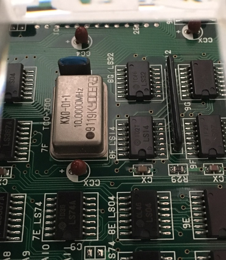

seperate the boards and look at the crystals of the A board (square silver thingies), one of them should say 10.000Mhz or 12.000 MHz

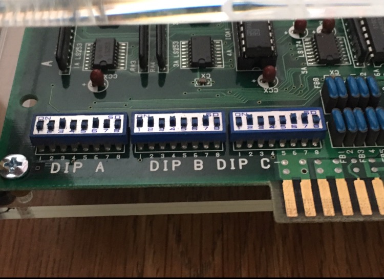

Most 12MHz boards also have a sticker near the Jamma edge 'CPS Dash'
Here you can see the CPS Dash sticker next to the B Dips;
should be a little sticker above the dips that says "dash" otherwise you can take the b board off and see if it's a 10 or 12 MHz crystal on the a board.
It would appear that I have a 10 meaning the boards were mismatched when I bought them. Hyper Fighting still worked though, I would have thought that it wouldn't.

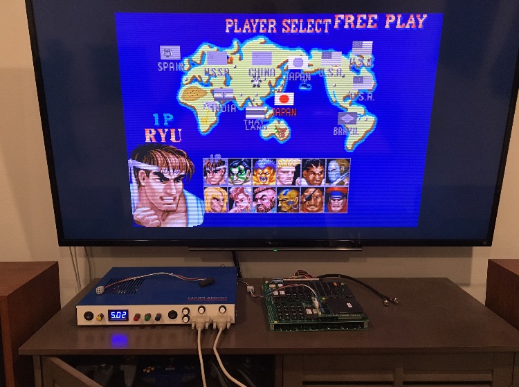

In one picture you can see there is no dash sticker, and in the other the center crystal says 10.0000MHz. The third picture shows Hyper Fighting working on this A board on my old setup (roughly a year and a half ago).
Always kind of thought the game wasn't very "Hyper", I guess I know why now.
