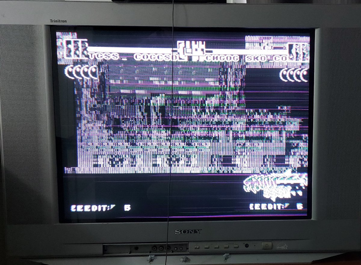

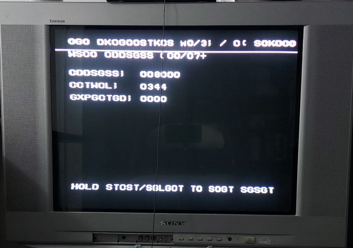

hi guys, I attempted to socket one of my AES's and ripped some pads in the process.
Anyways I believe I have achieved all bottom Patch wires. Unfortunately I get the pics below
Should I be looking and probing at the top side as well ?. I have another AES that I can refer to during the process.

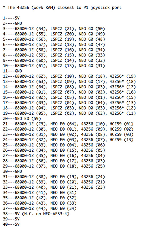

Be mindful that some traces might not be point to point going to the bios, but instead connect up to a bios pin and continue on to some 3rd chip. The pictures give the impression there is something wrong with at least data line 1 going to the LSCP2-A2 chip. I would compare continuity of the data lines between bios chip and LSCP2-A2 on your 2 boards. I think at a minimum pin 18 on the bios chip won't have continuity on your bad board.
