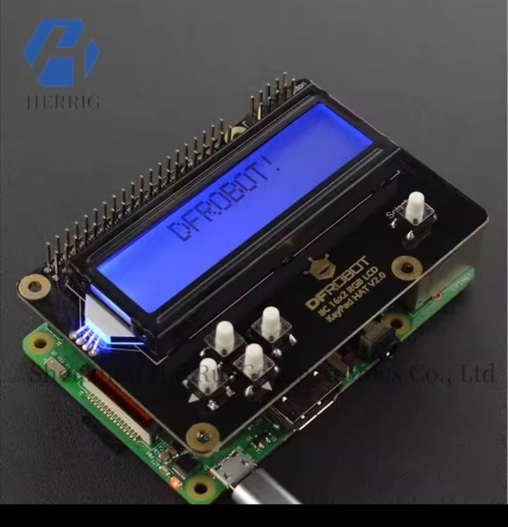

Hello, I recently acquired a Naomi system and have successfully set up netbooting using a PC; now, I’d like to do the same using PiForceTools. Instead of buying a pre-configured Raspberry Pi kit (which includes a screen and memory card), I purchased a Raspberry Pi 3B separately. I couldn't find the Adafruit screen—it appears to be out of stock—so I bought the "I2C 16x2 RGB LCD KeyPad HAT with RGB Backlight V2.0" from DFRobot (link: https://www.dfrobot.com/product-188...0z2OIRytyf3zzXYSue-dBe8KOekLFvtTbO_r1Wtu9XVlw). I’ve already flashed the PiForceTools 1.5 image onto a 32GB microSD card, moved the ext4 partition to the end of the storage space, added games in .bin format to the "roms" folder, and included the `rgb1602.py` library. However, the screen remains blank—it doesn't light up, nor does it display any information. I’m a complete beginner at this; do I need to edit any settings, or do I need to compile a specific image to support this particular screen? Has anyone else tried using this screen? Thanks!

It’s all sorted out now. Since I couldn’t find a solution anywhere, I took it upon myself to figure out how it worked—I was completely lost in the world of Raspberry Pi! I ended up modifying the files located in the `piforcetools` folder. Here’s a video showing the result:
I added a transfer progress bar and a percentage indicator for when a game is being sent, changed the welcome message, added a right-to-left scrolling effect for game titles that are too long, and included a "Now Running" indicator for the current game. Also, if there’s no activity on the screen for 10 seconds, the "Now Running" message triggers again. Take a look at the video—what do you think? If you like it and are interested, I can upload the files; perhaps an administrator could move this to a new thread and close this one out.
