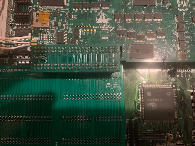

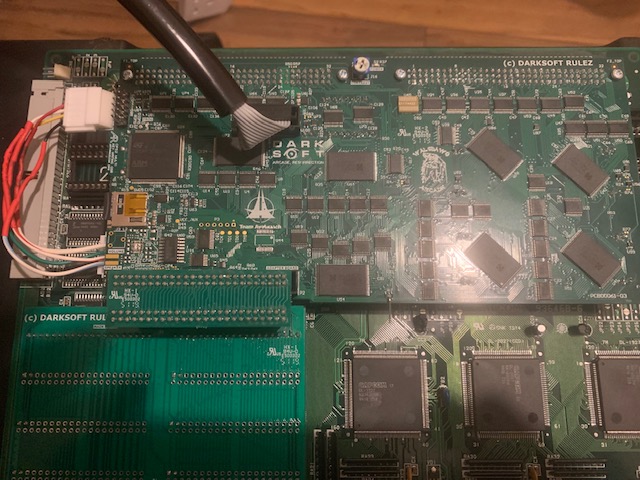

can you show a picture of you interconnect the 2 PCBs of the kit?
Hi, here are some pictures. I have also ran the 2 test programs and they dont report an error:

Are you sure that the tiny PCB joining the 2 PCBs of the kit is sitting properly on the side of the bigger PCB of the multi?
Can you show a picture from above of the smaller PCB of the kit, the one connecting to the Program Roms.
Hi, I think so. I have attached some pics:

If you are confident that it's sitting properly, try pushing a bit more, but very gently ;)
Can you show a picture of the area where the ARM processor and the key injection connector is?
