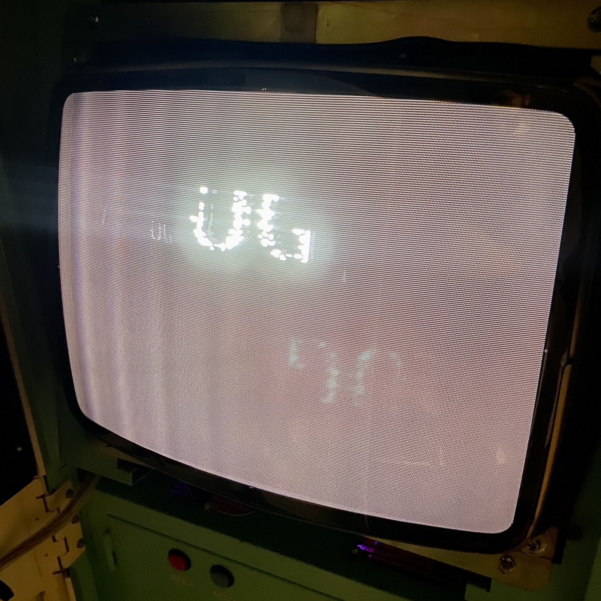

While waiting for the diagnostics BIOS, I decided to test more games. After about 20 minutes in attract mode, this is what I get with Metal Slug X. KOF96/98/2000/2002 all were fine.

curious if you have checked the voltage on the 5V rail while the board is powered on? I would check the board side to verify its at/near 5V. The Metal Slug X picture seems to point to issues beyond just sound cutting out.

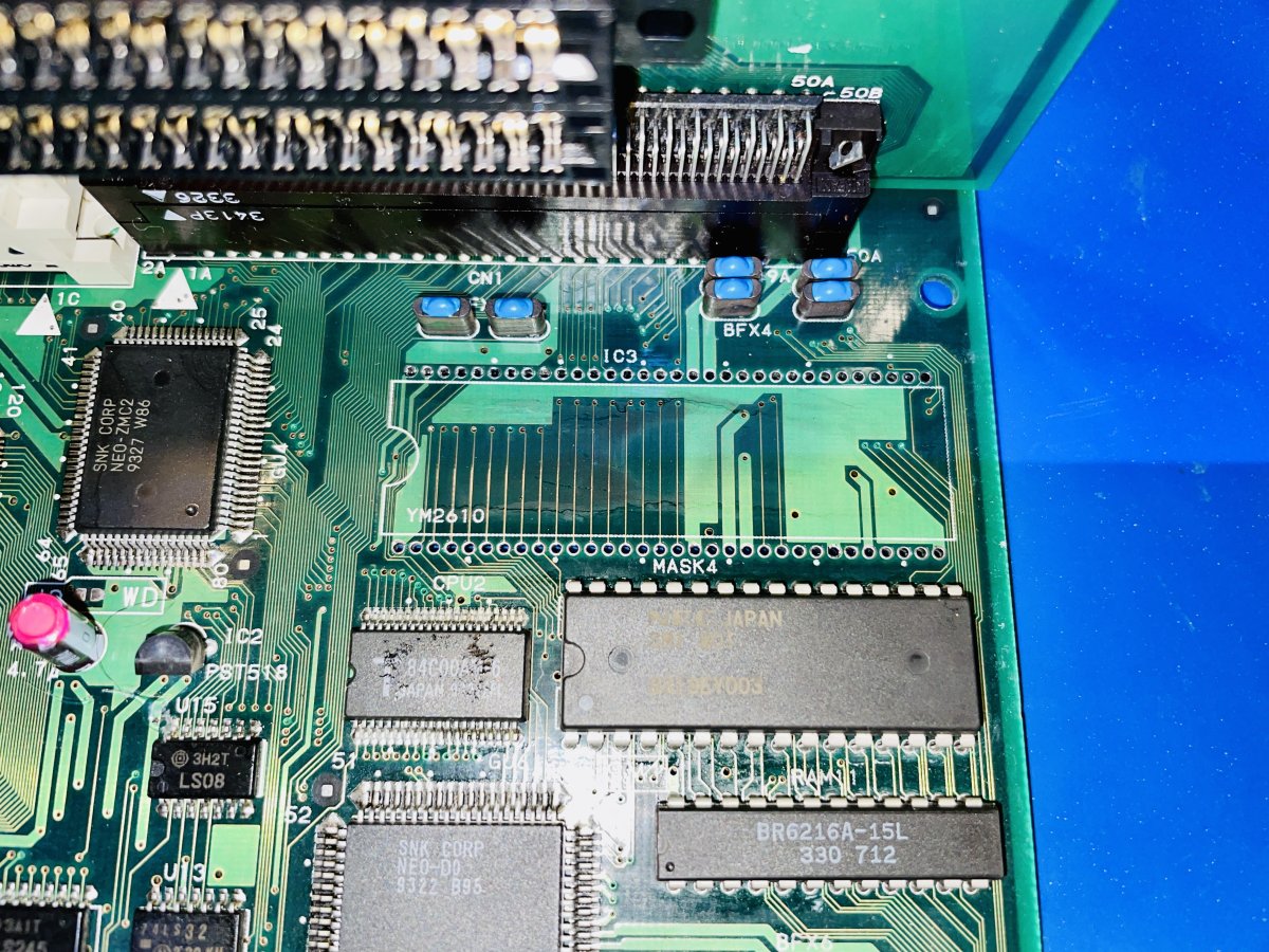

I pulled the YM2610 chip and soldered in a socket to prepare for a new chip and more testing. I’m going to spend the rest of my evening making sure I didn’t pull any traces but it looks good so far.
A buddy loaned me a MV1F one slot and the sound issues, of course, aren’t ARE present on his board, additionally, Metal Slug X glitched out after 15 minutes or so on the loaner MV1F as seen above. I double checked the voltage and that’s fine. I tested on a cabinet and supergun—same results. It’s possible that the ROM file I’m running on the multi cart is corrupted so I’m borrowing a known working Metal Slug X cart to do some more testing.
