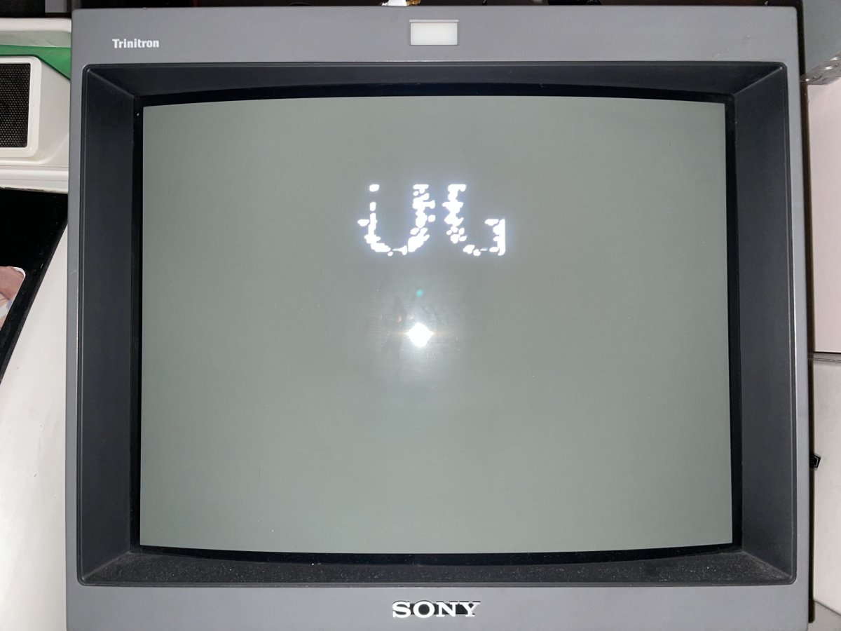

Also, can someone please test Metal Slug X? That game was glitching out there on me on US bios after 20 minutes or so of looping attract.

For what it's worth, I launched my 161-1 and selected MSX (NOT in picknmix mode), and after about 45mins I lost sound, then shortly after it gliched in the same way as kikaso.
Same setup as before, MV1A, 200ms Uni4, system set to US / Arcade.
