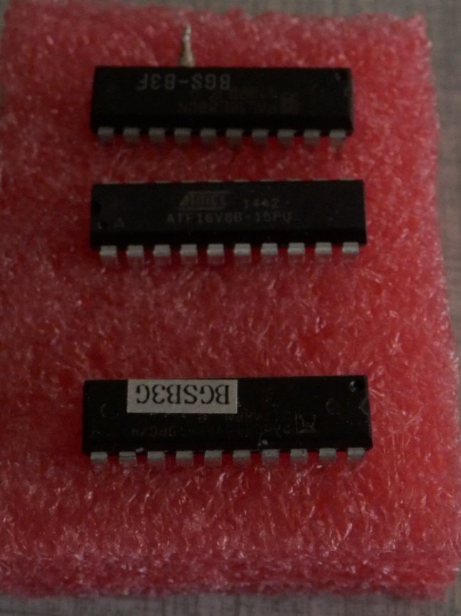

may I get help from you two experts? I'm a beginner of technical solvingIT's a regular PAL16V8 that needs to be programmed with the right content. If you can't do it yourself I'm sure Mitsurugi or myself can help you.

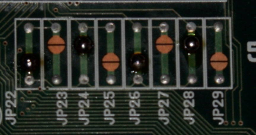

this looks to me like a jumper issue. Also please post a picture of your setup with the PAL installed. Did you lift the leg number 9?Hi all, thank you for support the sound issue here, today I got the PAL from Darksoft
I try to install to my board and try, I use the Rev 6 b board, after install the new chip the sound little bit better than before but still have issue, what I can try on next step ? Please advise

i try to left the leg 9, but even i try to connect witht the J17 or not, it still happen, also i try to reformat and copy the the game still happen.What I sent you works actually the same as a PALG, so yes.
