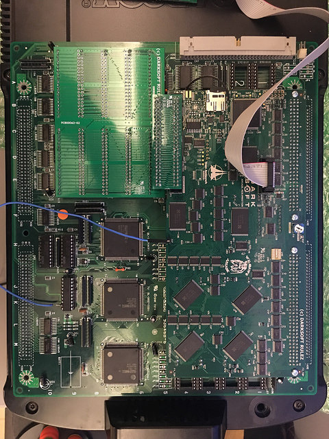

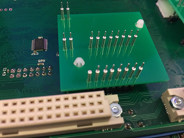

Finally I tear down to take photo then broken the leg
How can I fix it , poor m

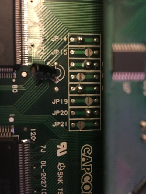

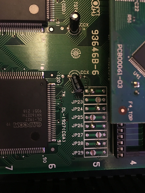

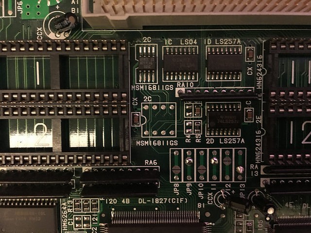

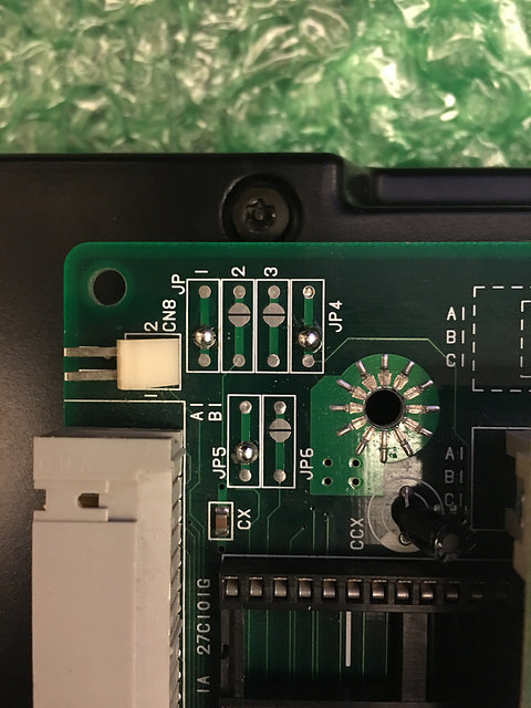

Is it me or JP10 and JP12 are SHORT! when they should be OPEN.
About the leg, if it's only one, the easiest option for you is to run a cable like the one you used for J17.
for sure, you need to cut traces on jp10 and jp12. they are connected with a very small trace -- look hard (or use a multi-meter!)
For the pin, i'm not sure of the cleanest way to fix a broken pin. Perhaps you could just solder it back on? I would take someone else's advice... but you could always just solder a wire from where it is now to where it's supposed to go. Just get the signal through!
edit: looks like darksoft beat me to it!
Guys I keep saying it's better not touch the jumpers, leave them alone as they do not affect the CPS2 multi operation at all.
Shorting both at once does affect, though (shorts one address line to GND).
i fix the leg use wire method, i try to clear cut the JP 10 and 12 make it open, test by meter show it are open but same issue
Just remove all the jumps you closed. It will work with any of them in any position as long no pair is closed at the same time. (which was the case)
Or even them all open.
you means from jumper 1 to end all open?
But why the video guide and PDF have setting open / close I just want to know deeply , if all open will it damage the board ? Thx you
So I did that like video guide setting are the same , thx darksoft detail saw the JP 10/12 short by default , I make it open again and test by meter but same issue even I use the PAL F from come with my board and connect to Pin 17 with leg 7 and Darksoft send me the PAL G connect Pin 17 with leg 9

and i found that, if i haven't connect the JT17 with PAL F leg 7 / PAL G leg 9 it haven't sound comes out. not like the the Video tech like sound crack without the JT 17
Sound Issue still happen .......
For a long time no test again for the result, the update status is
Base on last time Mitsurugi-W say maybe i have some PCB has some fault on it, i try to brought a new Game A and B board to test again
The new board comes with SF2 15 anniversary version, all great with no any issue,
Then i try to do some test base on this new game board
1. i try to put the Darksoft multi board on the new with before F & G Pal. but unfortunately the sound still cracking. ( But already know issue not come from the B Board
2. I try to put back the F & G PAL to normal SF2 Game Board to test the sound, all function and no sound issue. (Proof that PAL is no problem.)
3. By pass the Use the PAL leg connect to Darksfot CPS2 board JT17, jump the cable from leg to B Board C13, sound still have issue
Any advise for me to work on next?
