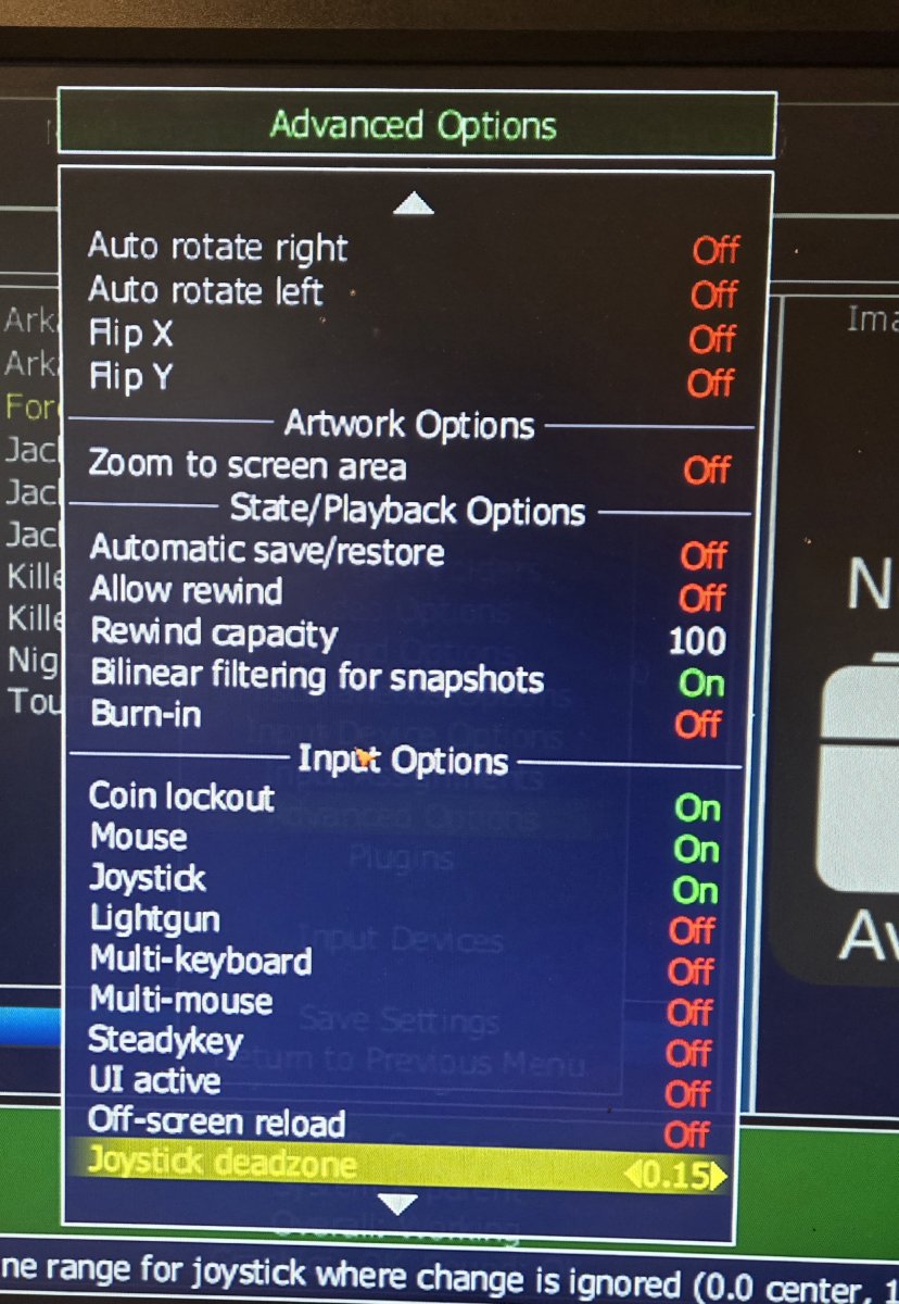

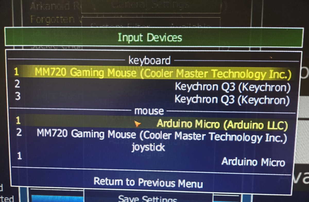

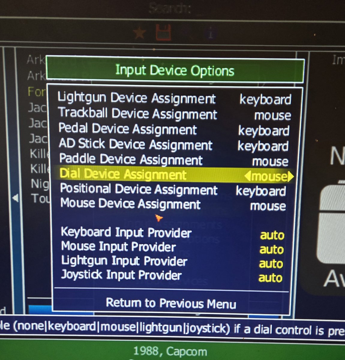

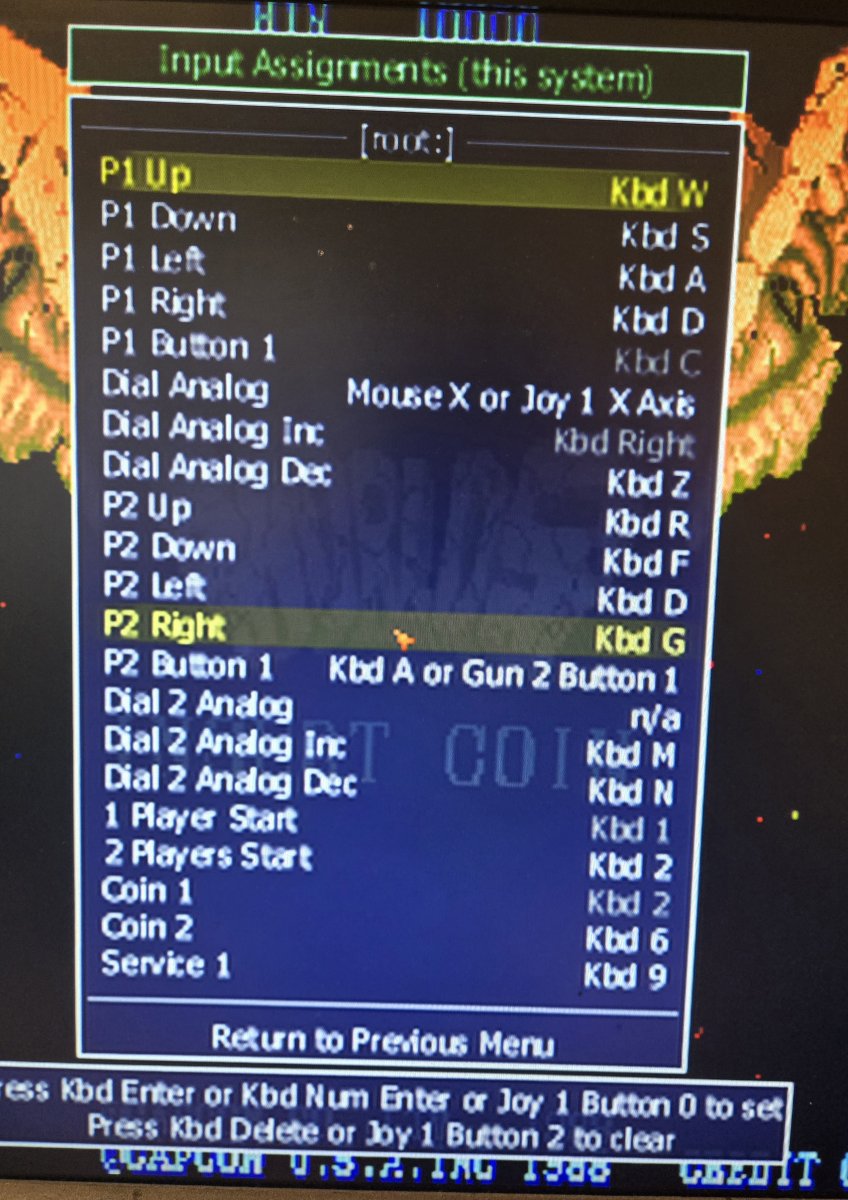

can you help me about the Mame settings especially ?
i couldnt make it work for Forgotten Worlds
it is always turning to 2 direction, not working well
Here are the menu settings. The spinner button, can't figure that out. Pretty sure when I set up the code, I disabled buttons as I was playing arkanoid exclusively.

thanks for the info, but it seems my firmware is not working well
im looking for somebody to help me to create Firmware+PCB Project for Spinner.
