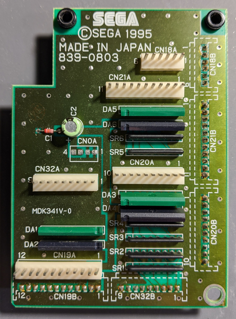

My Titan ST-V already has a daughter board that attaches right where your new design goes.

Yeah, it might not even work, just an idea. I’m not sure what Functionality the original daughter board adds.

My condolences just remember that we can always wait until you feel you are able to make these boards. No need to rush the process. I do like the design of your board tho :)
On the daughterboard, however, CN21 is where you would connect your kick harness. I had someone make me a stv to cps2 kick harness adapter for it to work because its not your typical (i forget if its HST or jst) but molex adapter.
Here is what the CN pin/pinouts do. This is info found in the st-v manual
CN22 midi out(JST NH 3P)
cn27 light gun trigger(JST NH 3P)
cn24 audio line output(JST NH 4P)
cn25 reserved output 4bitJST NH 5P)
cn19 a/d input 8ch(JST NH 12P)
cn32 extension i/o 8bitJST NH 9P)
cn18 serial communication(JST NH 6P)
CN21 extension i/o 8bit(JST NH 11P)
cn20 extension input 8bit(JST NH 10P)
