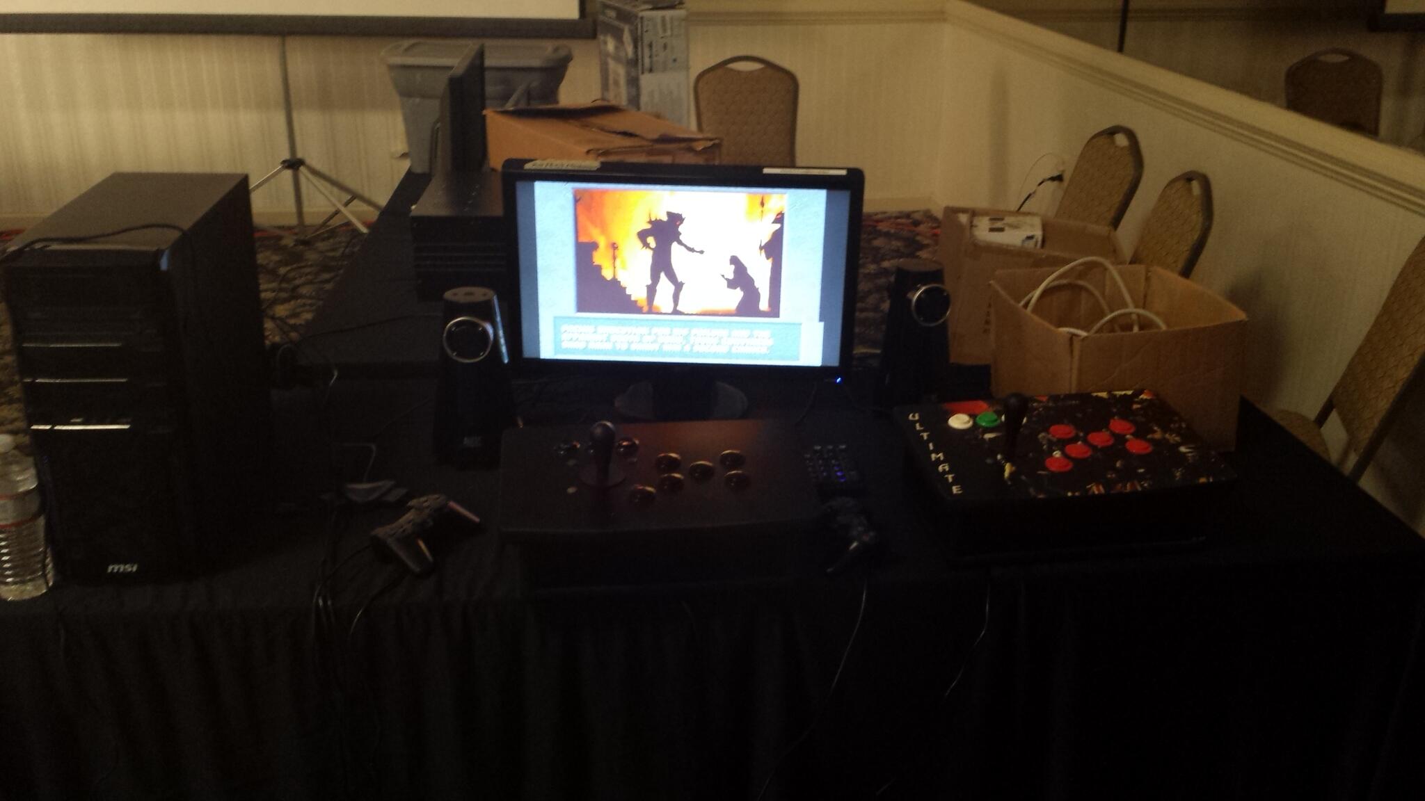

Here's a pic from a convention a couple years ago with some of my sticks hanging around.
Regular mame does have a lot of input lag. You ever use Groovymame? It cuts down a lot of the lag (same as disabling vsync on regular mame minus the screen tearing iirc) and even has a feature called frame delay to further reduce lag. I use it pretty exclusively vs mame.
