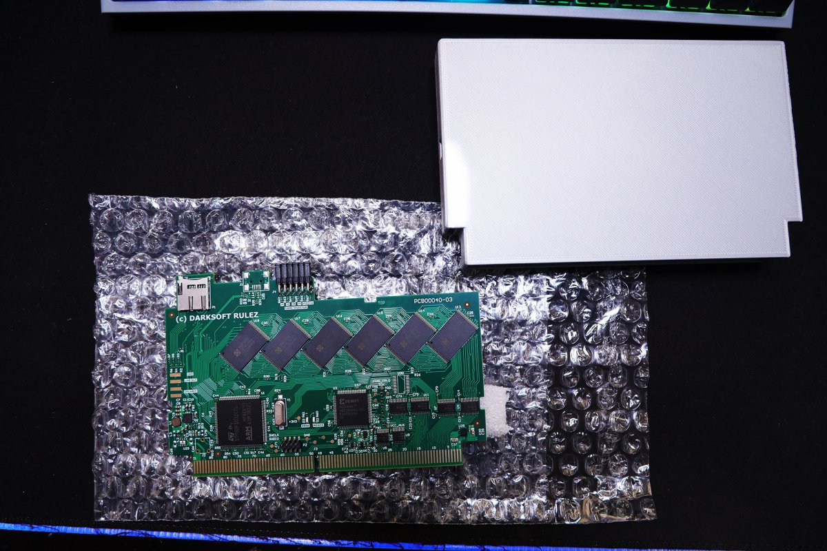

ST-V multi came in, but I can't seem to get it to work properly and could use some help.
I'm using the 2019-09-13 fileset. I moved that along with the other stuff (so, three folders on root: games, SOUNDS, and Documentation) to the SD-card. When I fire it up with a new jumper config, I get to the error screen, and the two lights are on. After 30-60 seconds, it goes down to one light. If I power-cycle, it goes right back to the same game error screen, but only one light stays on. So it is as if it is loaded in properly, but the game won't come up. My ST-V board has been tested with a regular cart and works fine.
Any ideas?

I did read the documentation that was in the downloaded files, yes. Here is a video as it should be more clear.
https://photos.app.goo.gl/jCoU9a7GTjxHsX9T8
EDIT: Purikura Daisakusen worked, so I though I had gotten it working, but when I flip back to Terra Diver, it does the same problem again (both should be 2P). Is the 2019-09-13 fileset good? I tried ~3 other games and none of them worked.
Tried reflashing the SD card, but no luck. Tried another SD card, no luck.
EDIT 2: About 30% of games work so far, but the other 70% don't. It is really weird. Both Cotton games, Choro-Q, Radiant Silvergun, and Purikura worked. Pretty much everything else I've tried hasn't.

First thing I'd do is insert / remove the cart 4-5 times to make sure no dirt is in the middle.
Can you try on another STV mobo? If you can't, I'd recommend doing a rework of the solder on the 2 SH2 processors. Those tend to be the root of many issues.
Can somebody identify the SH2s for us? We’ll take a look at this later today. ✌️
Yep, thanks Darksoft. Ajax is my homie locally and has an ST-V and also just got a multi too, so we will definitely be able to do some testing. Will report back!
