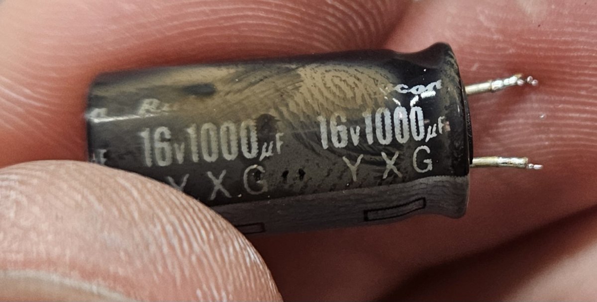

1000uF​
16V​
10mm​
1​
C41​

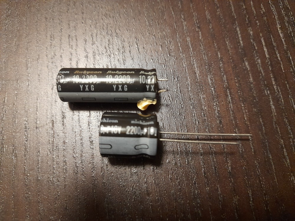

Thanks for posting all this very helpful, especially the cap map. I just rebuilt and repaired a 400-5397-01 which seems to be the most common version. It was missing +5v after the recap turned out to be a bad resistor by the fan plug a 4.7k that had rusted in half. After replacing the resistor I wasn't able to adjust the 5v and it was too high, this was a bad pot. Both voltage control pots are 5mm 500 ohms. Finally I replaced the fan with a ARCTIC F8-80 mm which is cheap and also a perfect replacement much quieter than the original, you will have to splice in the old power plug though.

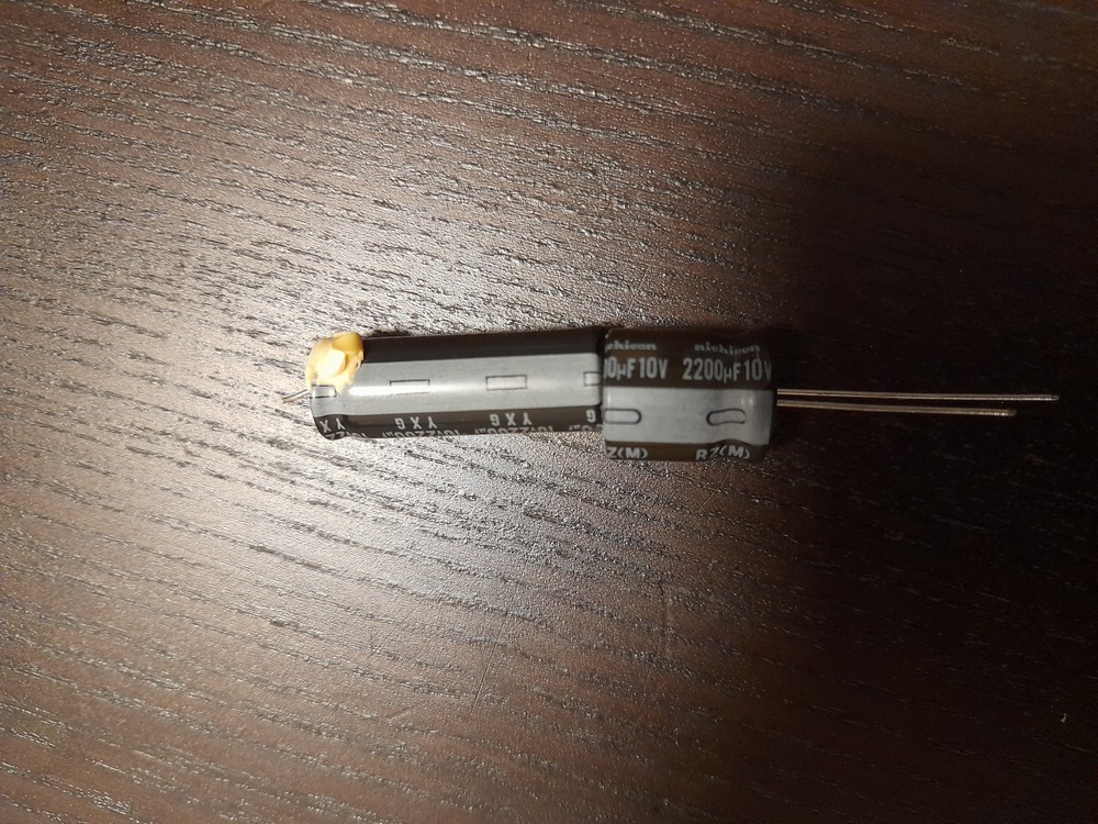

The one I had was definitely 10V. Likely different batches.
You can always go higher voltage, just be mindful of physical size.
Yes i know, but if you can edit your post for 16v ;)

2200uF 10V 13mm 5 C28, C29, C31, C32, C35
I have a slight fitting issue with the C35 cap, the one directly next to the 5V and 3.3V cables.
13mm are fine for C28, C29, C31 and C32 for C35 I'd recommend 10mm. That's the diameter of the cap I pulled out of my PSU.
