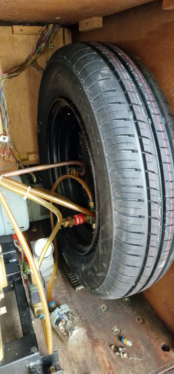

The question is when a car tire bursts, the manual says something about truck tires, they can withstand much more pressure...
Yes the tyre is marked "light truck", I'll cart it all to a tyre fitters & see what they say.....
No pressure guides on the tyre which is weird, this is the approx. measurements......

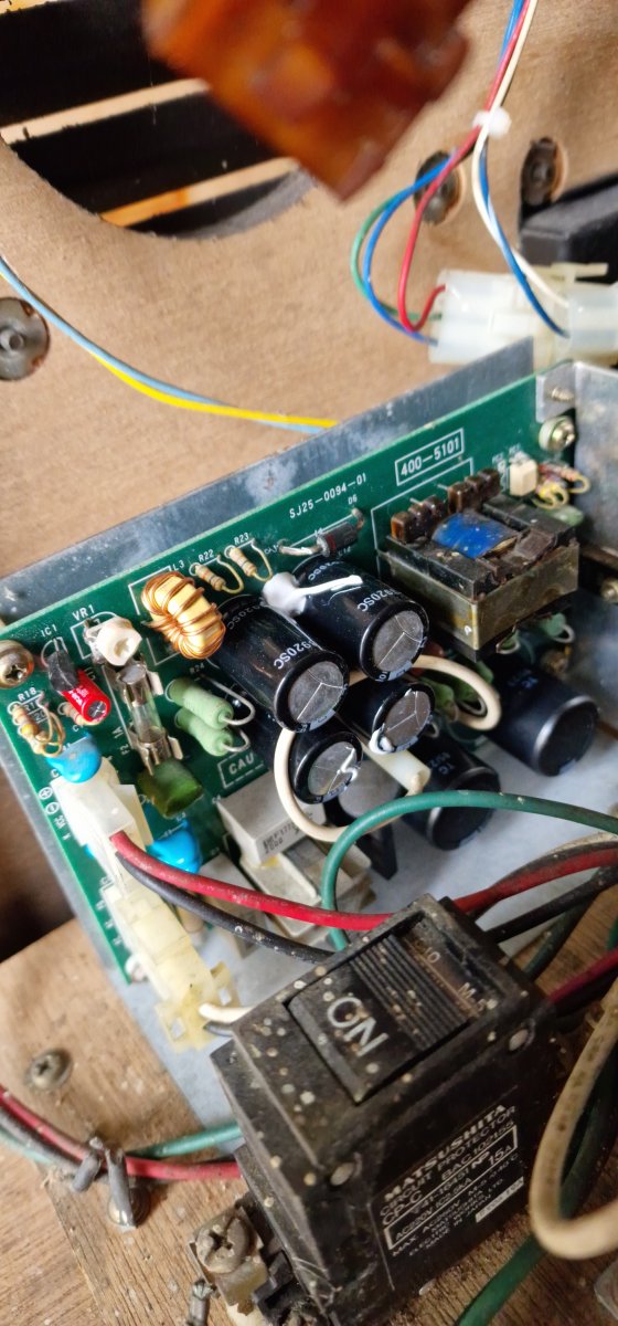

I figured as I was ordering capacitors anyway I'd replace the only other remaining original caps! I'm replacing all caps on the amp boards (SJ25-0091-02 x 2 & 601-6228 x 1) & a board I think controls the airdrive or fan?? Part number is 400-5101. Anyone got any info on this board? F2 was blown, BLACK :( However the cabinet fan was hanging off its mount and would not turn so hopefully that is why F2 is blown. In any case I'm recapping it, if it blows after that I have more work to do! Aiming to play by Christmas!!!!

OK, it all powered up with no bangs or smoke!! New tyre fitted but the water/oil filter is leaking air so fixing that now. The fuse blowing on the power board was due to it being set to the wrong voltage! I'd never changed this and assumed it was OK as the monitor is marked 110V. However on power on it blew the fuse, I checked the power going into the PSU....240V!!!! I figured nothing to lose by changing the jumper wire to 240v....no blown fuse and the fan works :) It's been like this since I owned it & most probably since the machine arrived in the UK!!! I'm amazed it only blew the fuse, finally some luck!!!

My only worry is whether the tyre can take the pressure, the original has no pressure markings, I guess worse case scenario is it goes pop at some point!
So, fix the filter, finish sorting the steering mech out (bearing on the cam wheel)

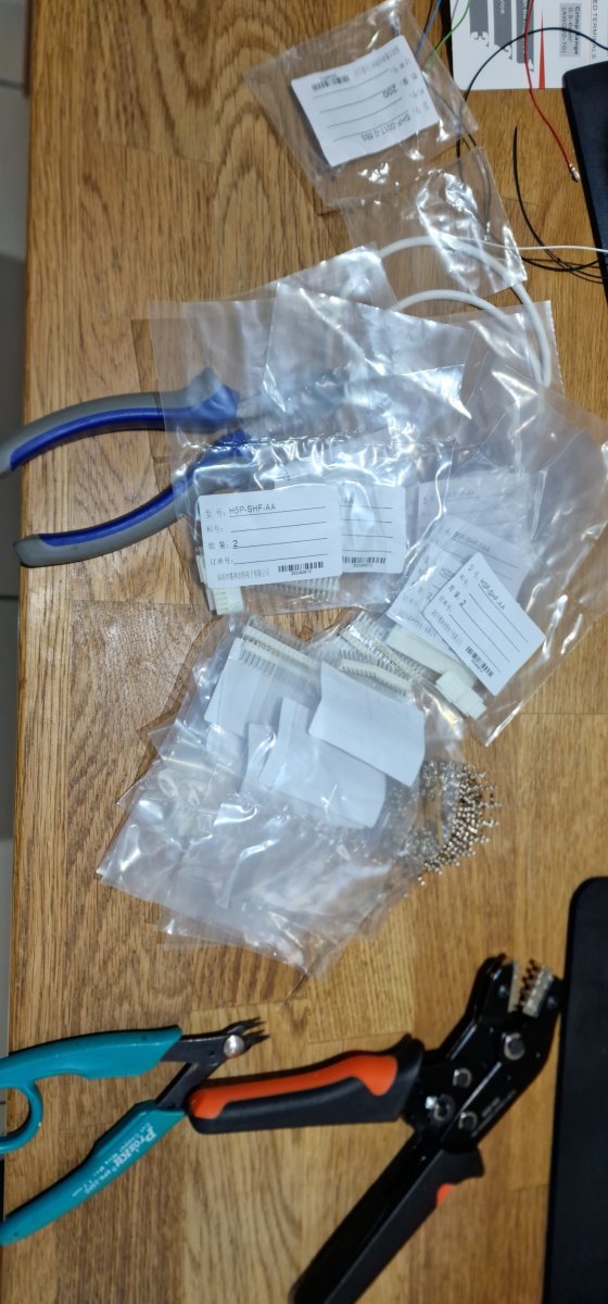

Filter is fixed, ended up getting a cheap version off eBay as CKD ones are £80! Game kept resetting etc, had bad pin connections so I ordered all of the JST connectors & pin headers. A tip for anyone else, it's easier to destroy the old pin headers than try & desolder them, I used hot air on the PIN side rather than solder side and took each pin out one by one.
Once the wiring is all redone I'm hoping that's it, just some tidying up to do, replace missing bolts and PLAY!
