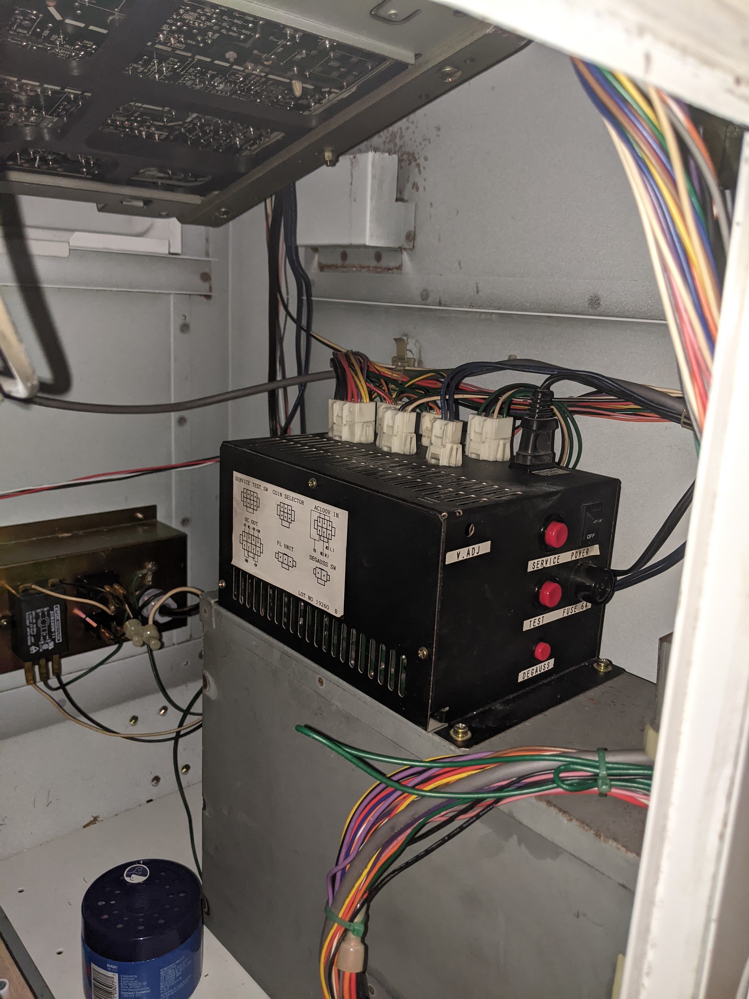

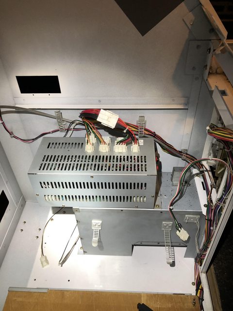

Were there different revisions of these psus? I have some of these that look similar to the one in your cab, but these seem smaller I think. Need to open it and see if there are any specs on it. Can you check if the pinout is the same in yours?
I believe the smaller black PS were from the Neo Candy 29 and not the Super Neo 29 - A friend had a few Neo Candy 29 and I believe I remember seeing the black PS in those.
Not a great shot of the diagram but I think still legible.
My Super Neo 29 has the exact same black power supply in it. Mine is just the plain JAMMA Candy model if that makes any sort of difference.
Looks like between these they are wired a bit different, will have to check my super neo 29 to see which one it has.
So maybe the distribution looks like:
Neo Candy 25/29 - Black PSU
Super Neo 29 - Black PSU
Super Neo 29 Type 2 - Silver PSU
@statix138 - Do you know if yours is a type 2? The way I am telling them apart is the decal on the side of the cab, not sure if there are exceptions to this. The big super colorful decal I believe is a Super Neo 29 and the more subtle, smaller one (like found on mine) is a type 2.
I am not sure what the original side said as when I got the cab the art had already been replaced. I can tell you that the original marquee that came with it was the wide single image marquee, like this one, and it had just the regular Super Neo 29 panel, not one that had anything Hyper64 on it.
Looked in my Super Neo last night and confirmed it is the same PSU as Derick2k's.

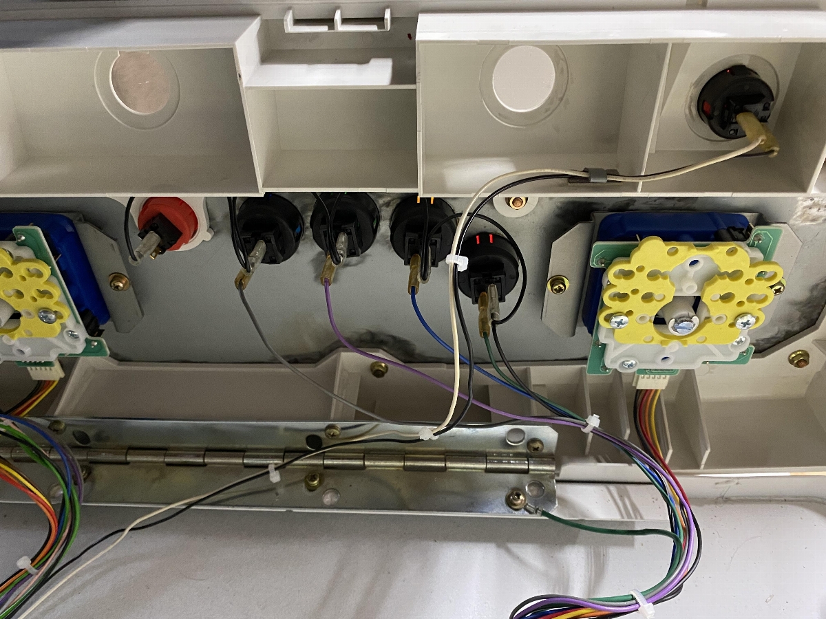

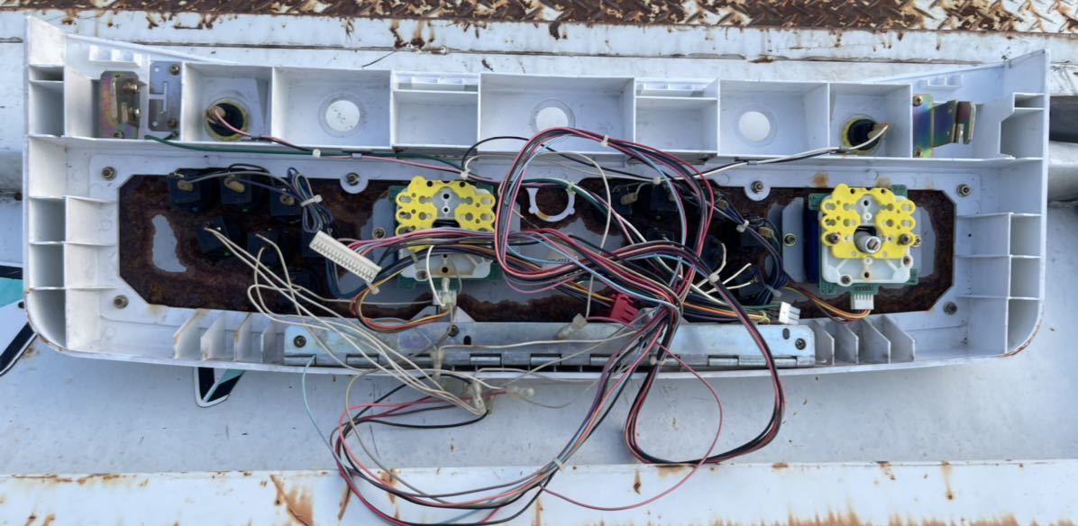

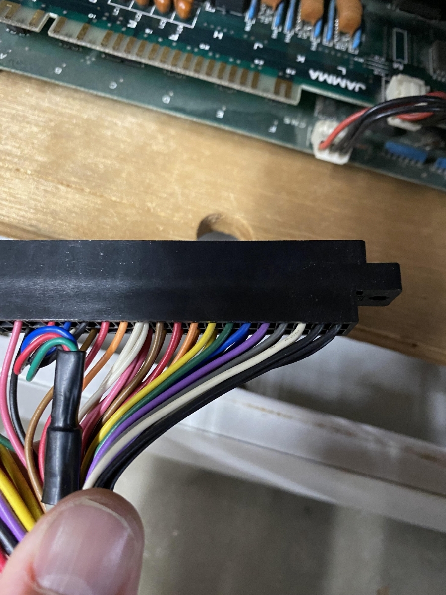

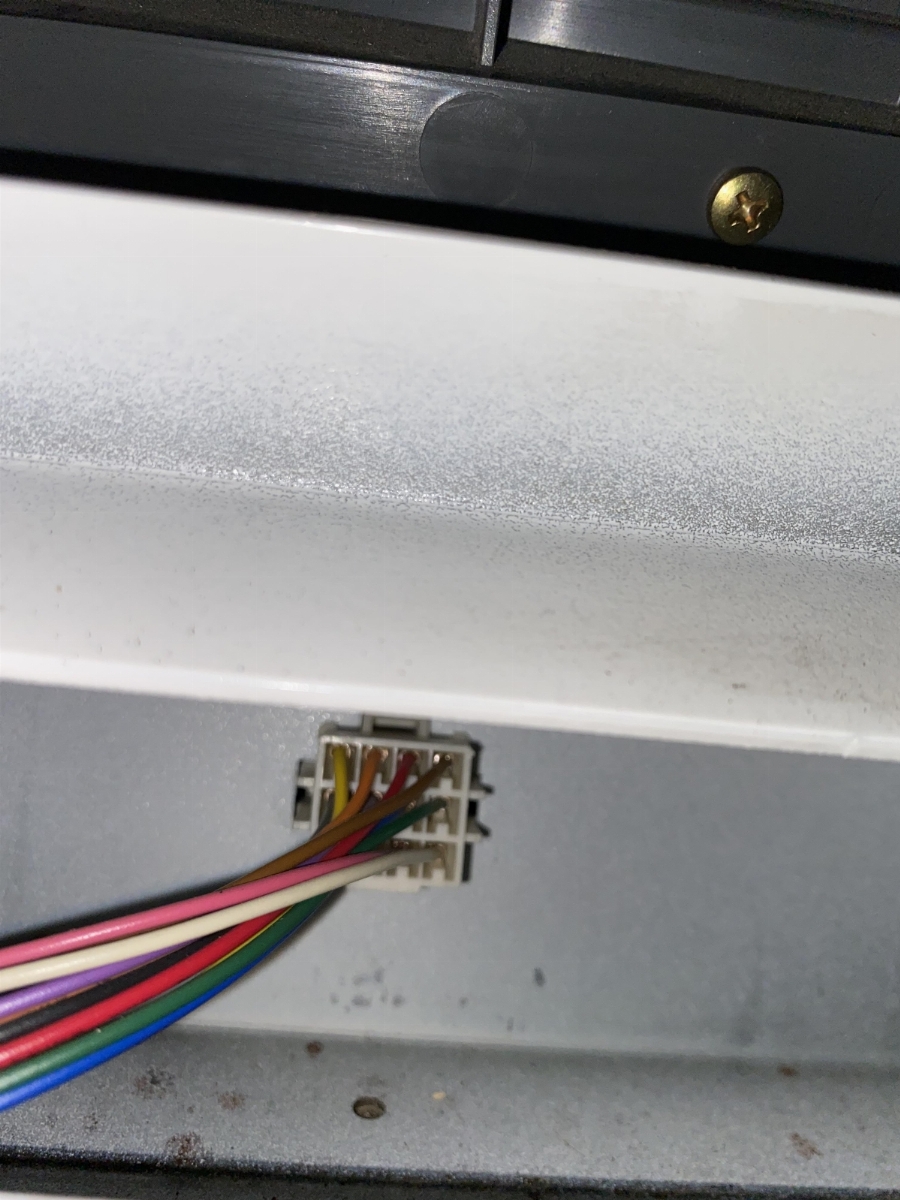

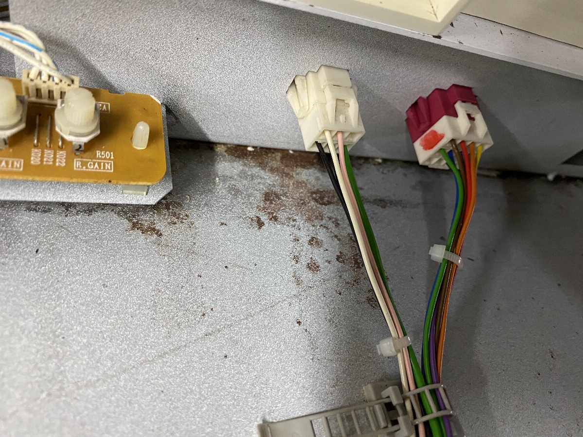

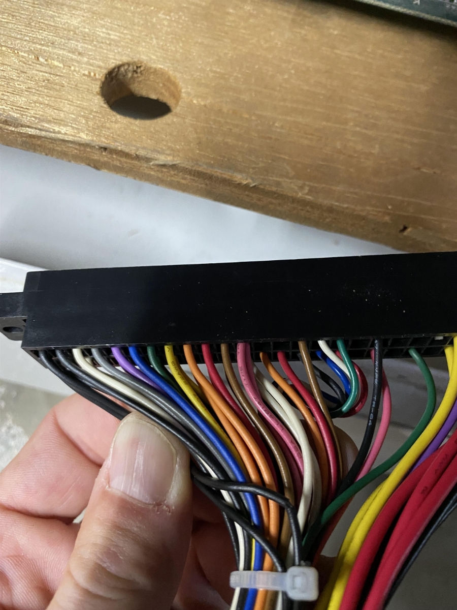

Control panel wiring documentation. Not so much any new progress, just getting some wiring documented as it will help myself and others figure out how to add in the start/select buttons if needed.
JAMMA (MVS) Parts Side -
P1 Start = Double white wires
P1 Select = Single white wire
JAMMA (MVS) Solder Side -
P2 Start = Double pink wires
P2 Select = Single white wire

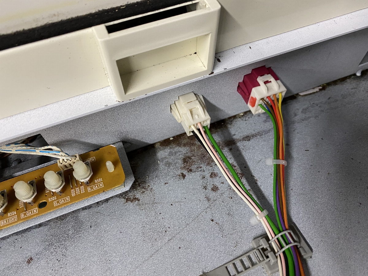

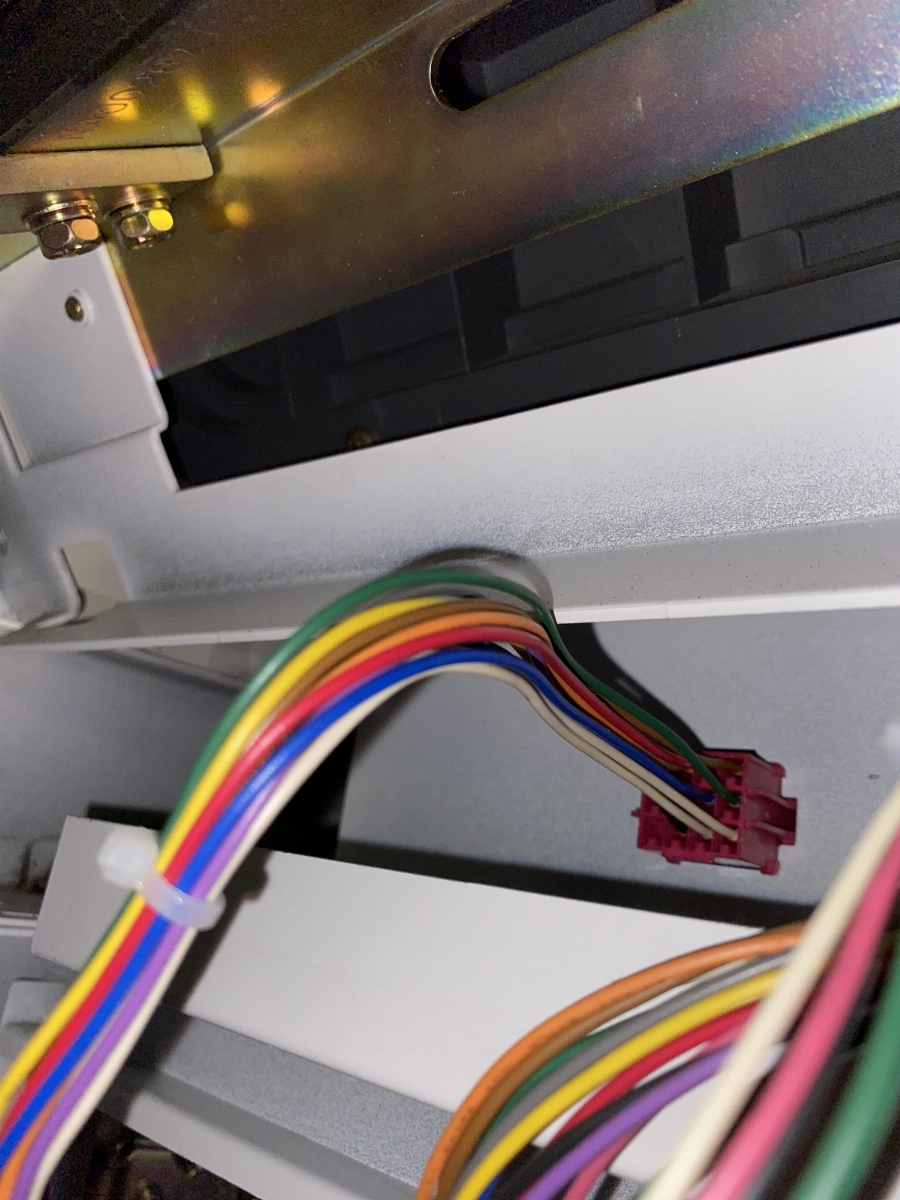

Red Control Panel Connector Back Side -
Near white wire = P1 Select (UP)
Far white wire = P2 Select (Down)
Small white control panel connector rear
White wire = P1 Start
Pink wire = P2 Start
White Control Panel Connector Back Side -
Red Control Panel Connector Front Side -
Unpopulated left position = P1 Select (UP)
Unpopulated right position = P2 Select (Down)
Small white control panel connector front
White Control Panel Connector Front Side -
Unpopulated left position = P1 Start
Unpopulated right position = P2 Start

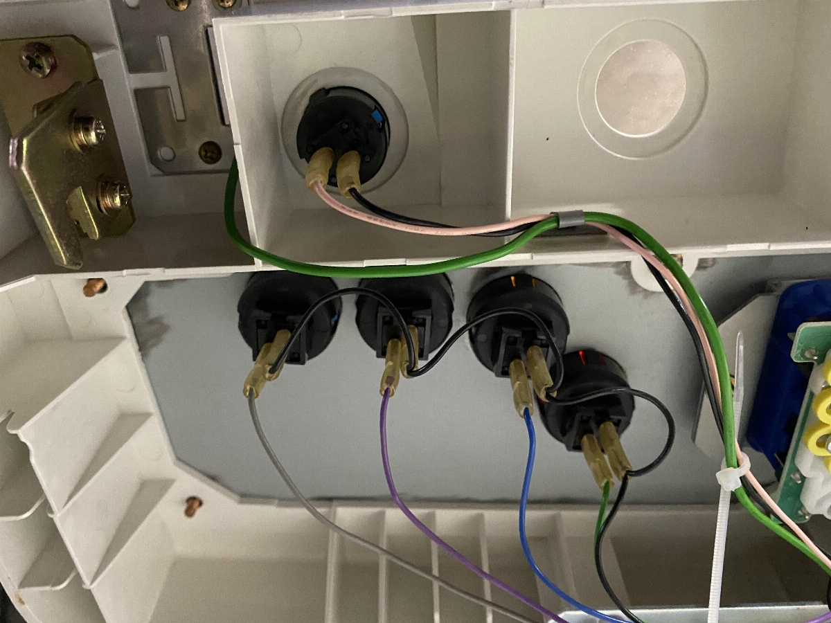

Control Panel Underside - P2 side
(pink wire = P2 start = small white connector)
Control Panel Underside - P1 side
(white wire = P1 start = small white connector)
Currently I have only the P1 / P2 start buttons connected. In the future I will wire up the single P1 select button. It will get pinned into the Red control panel connector, bottom left unpopulated position.

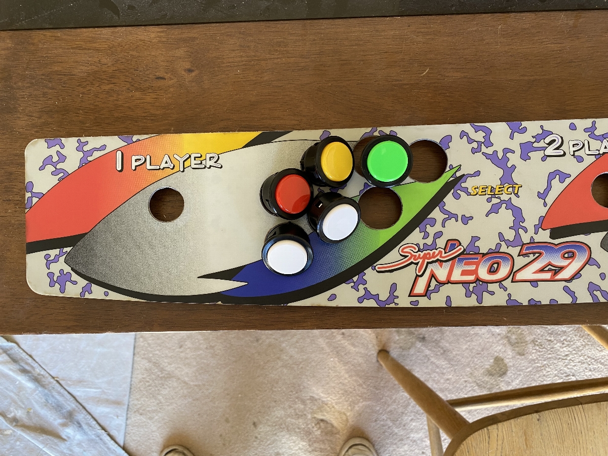

I’m looking to change out the buttons on a Type II I bought couple years ago. Would you happen to know what kind of buttons they are? Thanks.
I dug up my order from Focus Attack where I ordered the buttons from:
SEIMITSU-PS-14-D-G/KSeimitsu PS-14-D 24mm Pushbutton Green/Black
2​
SEIMITSU-PS-14-D-Y/KSeimitsu PS-14-D 24mm Pushbutton Yellow/Black
2​
SEIMITSU-PS-14-D-B/KSeimitsu PS-14-D 24mm Pushbutton Light Blue/Black
2​
SEIMITSU-PS-14-D-R/KSeimitsu PS-14-D 24mm Pushbutton Red/Black
2​

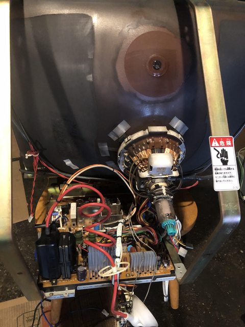

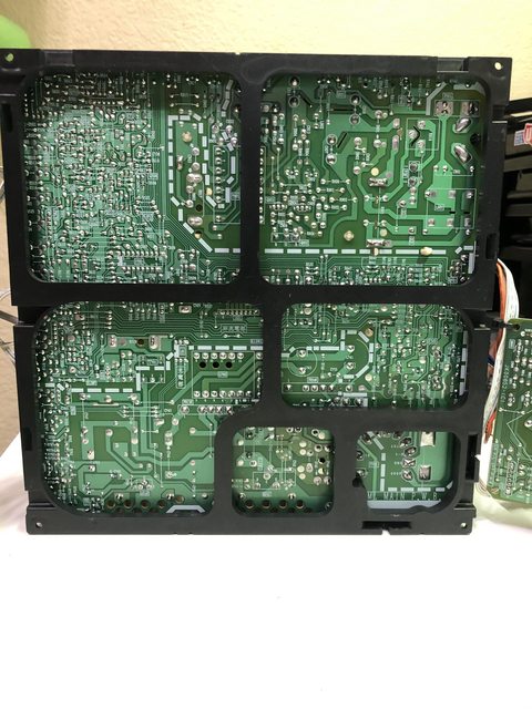

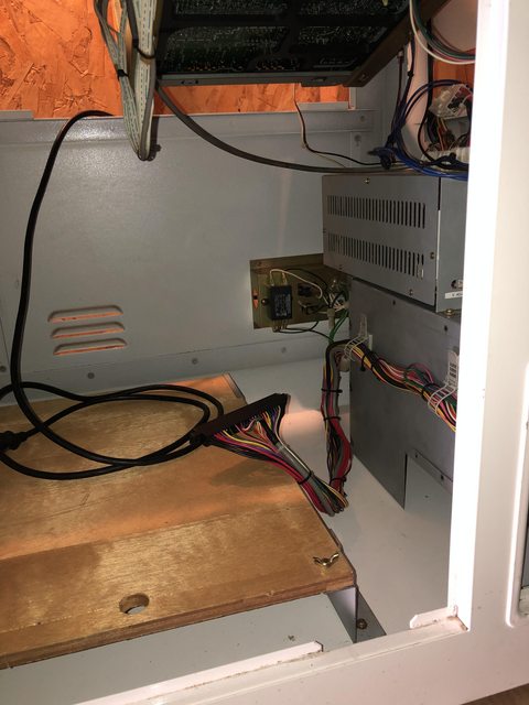

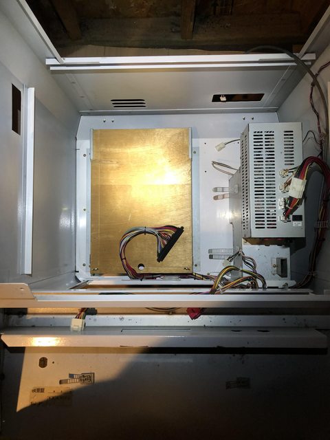

Picking up on this again, with the power supply recapped its time to reinstall the wiring harness,
coin box and power supply.

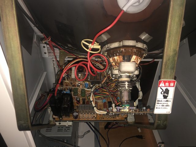

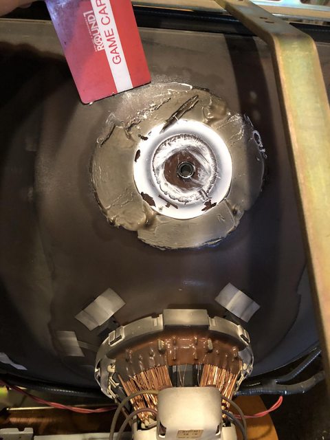

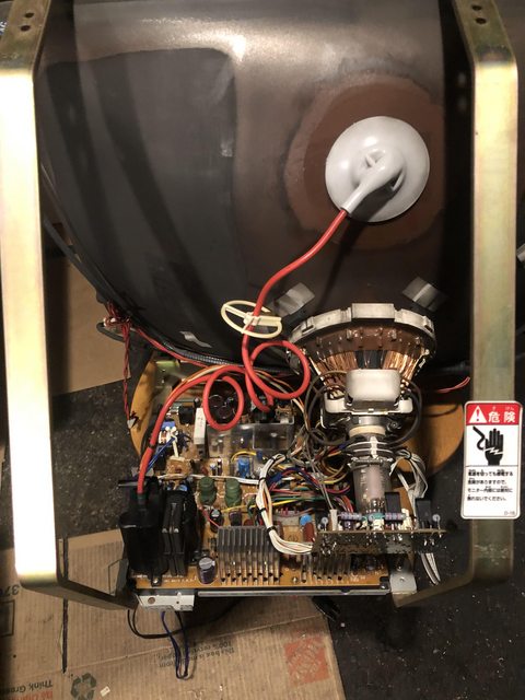

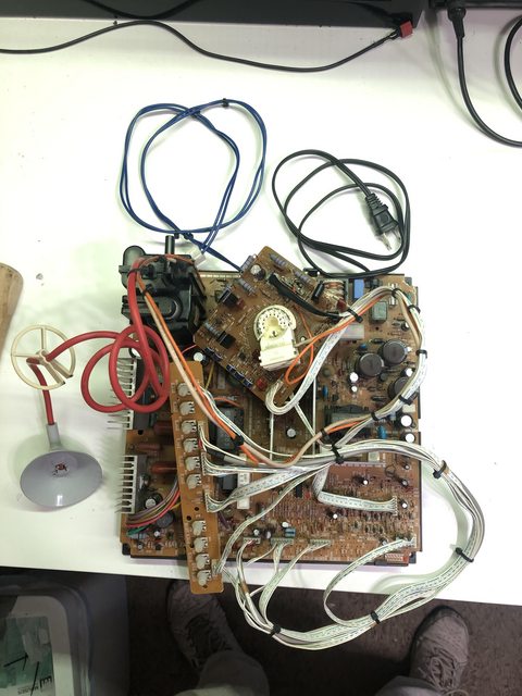

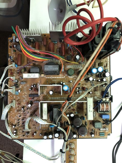

Next, we recap the monitor chassis and give it a good brush with a large paintbrush I have just for dusting. Some Krud Kutter on a rag will go a long way to cleaning up the wires and the flyback.
Replace all the old zip ties and ready for re-install
Well, almost ready for reinstall...
Much better and all mounted

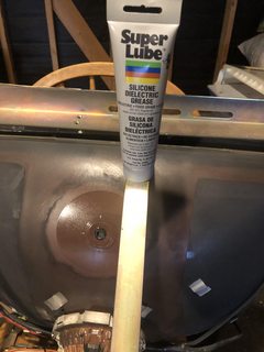

Never forget lube (or dielectric grease)
All systems go, we are ready for launch
The turkey is stuffed...

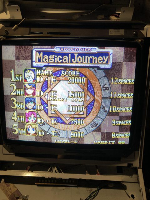

Looks like a success
Down low, too slow ! Where did the Neo go...

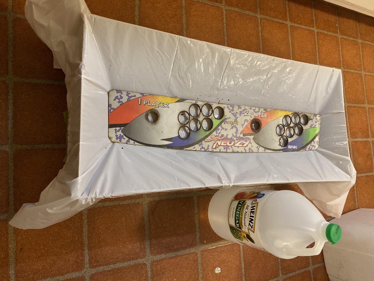

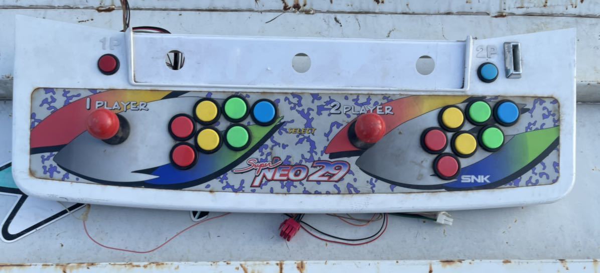

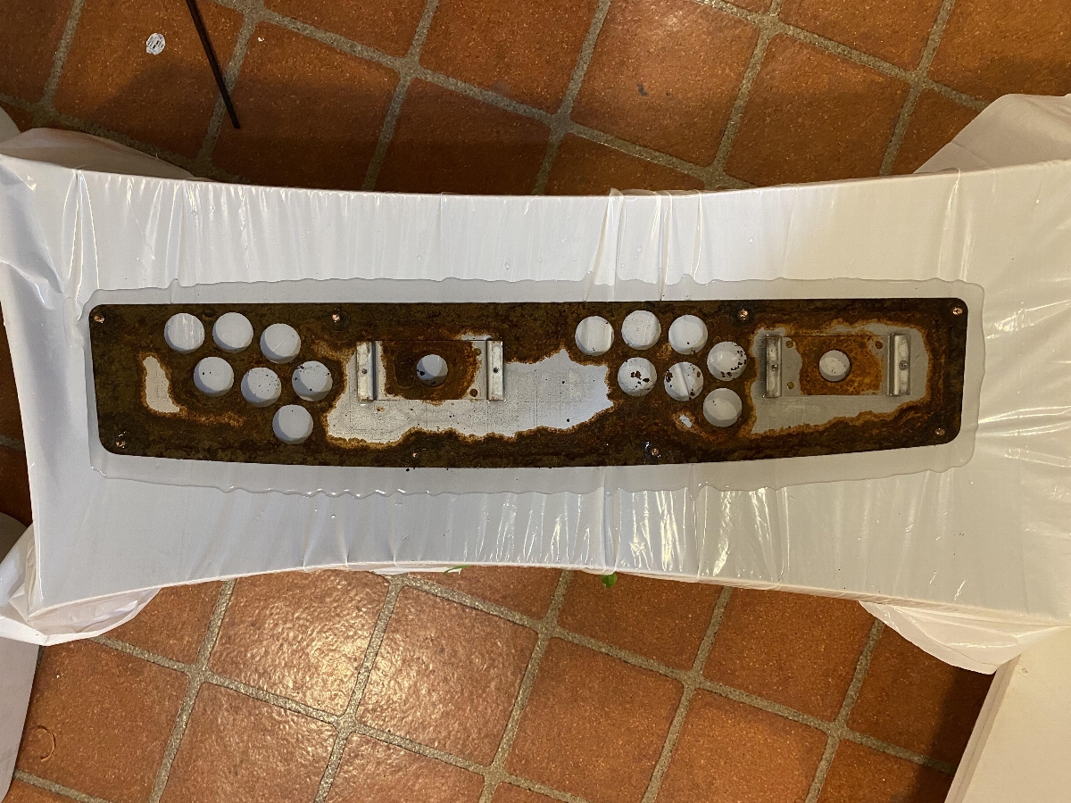

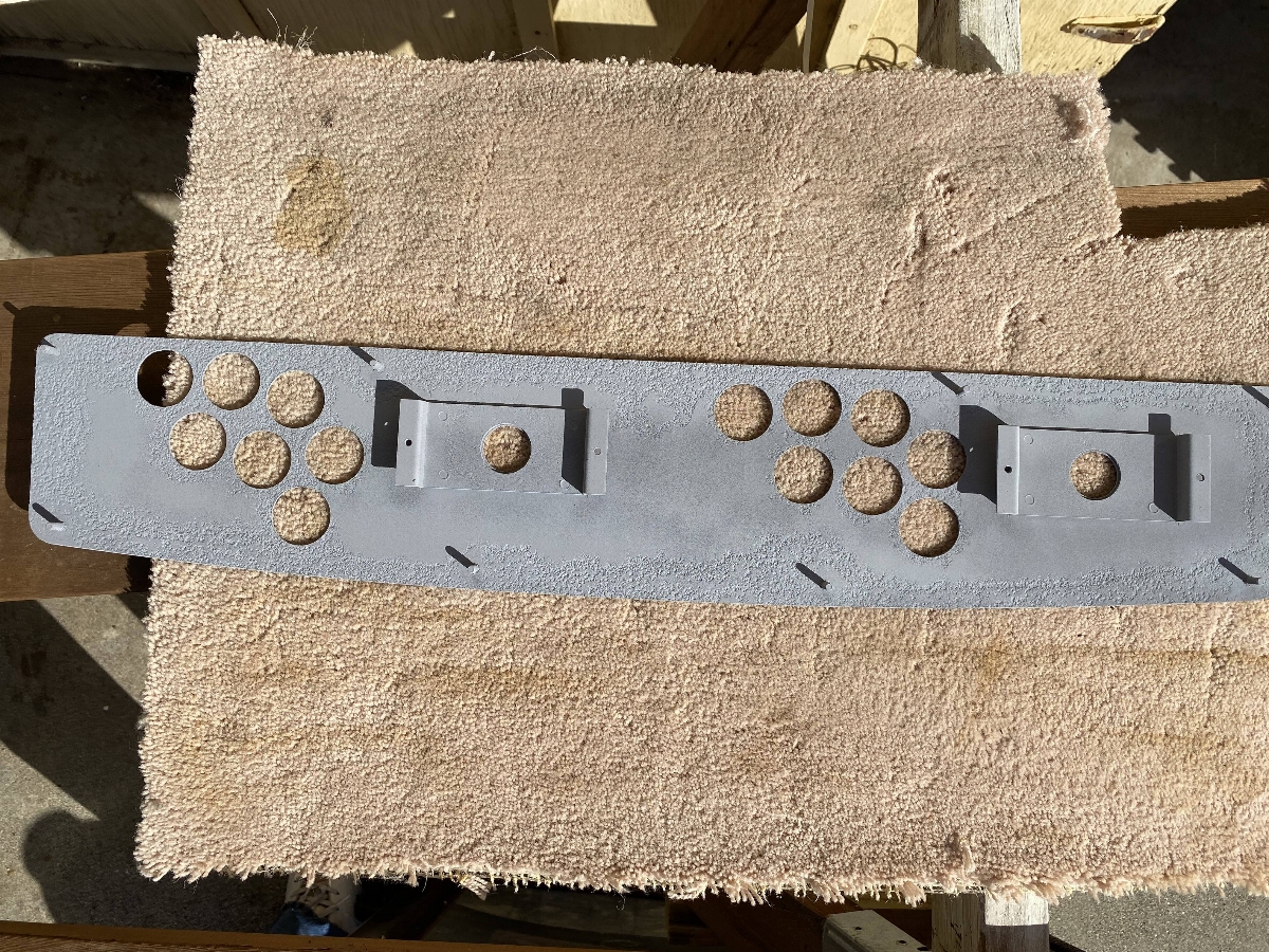

One thing I have always wanted, even if it is not exactly correct for the cab, is a Super Neo 29 type 1 control panel. I know that reproductions exist, but I have a thing for only using original control panels. So as luck would have it I nabbed one off YAJ, but I have my work cut out for me.
Panel removed and my white vinegar bath has been constructed from a box and a trash bag. Hoping that I can keep the panel submerged and use as little vinegar as possible, so a large shallow pool is best.
Press F to pay respect
After sitting about 20 minutes, Checking the overlay and looks to be holding up to the vinegar. Giving the bottom a scrape to remove some rust.
A few cycles of soak 30 min, check on overlay, scrape, soak 30 min, scrape
The next day after soaking about 10 hours and a light wire brushing
Overlay seems to have withstood the vinegar just fine. No staining for sitting in a toxic rust bath overnight either.

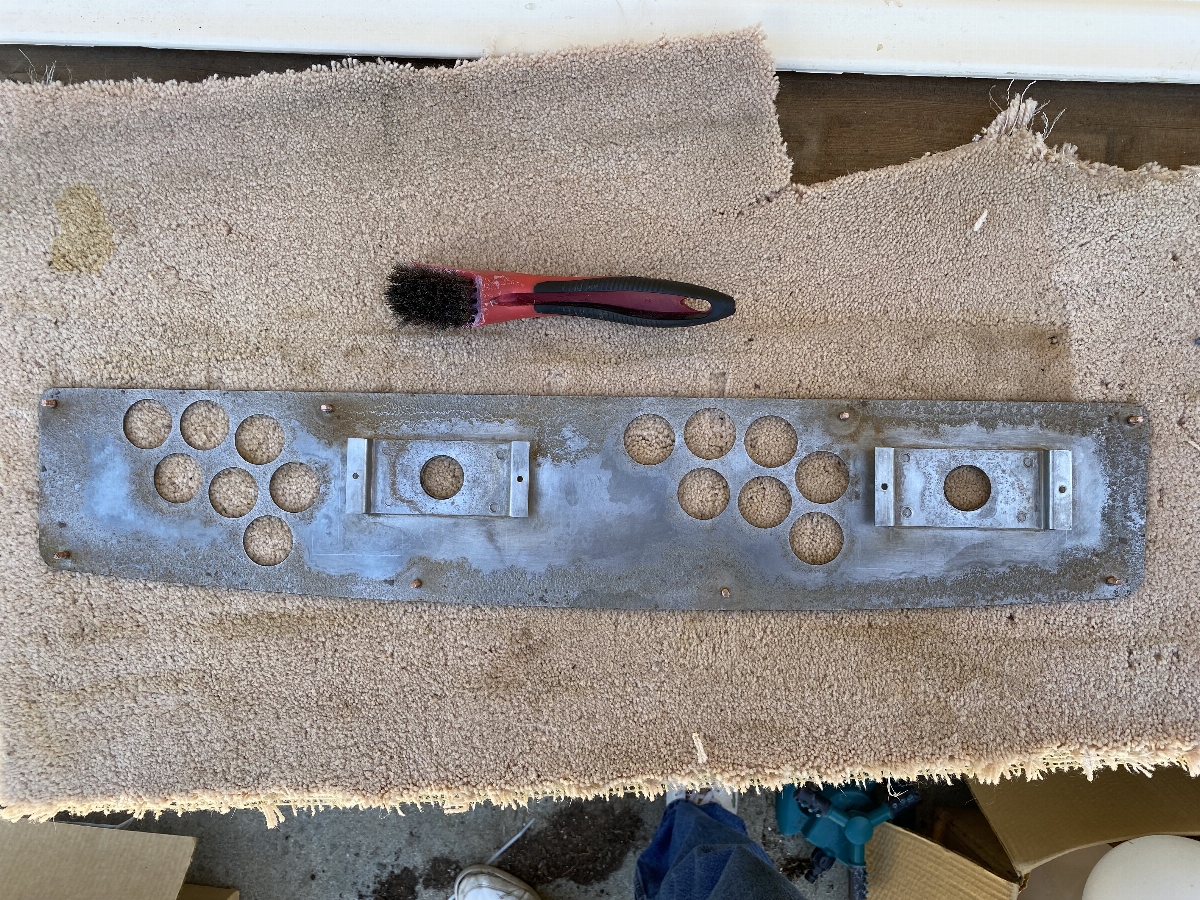

Gave the bottom a good final once over with a wire brush and wiped the whole panel down with iso alcohol. Masked off the overlay and gave the bottom a coat a primer to hopefully stop the oxidation.

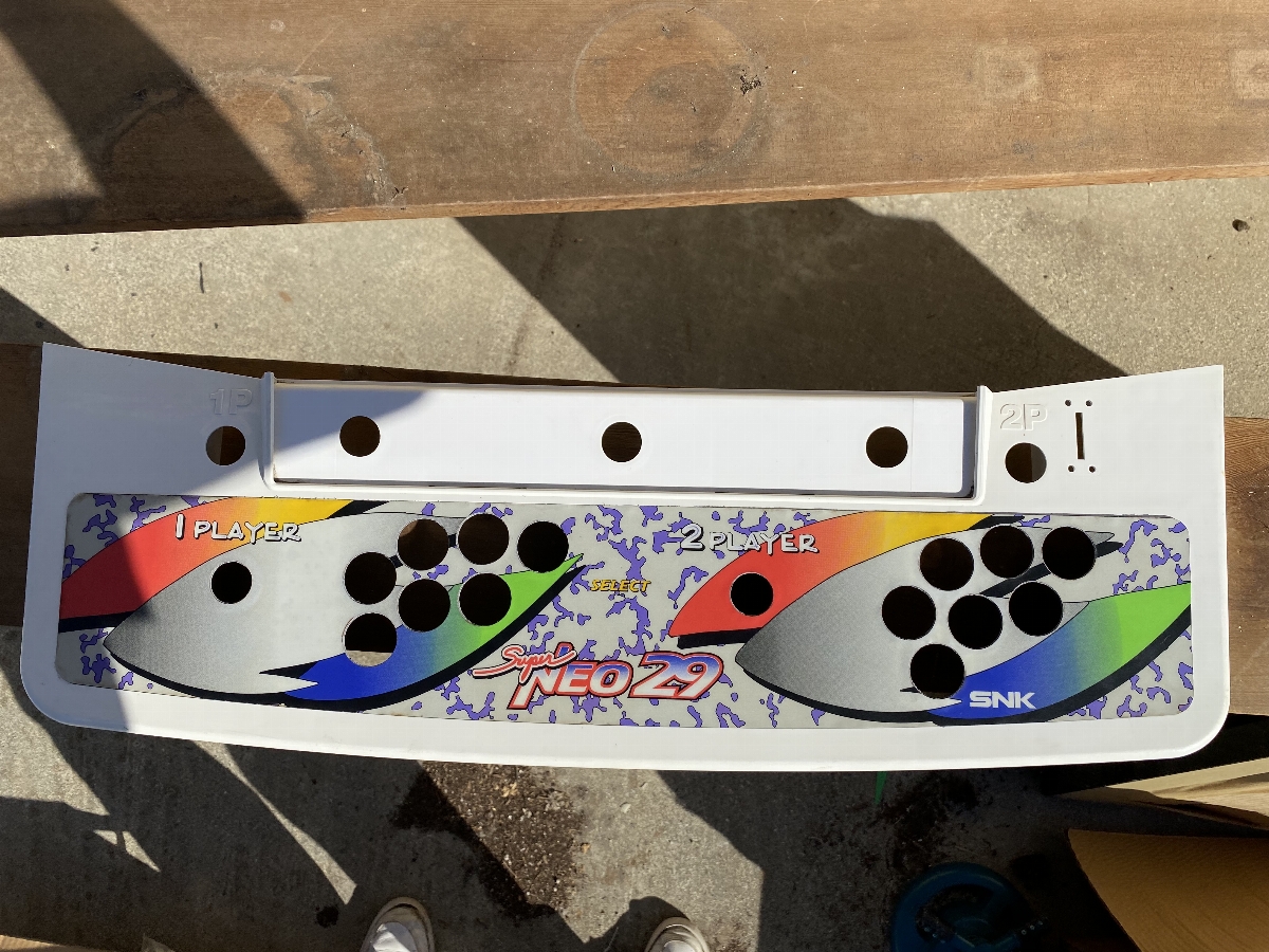

Getting ideas for button colors. You can see a little bit of edge damage to the panel, but pretty minor considering the horror show that was on the other side.
Panel set back in the surround
So I can check one thing off the list. Got a spare panel and surround for when I want to do fighters in the Super Neo 29 and support a 6-button or 4-button fighter. Super happy to have this pretty rare panel and feels good to give new life to it.
