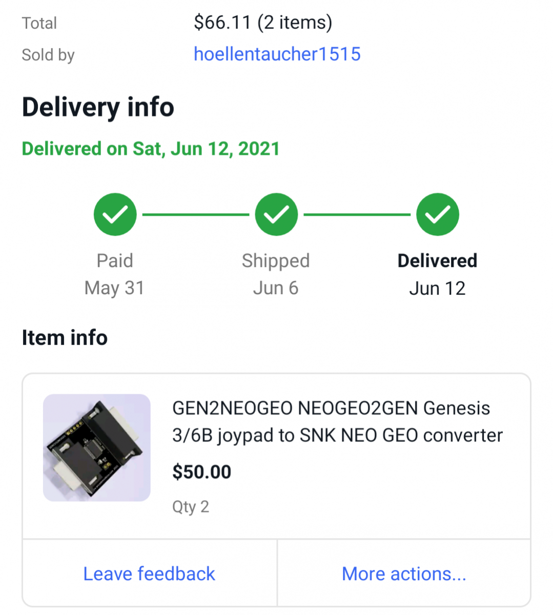

I got these on eBay.
The seller claims they will work in either direction, if a DB9 male to female adapter is used.
I haven't tried this.
I haven't seen this listed or sold anywhere else.
The setup isn't that great for DB15 to DB9; Button 6 = coin insert.
Edit: They are for sale again from the same seller, located in Austria
Edit: They are for sale again from the same seller, located in Australia.
https://www.ebay.com/itm/GEN2NEOGEO...2349624.m46890.l49286&mkrid=711-127632-2357-0
I really doubt those would work in the other direction... whatever the logic chip is (love it how folks sand off the silkscreens) it's going to have input and output pins. It's also going to expect +5v from the Neo Geo / Supergun port to operate. I guess it's possible that some of the missing jumpers could change the functionality, but no way to know. I've used items from that guy before, he tends to do a half way decent implementation of other peoples designs. Nothing wrong with that if the design is public, but I'd not trust it to do more than what it's listed as.
When I purchased from him, the description in the listing stated that it worked in either direction with the use of a male to female DB9 adapter.
I had purchased the last 2 that were for sale at that time.
The new listing does not state that.
I will see if I can dig up the old text from the listing anywhere in my records.
You can also always reach out to him. He responded to some of my questions.

I think the expanded description at the time I purchased is gone forever. If you look at the name he used for the item, at the time that I purchased, you can see that there is a reference to it working both ways.
Now, the listing only states GEN2NEOGEO but previously it also started NEOGEO2GEN.

I agree with you. It irks me a lot.
Fortunately, I have other adapters for Genesis, Saturn, it and SNES that allow full use of all 6 buttons.
I requested a pinout mapping from the seller but he declined to give me one.
I could obviously figure it out myself but, since I have other adapters, I haven't taken the time.
These work well for most arcade PCBs since most do not require 6 buttons. Still - just knowing the coin is mapped to button 6 turns me off and I hardly ever use them.
I have to test again, but I think they didn't work with my 8bitdo wireless controller. I'll try it out later and update the post.
Edit: I can confirm it doesn't work with the 8bitdo m30 wireless gamepad. It seems to work at first, but sometimes pressing button A causes random coin insert or for button B action to occur. Pressing button B sometimes results in the actions of button B and button A occurring at the same time.
