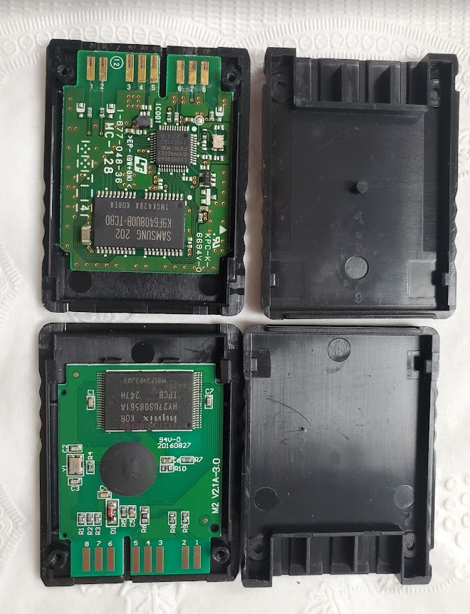

Well sadly it's not that easy or I got a new-er PS2 Memory Card... but here's a side by side comparrison, I think the top was Soul Calibur 2, and the bottom was a PS2 (Original Sony Yellow Clam Shell) Boxed NOS Card.
My guess is that Brizzo found out which lanes on the chips are basic IO/Write Enable pins, and then used a simple USB-> SPI or something micro controller, soldered it on, and was able to facilitate the communication, but that's somewhat based on the fact that you have to install FTDI (Future Technology Device Interface) .DLL which allows you to have a basic USB interface... and even if you could do that, there's no guarantee you'd use the right hardware or firmware to make his programs work...
Another plausible thing is that sony encased the chip (Bottom Pic) in plastic, as it's the thing that's vulnerable to hacking which could be the IO part... But again that's just my amateur assessment.
I know, they went to a lot of effort but it's still a clone.
There are small differences on the packaging but you see it when you open the device.

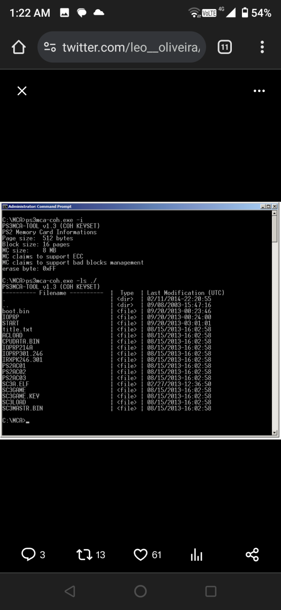

This tool allows one to directly manipulate files on a PS2 Memory card in a similar manner as mymc.py, where the files are being modified in-system, but not as a "whole chip dump".
This is, and has been for many years, public knowledge, so nothing new here.
If you wanted to use the original version of PS3MCA, you would need to desolder the NAND from your 2x6 dongle, solder it to a PS2 memory card, and then do your edits with PS3MCA, before then resoldering it back to the 2x6 dongle. You will also need to use the method mentioned above for modifying the files to work on a different dongle than they originated from.
Moving forwards in time, somewhat recently (in the grand scheme of things, but still a few years old at this point), the encryption keys and other bits necessary to communicate with the MG chips in a COH dongle were obtained. I personally forget if this was a leak, disassembled debug hardware code, or a decapping of magicgate chips, but the end result is the same.
PS3MCA was forked to contain this new code, resulting in a version that can FULLY directly modify COH dongles (Python, 2x6, etc.)
Now, if all you want to do is just play a game that you have a .bin dump of, you will still need a few additional steps.
You'll need to extract all the files from the .bin using mymc.py
You'll then need to access the COH dongle with the special version of PS3MCA and upload all those files
