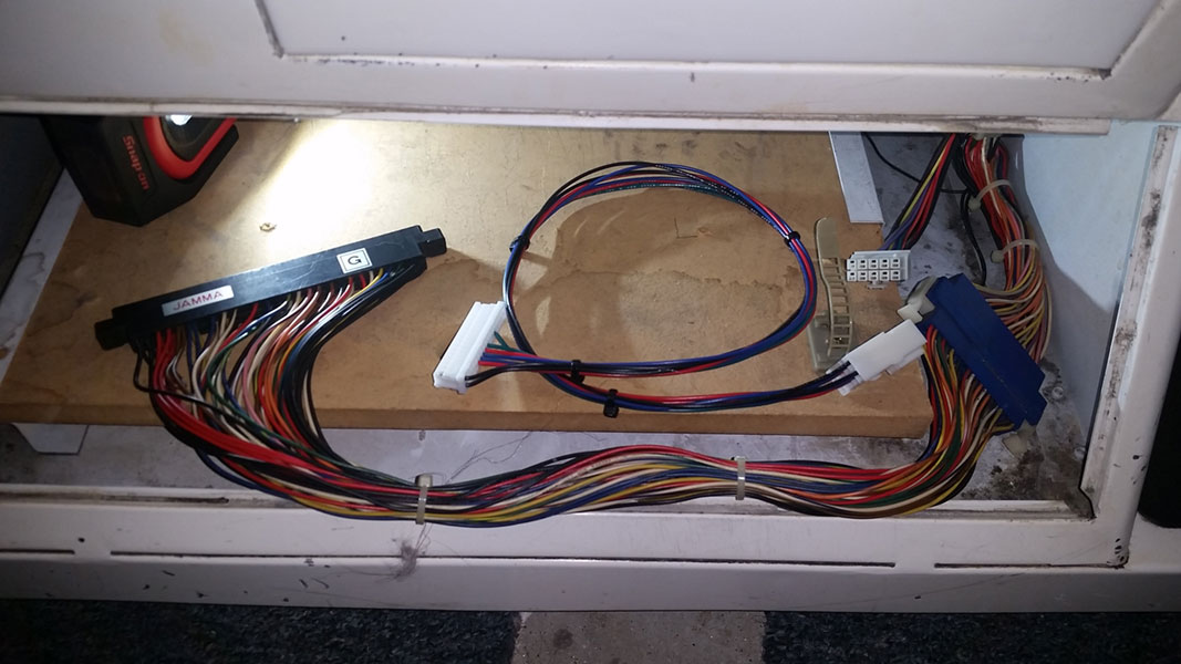

How are other Egret owners out there handling kick-harness connections?
I think I solved my kick harness issue... I built a 3 part harness:
the left two are adapters that connect to the CPS2 kick harness connector or the STV kick harness connector, the one in the center runs inside the cabinet, and the one on the right is for the control panel itself. The center harness terminates using a 10-pin TE AMP UP connector pinned similar to that of the kick connector in an Net City.
So I have an easy disconnection point in the control panel box if I need to remove the control panel, and in the PCB area I can easily swap to different style kick connectors when I swap boards.

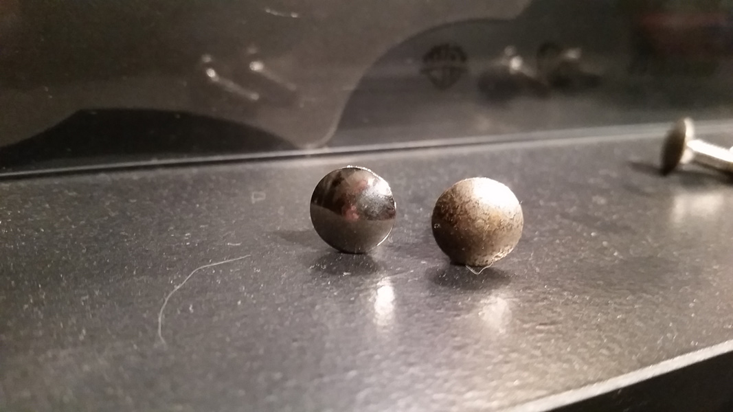

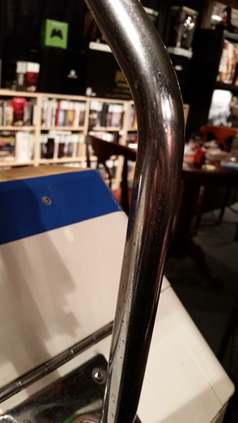

In cleaning up the header I used some Blue Magic Polish on the metal uprights and the carriage bolts used in the header:
Before:
After:
Before and after:
A trick with bolts like this is to clamp down the threaded side into a drill and then use that to spin it against a rag with the polish :thumbup:
I even used a small wire brush pen to remove the rust from the "hidden" bolts that hold the header together:

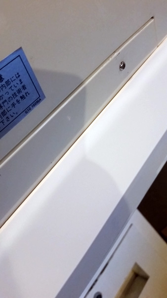

one piece of the header I didn't remove was the illuminated "EGRET 29" banner. this is held in with little plastic tabs. I gently pushed one back and heard the brittle plastic crack so I opted to just leave it in and clean in place.
One thing I've noticed on other cabs is that light leaks through these tabs leaving bright spots on the resultant logo when lit up... so after cleaning I decided to cover them with some electrical tape to block the light over the tabs:
The result is much more even light output along the parameter, the photo doesn't do it justice:

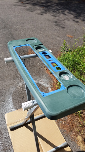

While getting rid of the Yellow is a big step towards improving the cab's cosmetics and even bigger step fixing the horribly faded blue control panel... here's how bad the thing was:
The Blue had faded so bad it turned Dark Green! you can see the contrast in the plastic that was covered up by the metal panels. Then you have horribly marred surface from cigarettes being put out on it. and then the cracks that go all the way through all over the place. The thing was actually held together by the metal panels that were bolted here.
I started off by taking a mini-air grinder that I normally use to grind rust off of cars and grid out the cigarette pock marks and then use some epoxy (JB weld brand) to bond the cracked areas back together.
The stench of grinding out the cigarette marks was terrible, like the ash was embedded in the plastic and I released it when grinding <X
After that I used a small amount of bondo to fill them back in:
And then I went hunting for Blue Paint... managed to find a pretty much perfect match with A light blue Rustoleum:
Sanded down the bondo as well as the epoxy and then gave the whole piece a light sanding before painting
Fixing this single part probably improved the looks of this cab more than anything else.

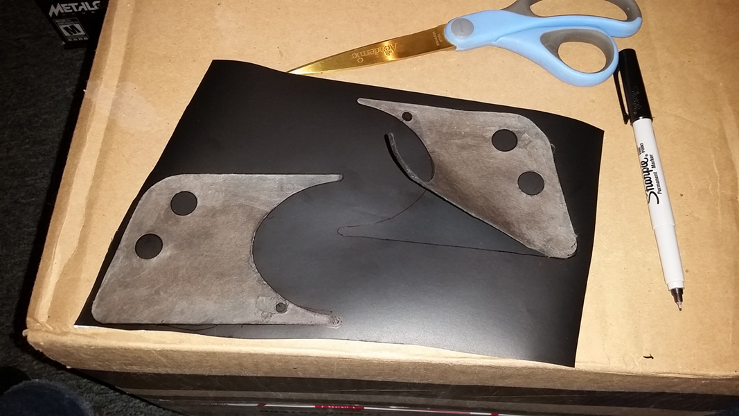

the Speakers also had a black paper material stuck too the inside to black out the area under the grill (you can see this a few posts above). I removed this when painting they came off in one piece but I decided to use them as a template to make fresh black out stickers from the vinyl wrap:
it's not perfect but the imperfections aren't visible once the grill is installed. If I ever get around to buying a vinyl cutter I'll draw up a template and cut a few perfect ones.
