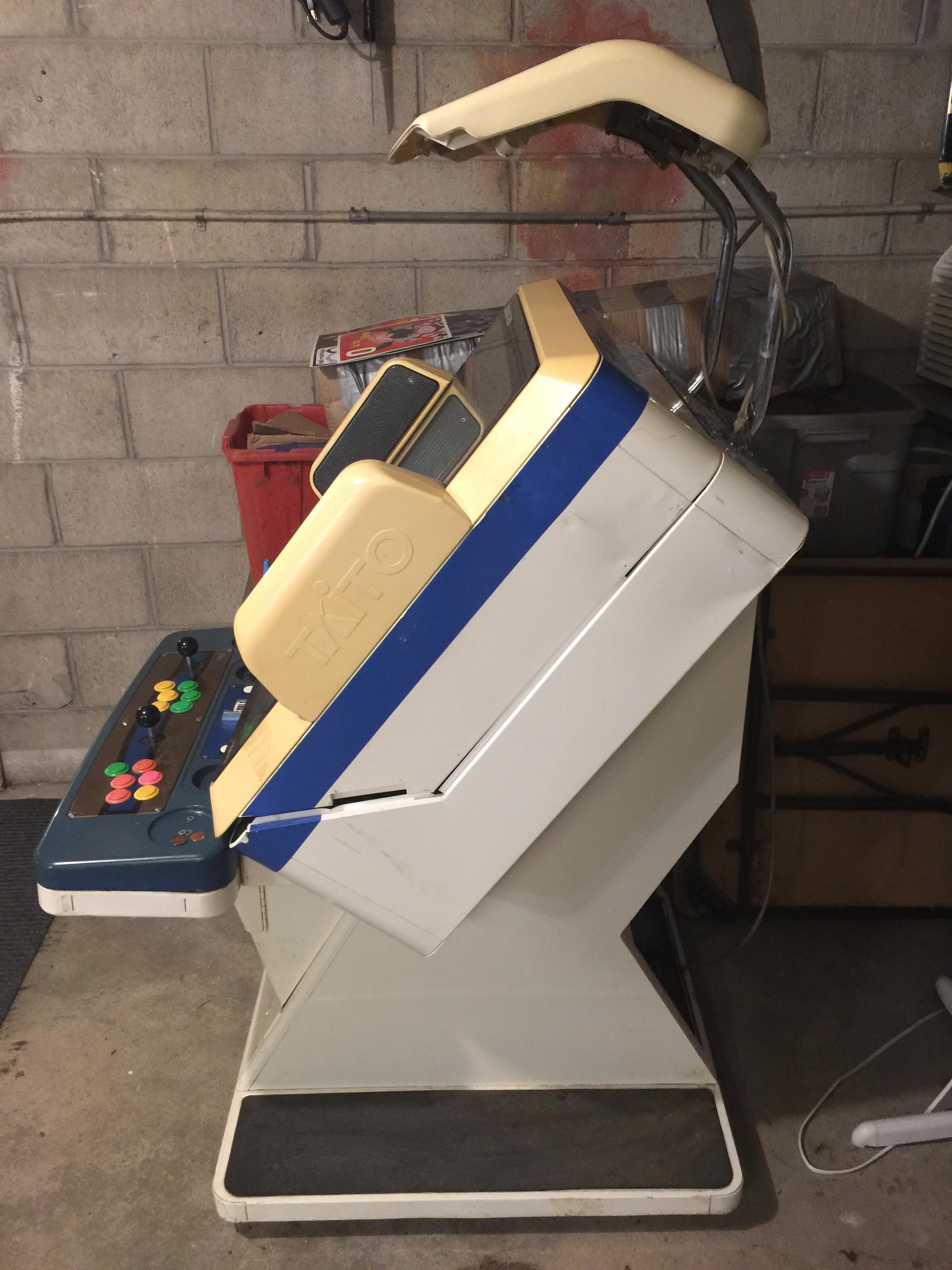

I'm not going to create a whole separate thread but I recently finished the restoration on my 2nd Egret 29... some of you know my "saga" with getting the monitor chassis repaired.
This E29 was dropped on its head while being unloaded off of a truck, this resulted in the whole header getting folded down, this bent the polished metal posts that hold up the header, it bent the metal frame of the header itself, including folding one of the speakers like a taco, and it snapped all 12 screw posts off of the lower black plastic part of the header... not to mention messing up the body of the cab as well.
Here are the pictures from the seller before I bought it:
[click to expand the photos, you can't see the bent header in the thumbnails]
I built myself a special tool to straighten out the metal posts, and did some other unique fixes to repair the lower black plastic piece (I might write a blog post about this at some point) but other than that most of the restoration was similar to the other cab.

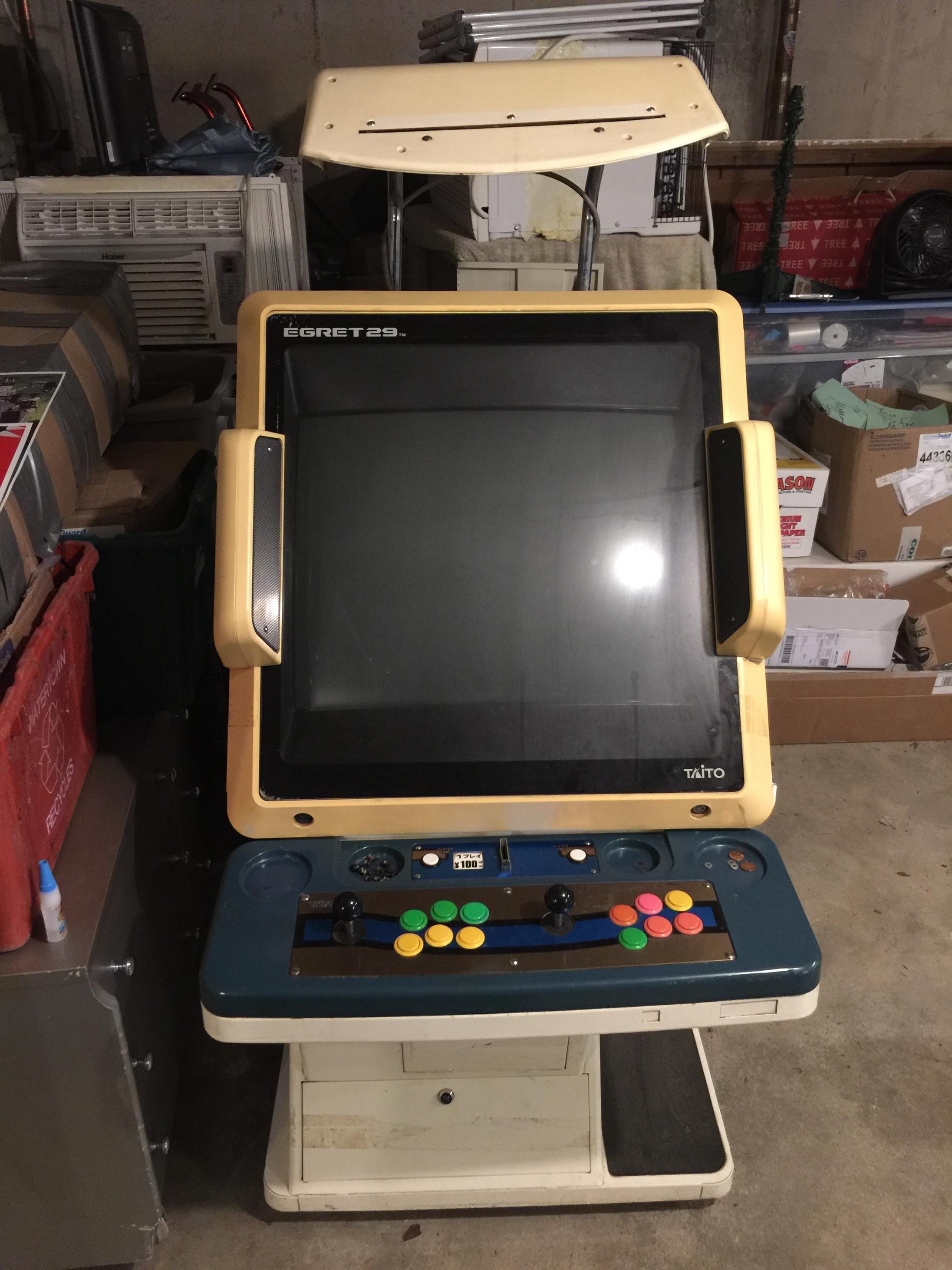

Here is the cab as it sits currently:
You might notice that it's got the 4-button panel, that's because I swapped panels with the 1st E29. I do still need to source some lock parts and I have a cracked marquee holder that I need to repair, but other than that it's done :)

WOW! That looks great. I really like the way plastic bezel came out. Mine is badly yellowed like yours was. I see you used vinyl dye for it. Is that a spray paint? I would love to get mine looking like that. Im still missing a lot with cab but it currently does work and getting rid of yellowing would make it look much better.

The dye comes in spray cans, does an awesome job.

As @Derick2k said it's a vinyl dye in a spray can. just like spray paint you need to be careful not to over spray or you'll get runs, you also need to do lots of light coats. It is A LOT more forgiving than spray paint though and it requires no sanding prep. I also didn't use any primer. I probably went through 3 or so cans per cab and that's just for the parts around the monitor and the top half of the header. The blue on the control panel is regular Spray Paint
Which color dye did you use?
Dupli-Color EHVP10500 Gloss White Vinyl Dye: https://www.amazon.com/dp/B00098PO22/ref=twister_B00BW1WSYC?_encoding=UTF8&th=1
The Blue on the control panel is Rustoleum brand spray paint I don't know the model number because I literally went to the store and bought a bunch of blues brought them home and did some test sprays to see which one was the best match.

I was super worried that the cab that had been dropped on it's head wouldn't have the header line up with the other cab... come to find out they are a little off but only because the the one I fixed is perfect and the other one is slightly drooped from age.
