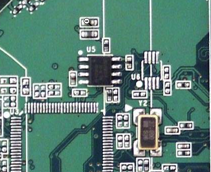

do you have any information on this you can share? I see a whole lot of BGA chips on this thing and not much else.
this would be my guess

This is actually the second one I've bought since the first one displayed bad pixels all over the screen. I suppose I could remove the chip from that and install it on the bricked card to see if that revives it. I did also order the programmer cable that atrfate posted, but coming from China it will probably be a few weeks before it gets here.

I got the programming cable in that @artfate suggested, reading the suggested U5 IC was very flakey, it would often not get a complete read and the best read I got from it didn't seem to match the firmware.
Attempt #4
Since card #1 had the right firmware on it but had bad graphics and card #2 was bricked I decided to swap the U5 IC that artfate suggested held the firmware. I did a complete swap between the two cards and ... no change. card #1 still has the elsa firmware and still boots, and card #2 is still bricked... so I'm inclined to believe that U5 does not hold the firmware .
