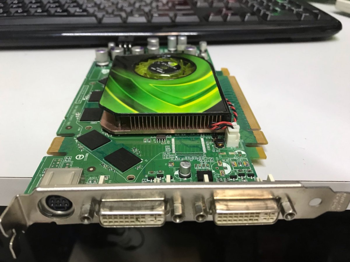

Hello guys, I just received my first TTX2, the courier (UPS) miscarried the package and affected the rear panel of the TTX2, the frame was a little bent but nothing really bad, but I noticed the video card bracket slightly got some of the residual stress of the cabinet frame, any ways when I started the TTX2 I got 3 beeps, after investigation I knew it was the video card, upon removal and using onboard vga, it started normally but as expected no games ran, only the selection menu. Any ways, after looking for the type of video card I found it is an NVIDIA QUADRO FX3500 based on the number printed on the card. I also tried the card on my PC and got the same 3 beeps.
I will really appreciate if you can help me out with my questions .
1. Do you know how to solve the 3 beeps problem? Maybe something that needs to be replaced on the card like capacitors? Or maybe a reflash will solve it?
2. I found and NVIDIA QUADRO FX3800, does it will work as a replacement? Because I am not able to find a 7900gs locally nor FX3500.
Thanks in advance!
3 beeps sound like a memory error, possibly a VRAM issue on the Graphics card? Do you happen to see any other damage on the card?
Do you have a photo of the card the board came with?
You need a 7900GS or equivalent to run the games on the multi. Neither of the other cards you mentioned will work. You can easily find these cards on ebay for around $30. If it's an issue with buying from/shipping to Mexico, PM me and I might be able to help you out.

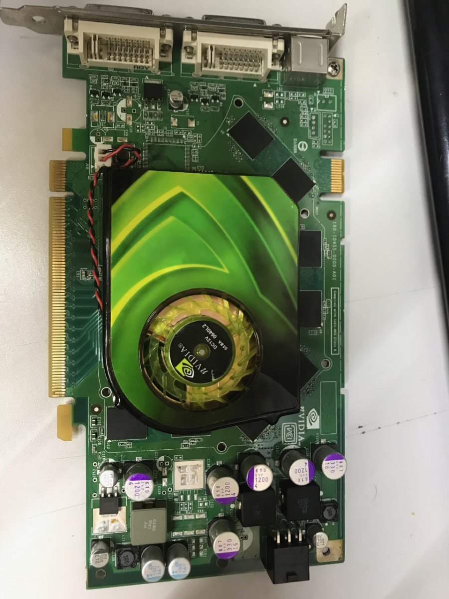

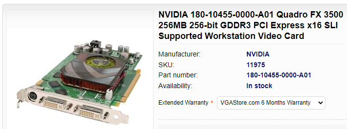

Here are the photos of my TTX2 Nvidia Card, on the last photo are the numbers that refered me as NVIDIA QUADRO FX3500

I did a quick Google search and it does seem like it's equivalent to a 7900GS. It should work once you flash it with the BIOS from the 1st post in this thread.
Let us know how it goes!
The one in the photos above is the card that came with my TTX2, i will try to re flashed as indicated, reading in other forums it appears that will fix the card not being recognized and giving the long beep and 3 short beeps. I will keep you posted.
Thank you!
Let us know how it goes. There is still a chance that the card was damaged because it should still get detected both on your TX2 and your PC, the fact that it is giving you errors on both really makes me think it is broken. Sorry, didn't catch that this was the same card we were talking about the entire time.

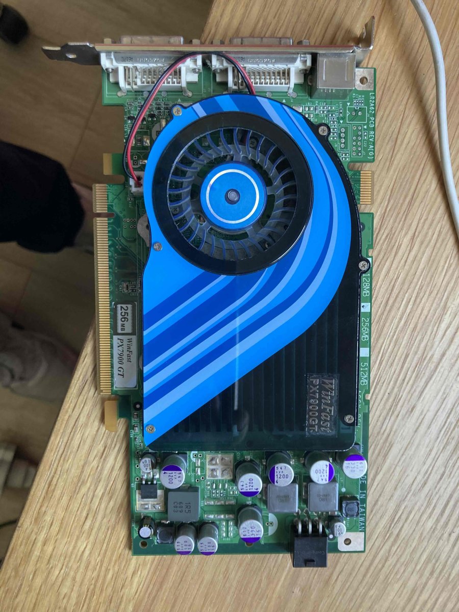

Hi guys,
I'm going to be nut with this one :) :

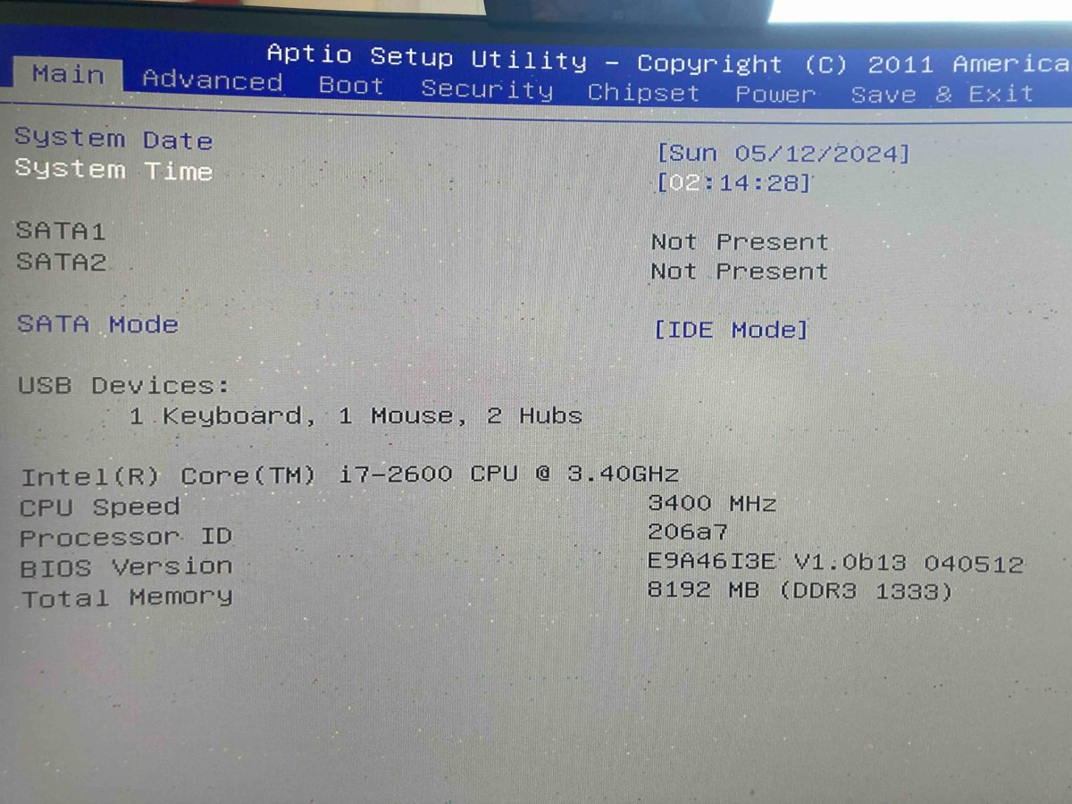

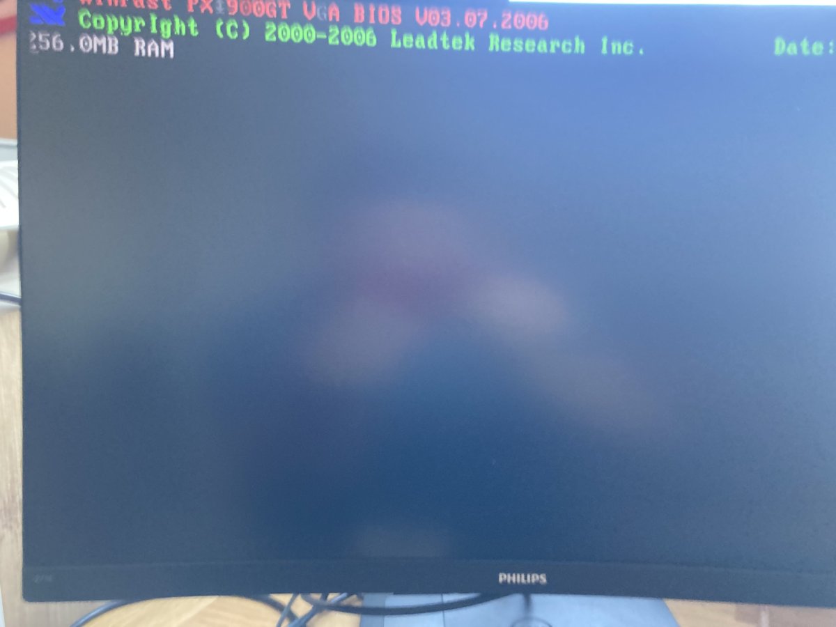

I've buy a Leadtek 7900GT to upgrade my Taito Type X2 and in order to change it with esla Bios.
I don't have computer so I planned to use my type X3 to update the bios with link at page one but ... (there is always a but) :
- at the first boot of the card in my Type X3 it seems the screen have some bugs, at freedos the text is wierd, for example "TypeX2" is written "TGpEX(" and some lettre are in color and others not.
- netherless I do the method for upload the change bios to Elsa. It update the bios but at the end all the bug problems are the same. (there is some pictures enclosed).
- i've contacted the seller and he told me everything was fine at his home.
Do you have an idea of the problem? card is totally broken? Thanks a lot for your answers

Pretty sure the card is defective.
