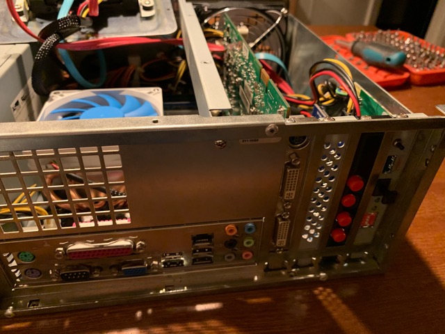

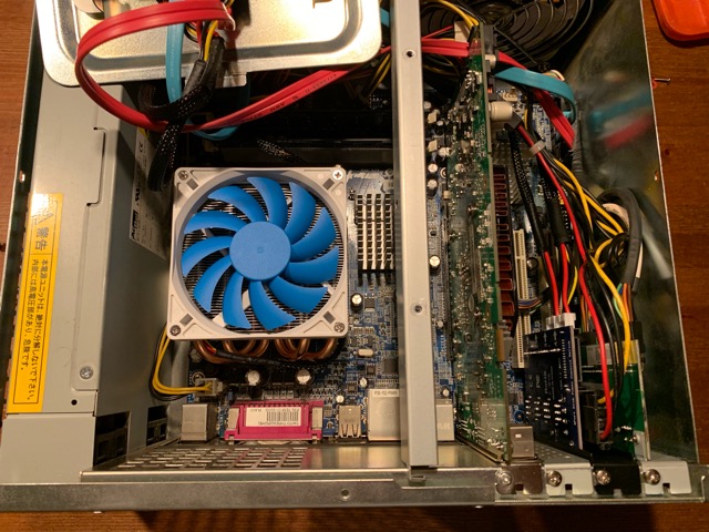

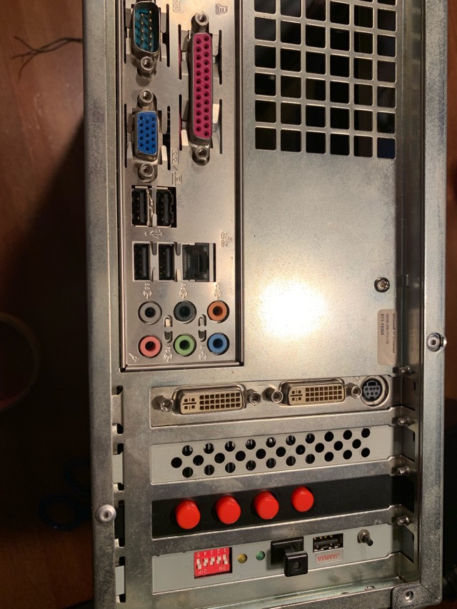

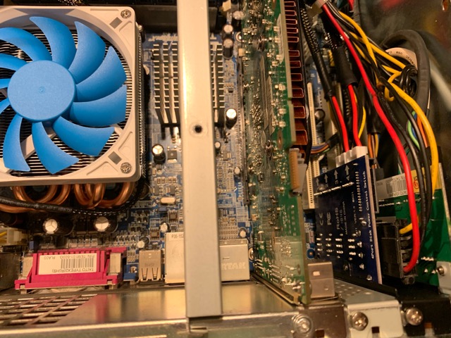

I've been thinking for some time about installing 2 SSD hard disks in my TTX2.
I wanted to use one SSD on Nicos Image And on the other SSD have the image of Jörg on it.
So I bought a hard disk switch.Simply insert it into a free slot of my TTX2, connect both hard disks and you're done.
Of course I can't run both at once.
So if I want to play Nicos SSD just switch on switch 1.With Jörg his image switch 1 off and switch 2 on.That's all.Works very well.On this occasion I also exchanged all fans for quiet ones.
Now everything is perfect.
Simple but ingenious.
