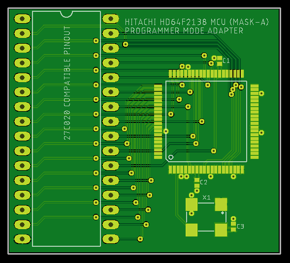

@brizzo on the photo is F2138AFA20V H8S/2138A
Thanks @MetalliC . What a monster of a datasheets for this series; over 1300 pages. Confirmed flash based part. I agree no restrictions/protection on flash read back after reading through relevant parts of datasheet.
"Flash Memory Programmer Mode" outlined in section 22.10 of datasheet explains viable method to read internal memory to external device. Would require making a custom pcb adapter (like we used for Toaplan games with HD647180 mcu), desoldering chip, soldering to adapter and dumping internal memory contents. In theory the code contains a boot loader for in-system updates, but we would need to dump it the hard way before we could do in-system programming the easy way (vial usb serial cable).

Spent a couple hours whipping this up; the adapter board required to dump MCU. In theory this will work as per the datasheet :D
