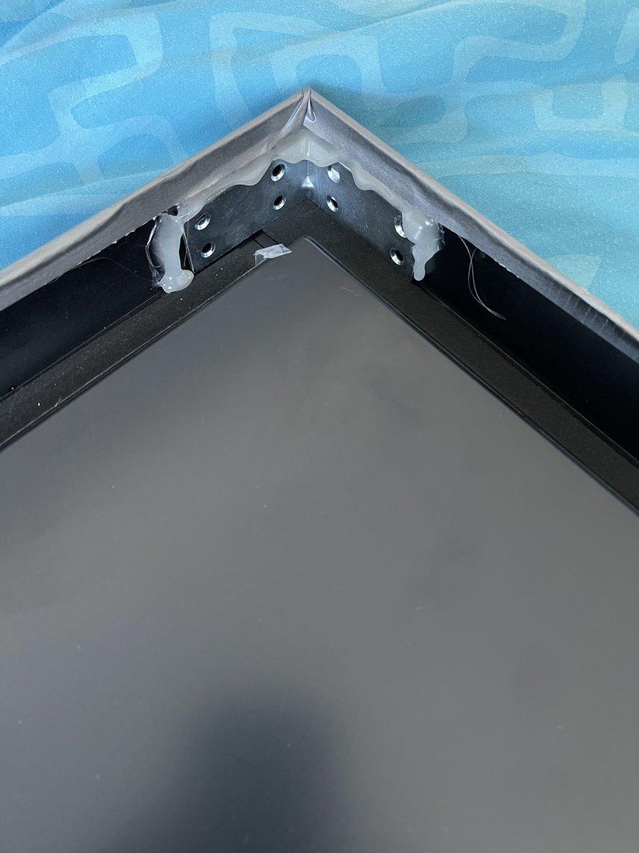

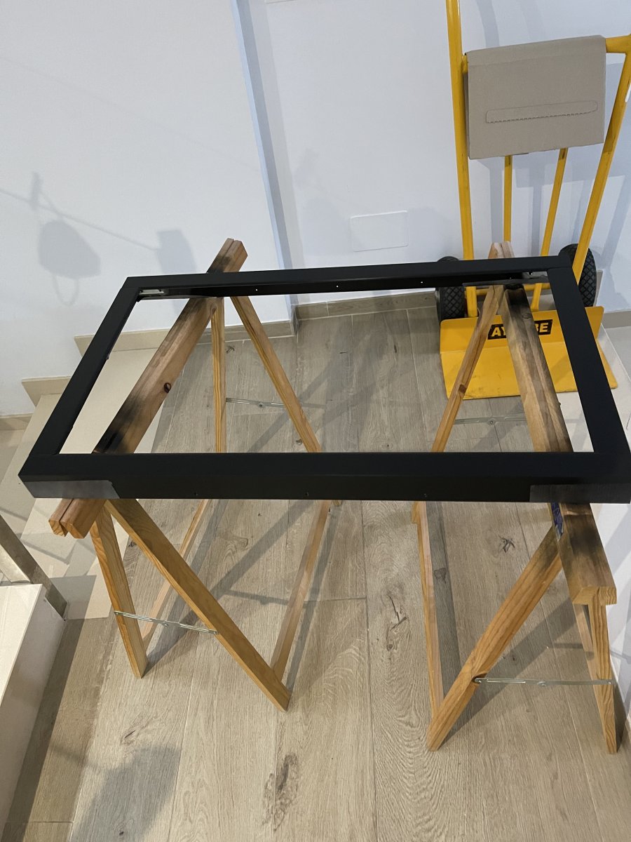

Here you have some photos

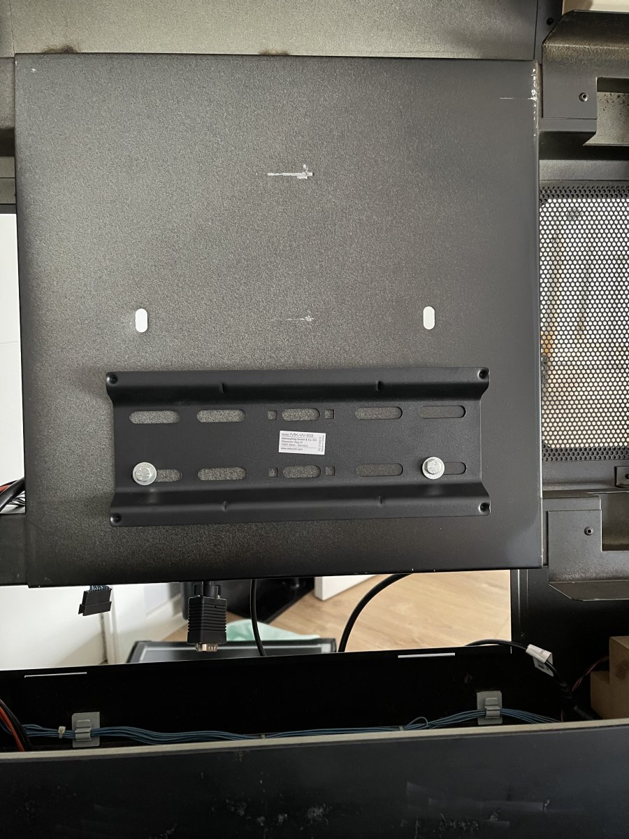

This plate, fit in down holes:

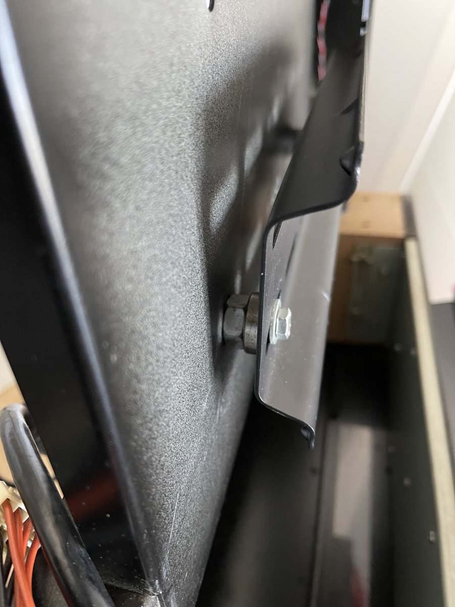

This 2 legs into the monitor

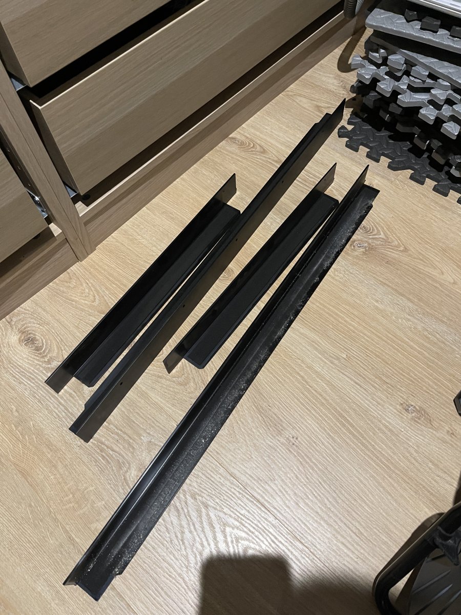

Put 2 spacers between the plate and the machine
Then, some hot silicone in the frame and a metal support to stick them together
And for the ugly golden color in the frame, some black paint
And put all together in the vewlix

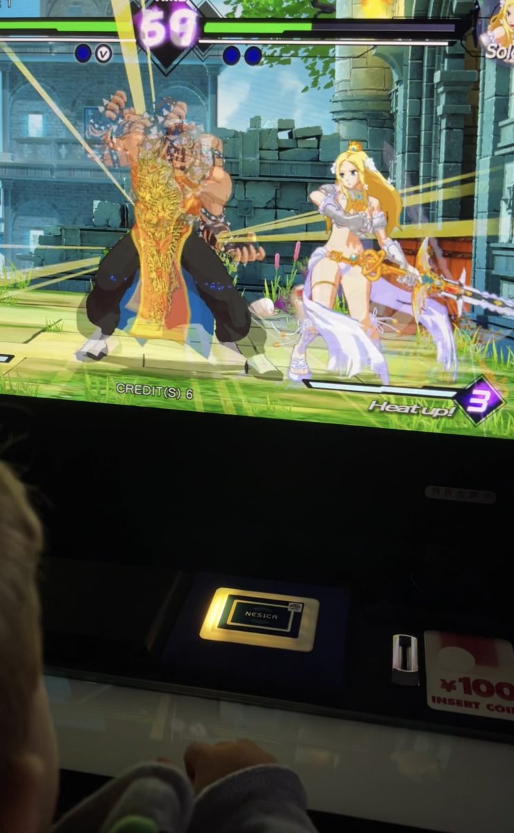

Happy children playing xD
It needs some adjustments, but basically the most tedious thing is already done

Need some adjustments, but fits better than I expected. I'm fighting with the resolutions and some other things, but in general everything has gone very well.

How did you attach the black frame to the monitor?

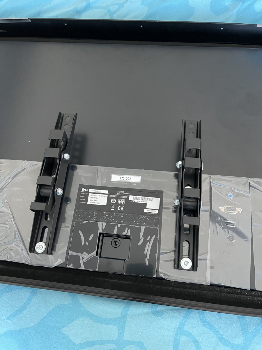

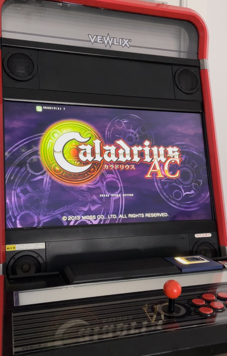

To close this topic, I tell you that in the end I changed the monitor for an LG. The reasons have been several, but the most important is that in the Shipment, they broke it. The machine was sent standing, and it came to me lying down and with some damaged parts. The parts had easy repair, some hot silicone here and there and no one can say they were damaged. The monitor, I sent it to technical service and they told me they needed a new lighting panel.
Being practical, I have preferred to replace it with an LG monitor and finished matter. Replacing the monitor has been pretty easy. At first I was tempted to buy the adapter you recommended, but right now the issue of customs, imports, fees ... almost doubles the price.
I set out to try to make a homemade solution and I was thinking about it a lot. By chance, looking at monitors on amazon, they suggested a wall adapter for LG monitors. Staring at one, which was just what I planned to make... I decided to buy it, since for 12 dollars or 10 euros ... what could I lose?
It's just been Plug and Play. I already have everything installed and working. Then I will update with photos.
