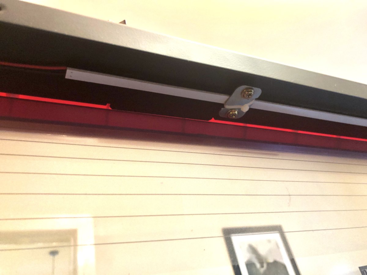

Worth a shot, not all edgelit acrylic is the same. The piece that looks beat up in my pics on the orange is a repro i made years and was the one that most closely matched the original out of the ones I tested back then. There may be others that work.

If someone wants to open their chewlix and verify the mounting bracket for the leds is there, we can see if it works. Plus I think on the chewlixs they just straight solder an led strip in there.
they actually zip tie it
