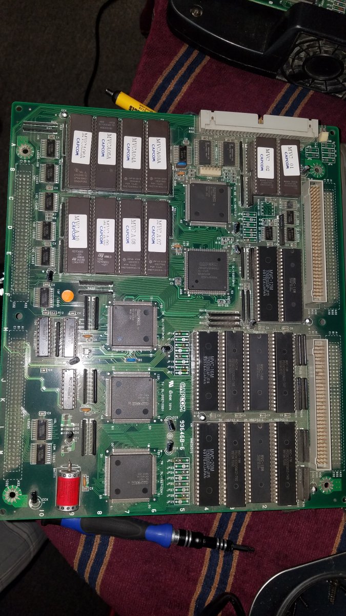

Hi yo, I need someone's professional opinion, I have two Gray MvC donors for darksoft multi, but they are revision 6. Is 6 good or should I get a revision 7?
Both board's have the BGSB3G how ever the jumpers are different? They are the same game from the same region, so I'm not sure why the jumpers are different. Anyhow I was hoping to do a easy install but now I'm worried.

I have an issue where I try to start a game but after I get the All done: Have fun! message, the screen stays white. Does anyone know what could be the issue? I'm using a X-Men vs Street Fighter CPS2 that was working previously. I don't have another A or B board to test with. The testing romset that Darksoft provided in the op worked fine and I shorted EXC5 multiple times using a flat-head screwdrive while there is power on. I'm using the Decryption pack listed in the CPS2_ChampionMulti_Guide_v1.3.pdf in a 16 GB card from HighScore that was formatted as FAT-32 using SD Card Formatter tool.
It’s either an issue with key writing or main program ROMs
Looks like your key writing wires aren’t connected? Is that connector populated?
If the key writing wires aren’t connected you will need to run the decrypted set or connect them
