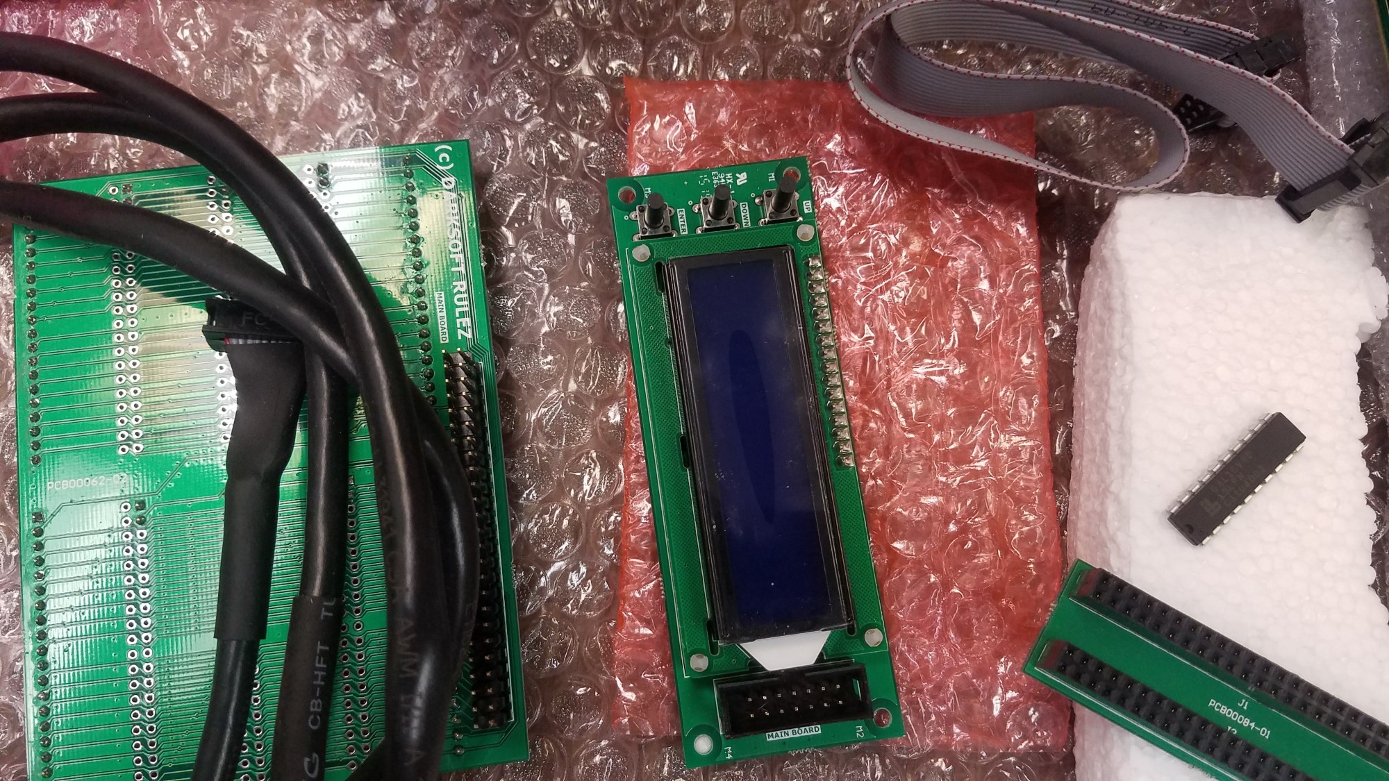

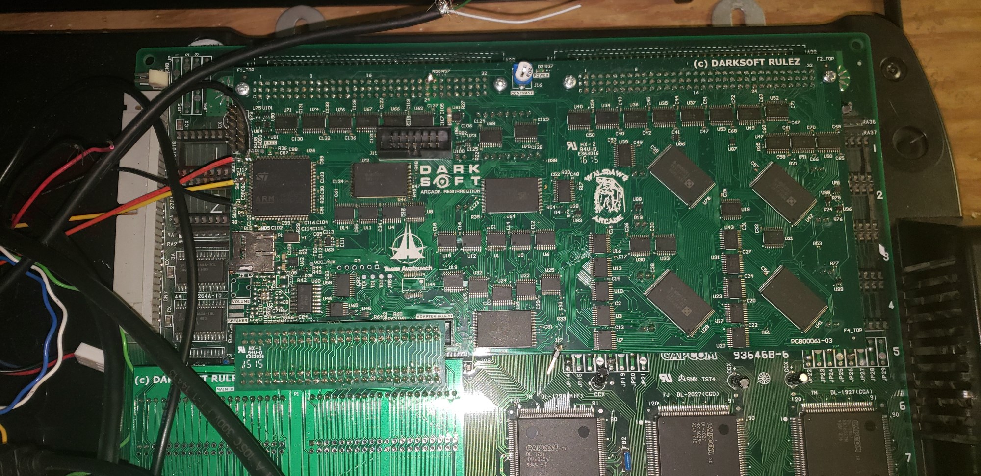

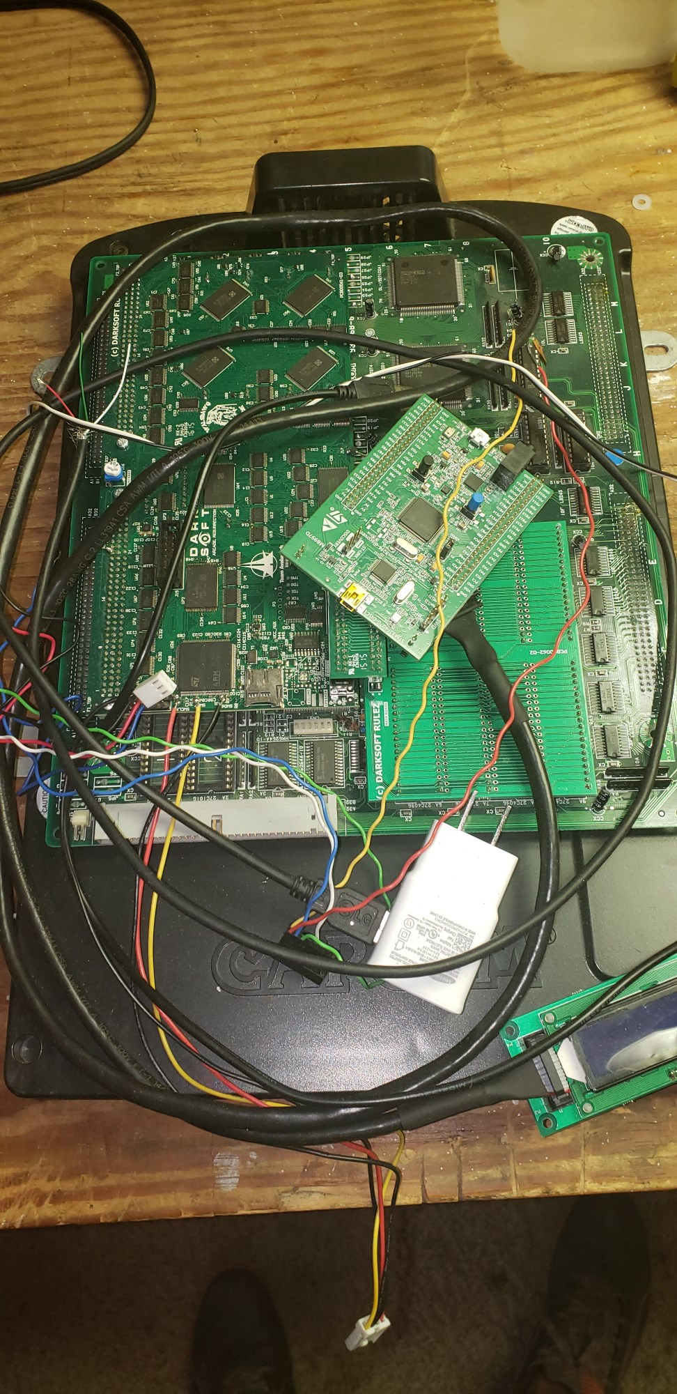

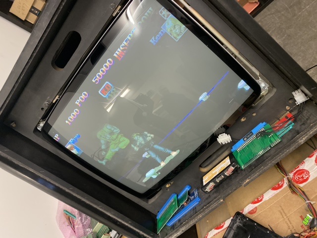

just did my second DS kit install tonight on a Jap 1944 Loopmaster worked first time! I remembered the jumper trick (ensure each pair of jumpers has one closed one open) and it worked, without really following the jumper guide outlined in the PDF install notes. This CPS2 board had a much nicer/cleaner case and a fresher PCB than my other, so I'll sell that one sometime.

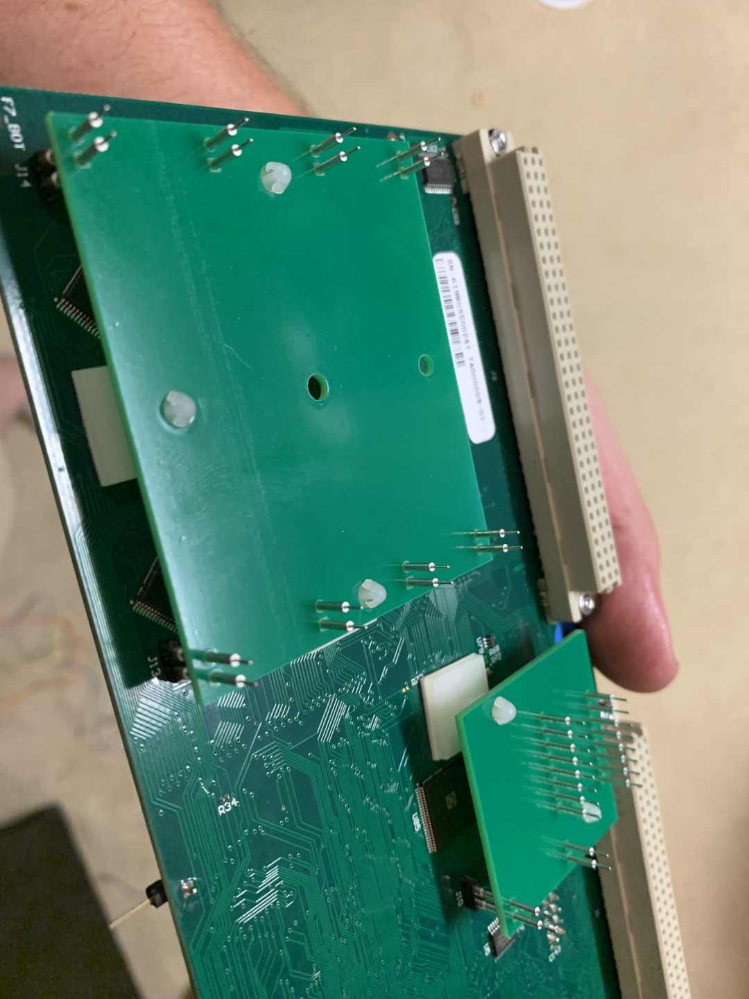

Hi guys
installed my second CPS2 kit today
no hikkuos
tho i did use the stock PAL3 (revision4) pin 9 to J17
games load fine
but its like the forground and some sprites are missing :S
ive checked all sockets and all pins are seated nicely
games run ok apart from the missing gfp/sprites
anyone any ideas please
thanks
dave

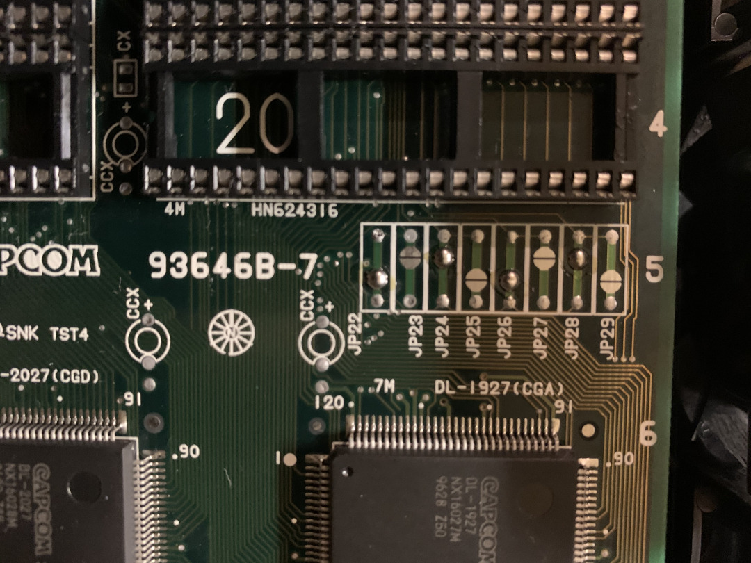

Here are a couple of pics
Are the blobs right
I followed The install pdf and the youtube from a year ago
thanks

The 4 screws/pegs that secure the b-board pcb might not be holding it as tightly as the other case. Sometimes those pegs get broken off as well.This allows it to flex when mating with the A-board resulting in a bad connection.

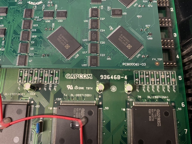

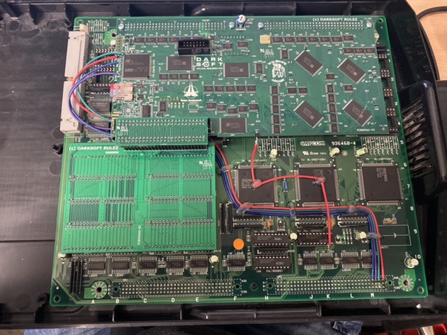

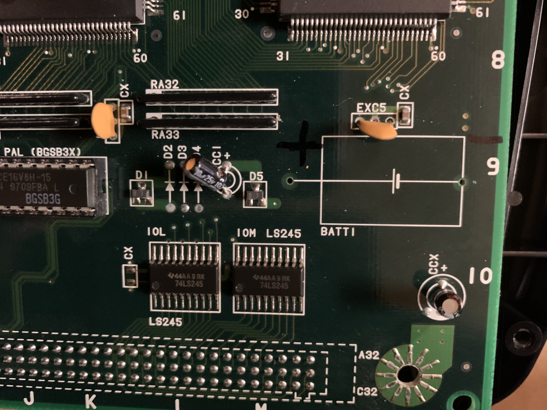

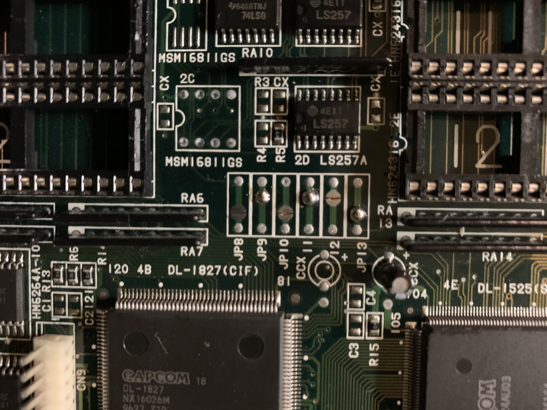

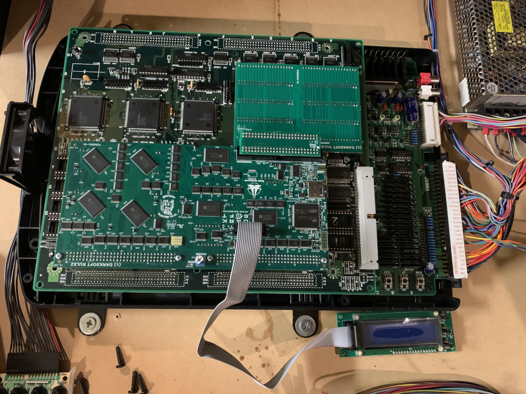

Hi all, I'm having trouble with my CPS2 Multi Kit which I just purchased from highscoresaves. The LCD shows that the games are loading and the keys are being written. Then it gives me the "Have fun" message. Initially, the screen would turn black while flashing, and then it would turn green. Now the screen just stays green while flashing. The only change I can get is when I thoroughly discharge the EXC5, the screen will turn blue. Then when I power cycle the machine, it goes back to green. Let me start by saying that I have thoroughly searched through every thread I can find about the subject and watched every video I can find. I have tried every possible solution that I have found. I have also meticulously gone through the install instructions and the Definitive Guide to Fixing the CPS2 Multi Kit. I really don't want to have to send this thing off to be looked at or repaired, but it seems like that is going to be the only option. Here is the process that I have gone through.
I started with working A and B boards and I removed the battery and all of the socketed chips. The B board is a revision 7 and had a PAL G installed on it.
Discharged EXC5 as well as CCI.
Installed key writing wires and used the encrypted rom set from arcade projects roll up pack.
Checked multiple times that key writing wires installed correctly.
Removed the key writing wires (pads look good and intact), used decrypted rom set from Avalaunch.
Checked all pins on kit, none bent, all making contact with board below. Verified with multi meter.
Checked multiple times to make sure interconnect board installed correctly. (RU symbol toward the left or JAMMA connection).
Removed and reseated the kit several times.
Tried 3 different SD cards formatted FAT32 and copying all files in one action using Windows 10 machine. 8GB Sandisk which came with the kit, 16GB Sandisk Ultra and 32GB Sandisk Ultra.
Re-intalled firmware on kit.
Not using a MAC.
Tried installing the boards back into case and using clips to hold the cases together.
Tried switching out the PALG with one that I ordered with the kit.
Checked all dip switches for connection and verified with multi meter continuity. All dip switches are set correctly according to the guide.
The only thing I can think of is that either the kit did not work from the get go, or I damaged on of the surface mount components when installing the key writing wires or the A or B board has stopped working.

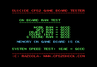

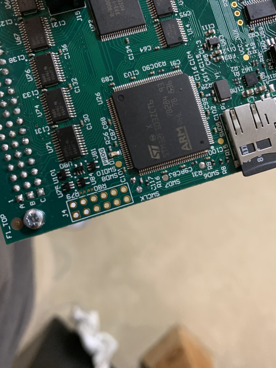

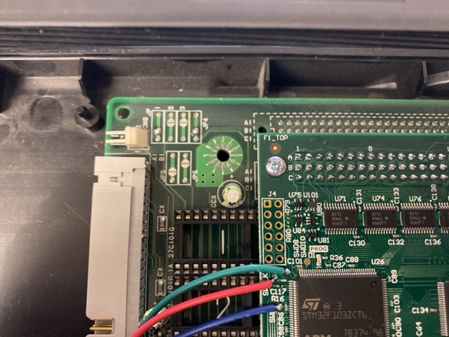

Here are some photos of the installation. Also I tried using the suicide game board testor rom file burned onto an eprom which gave me the status screen pictured below with the exception of the SOUND INIT being BAD. I assumed it was bad because eproms 1 and 2 were not installed. Would this indicate that the A and B board were functioning correctly?
Thanks in advance for any assistance.
