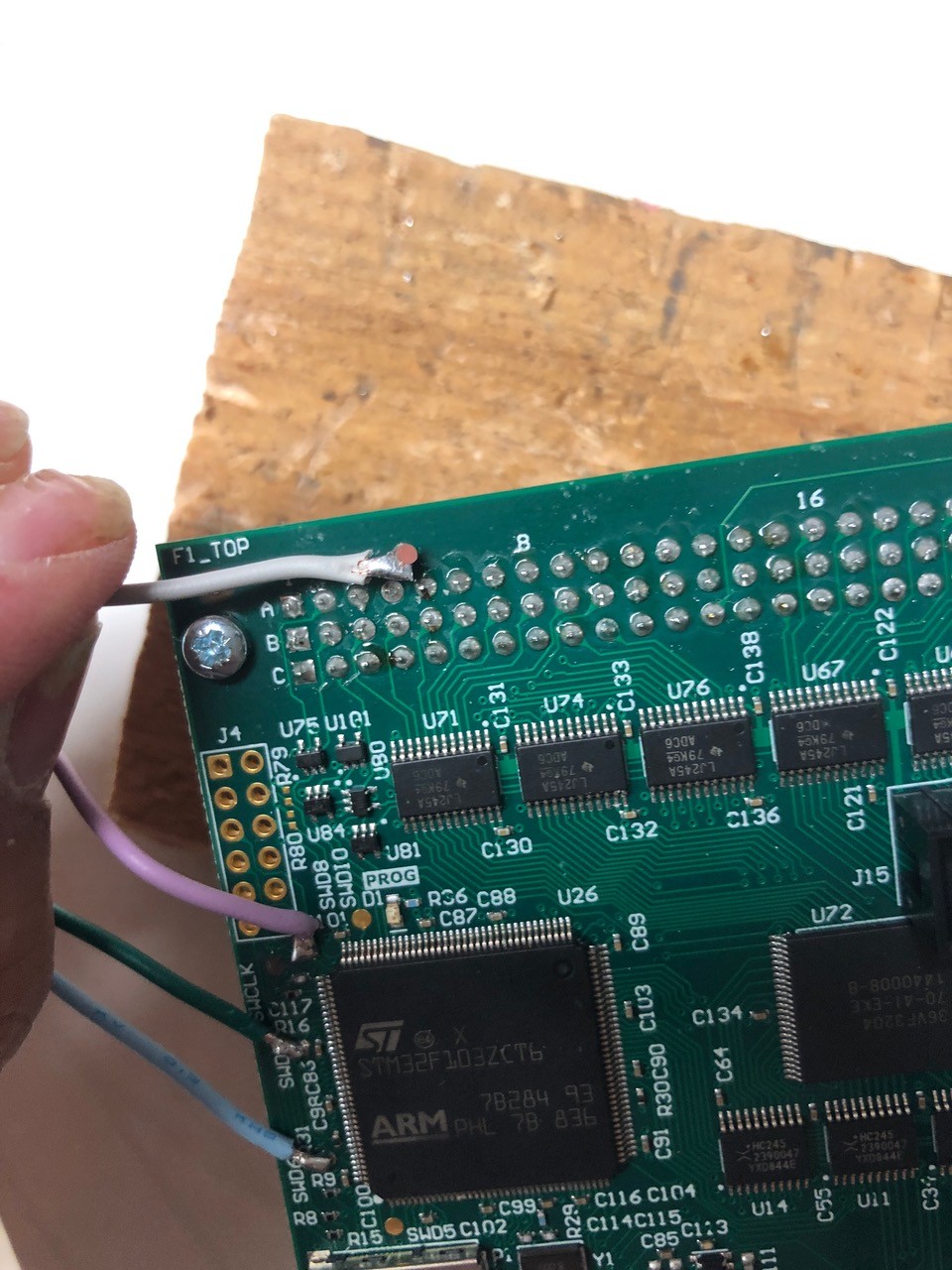

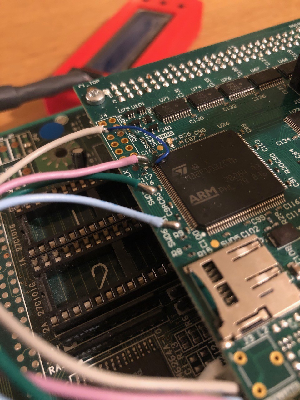

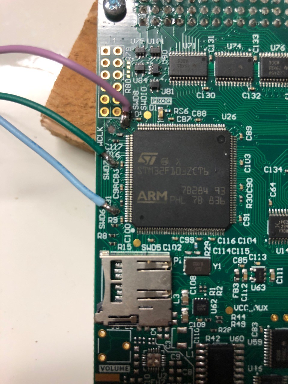

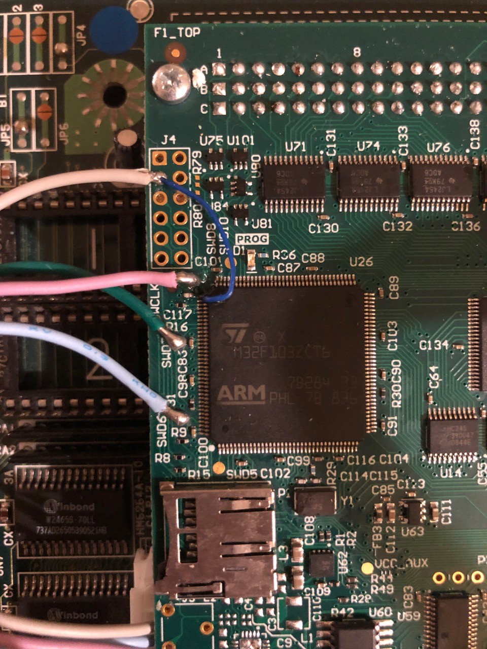

Hi everyone,
I installed my multi kit and it worked great for maybe 10-15 minutes when I was testing it out. Came back a few hours later to play and the sound was all wonky, still recognizable but playing the wrong sounds at the right time.
I’ve uninstalled and reinstalled and checked for broken pins but I can’t find anything wrong. I’m running a rev 4 with a g pal. Where should I start?
I noticed people talking about jumpers before, but the second step is literally “there is no need to modify the jumper configuration”
Thanks
added photos of install
https://imgur.com/a/1o3ja1b

That could be a PAL issue or a problem with the multi or the jumpers not cut properyl. Even a bad microSD could load the contents bad to the microSD.
As you are US based, I would suggest that you get in touch with @Mitsurugi-w He can have a look and install it for you for a fee.
After looking at the pictures. It could be that the brown wire is connected directly to pin 9 of the PALG. Can you try lifting up the pin and soldering there?
Sure, I’ll give it a go right now.
Haha it worked! I should’ve just posted 2 months ago and saved myself the headache. Thanks so much!
