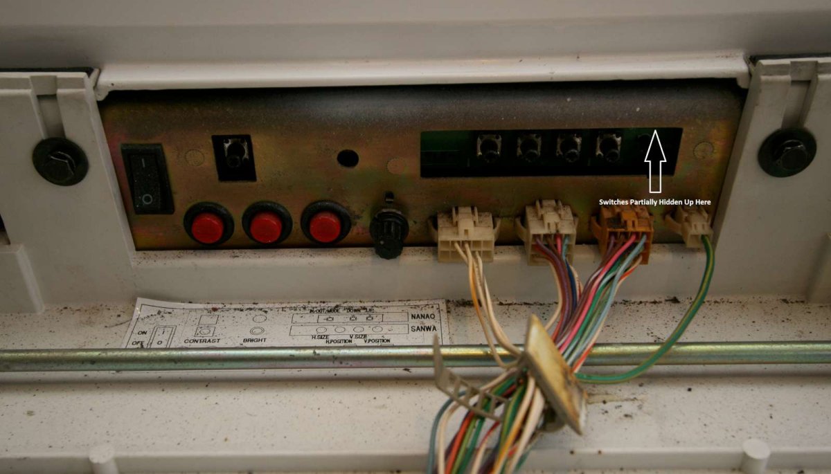

Below is an image I found when googling "Blast City remote board" it shows where the switch is on a MS-2930:
Yeah, it varies. One of mine switches automatically (2931) and the other has a board that sits under the bezel (2930).

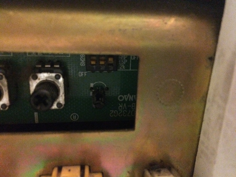

Hm ok, I *think* I have some dips right up in that area, @Metal Slug
I suppose I was thinking of a standard toggle switch rather than dips. It's kinda hard to see the switch so I'll need to do some yoga to get up in there :D

The dips can be flipped if you peer at them from the side. It's not too bad. It's the color drive pots that are completely inaccessible. If you ever want to calibrate the monitor, you have to take out not only the monitor but the remote too. That's annoying!
