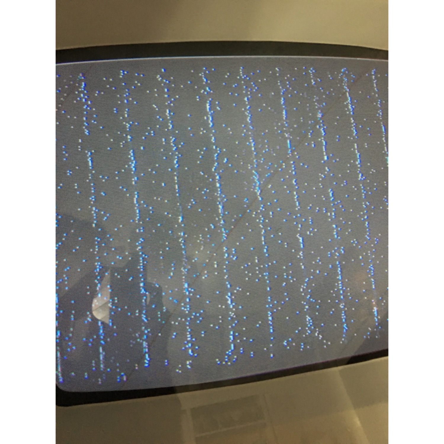

ANY version of Eco Fighters, doesn't matter which one, loads all the way to the warning screen, it then hangs on the warning screen just a bit too long and then crashes to a solid grey screen. Just before that there is a garbled checkerboard like static laden screen, then, all grey. If I reset it, it will once again boot, first a memory check, then the title screen, then the region copyright warning ... Then crash... Very frustrating. It will not allow me to enter test mode.
Managed to capture this just after it crashed, just before it goes grey. It's very fast. There is another garbled screen just before this one. Too quick to photograph. On a few occasions the game would hang on the warning screen and go no further.

That looks to me like a microSD problem. Try formating the card and copy the files in a single copy+past move.
