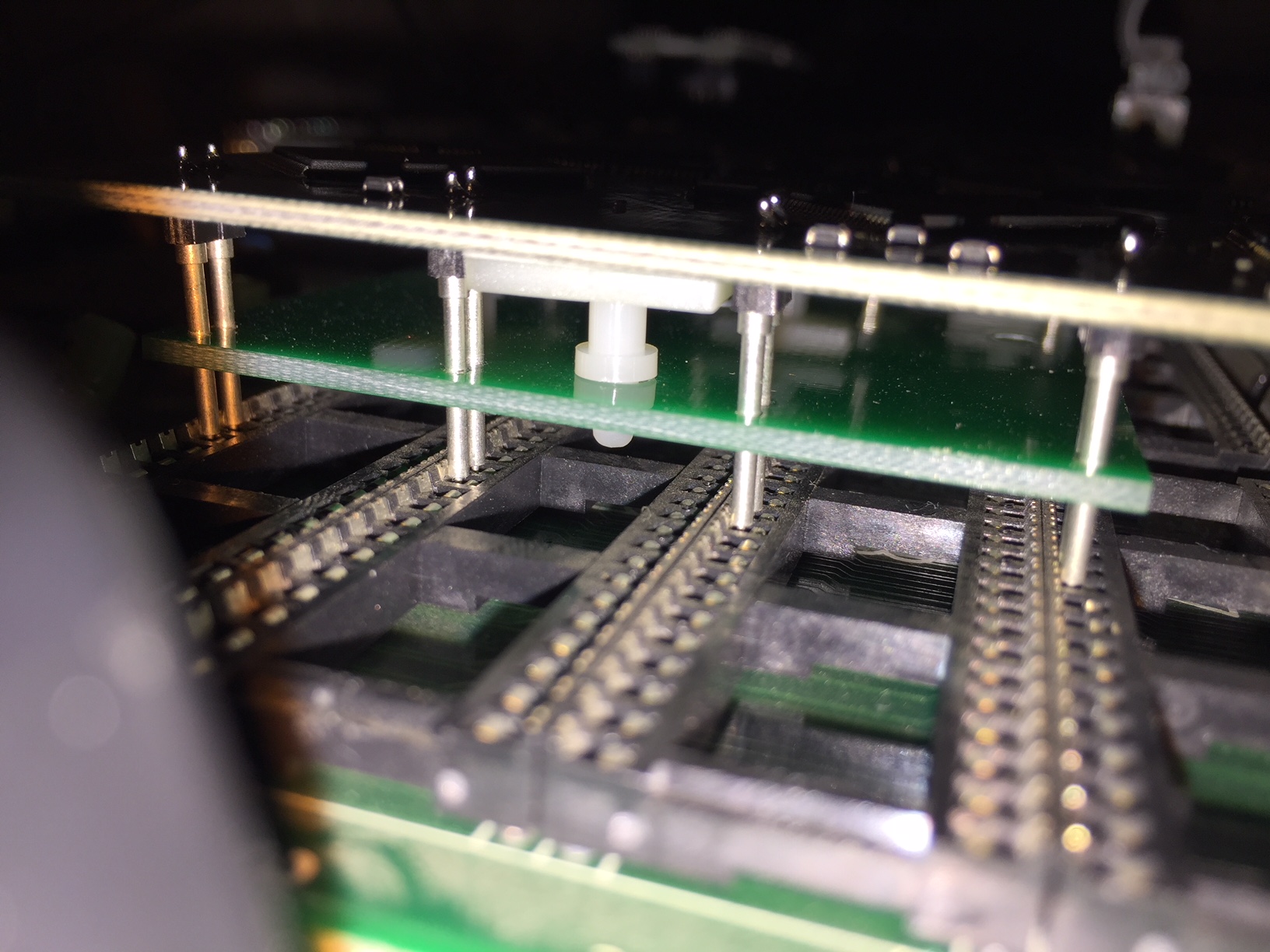

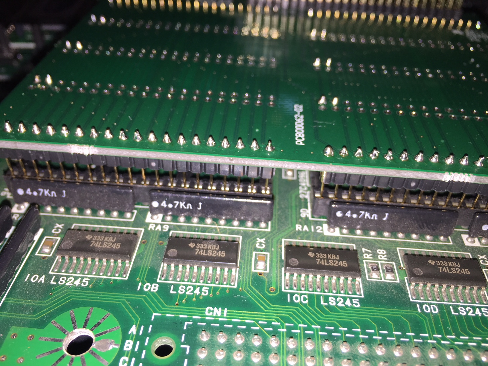

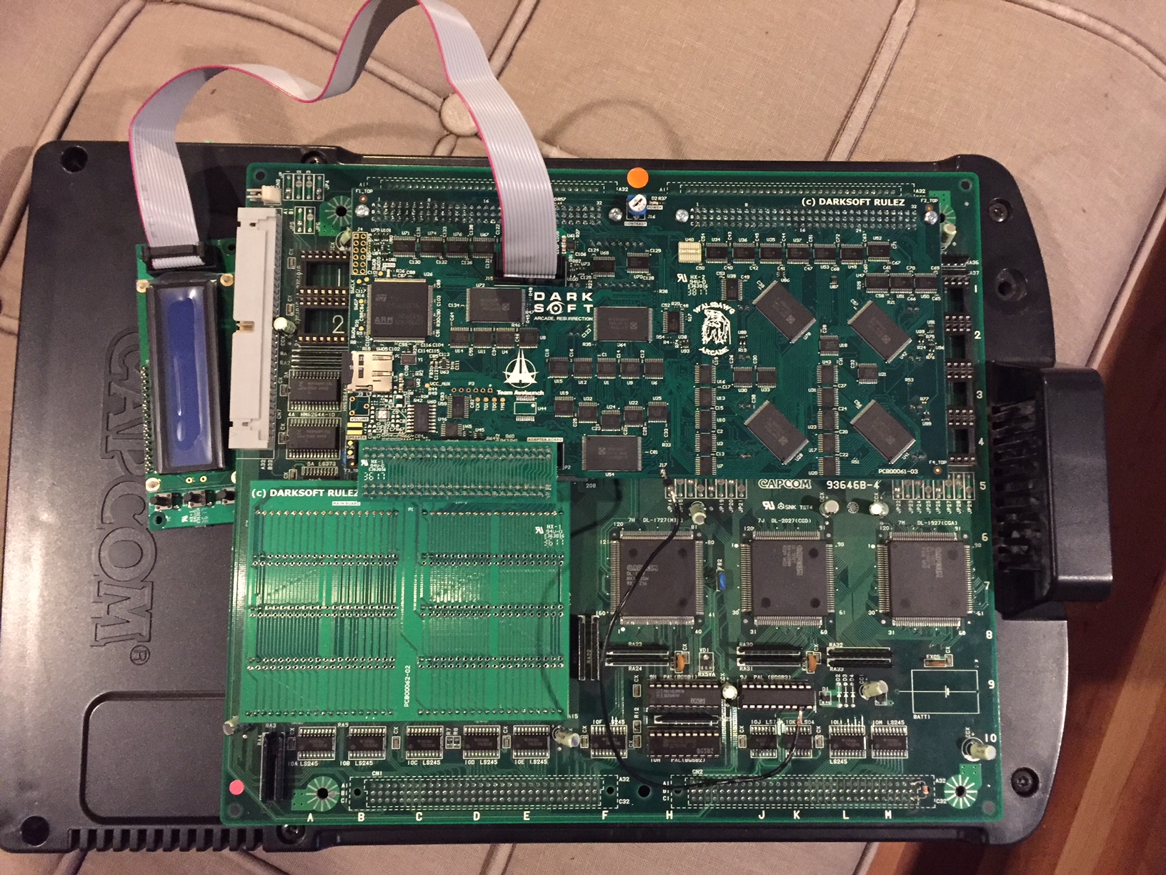

I'm having a lot of troubles with mine atm. Here are the details:
- Using a phoenix'd COTA rev 4 board (removed all Roms
- Sandisk 16GB board
- GPal
Games show up on the LCD but when I flash it, i get a solid gray screen. Checked connections and did continuity checks on the jumpers and they're fine.
I also can't seem to solder onto the reset pad, seems like the pad is ripped off on mine. Will the games still work if I just reboot my cab?
Please update your profile with your approx. location.
Also please post some pics of your setup. Normally a working LCD but one-color screen, means some kind of problem on the program rom side.
It can be related to improper sitting of the boards, broken pin or that you didnt shourcut EXC5 long enough.
Look forward to your pics and we take it from there.
Thanks!
Hi,
Appreciate the quick response from you. I attached the photos here. Let me know if you need me to take other photos. Thanks!

it looks good to me. Double check the tiny Pcb that joins the other two. Make sure it makes proper contact both from the top.and the bottom!
Besides that try reformatting the microsd and copy all files back again.
Last thing you can try is to short exc5 for 10 seconds. Make sure you short all 3 Pons of exc5.
Let us know how it.goes.
