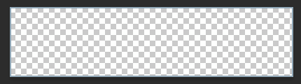

So, i have the photoshop border (that nice blue border around the outside.

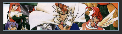

I have the flyer for hte game, which i got from launchbox

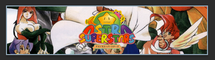

I have the logo which i got from launchbox
I paste the flyer layer behind the border layer, and i shrink it down to make it look sort of cool (keeping in mind the very middle graphics will be covered)
And then I paste the logo on top of that and resize it accordingly. DONE, wheel art
