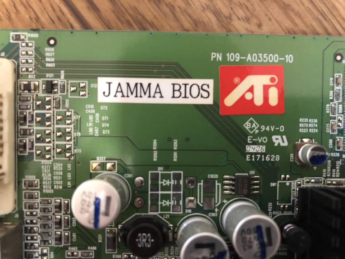

Well look at that...
Just popped up on YJP. Guess we’ll need to look into ATi bios tool...

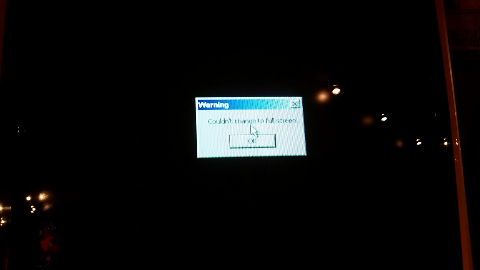

so running one of these cards with a consumer bios I get this:
I tried hooking up a mouse and keyboard to clear the dialog but they don't seem to work
I was afraid of that... I might have to see if I can unearth one somewhere.

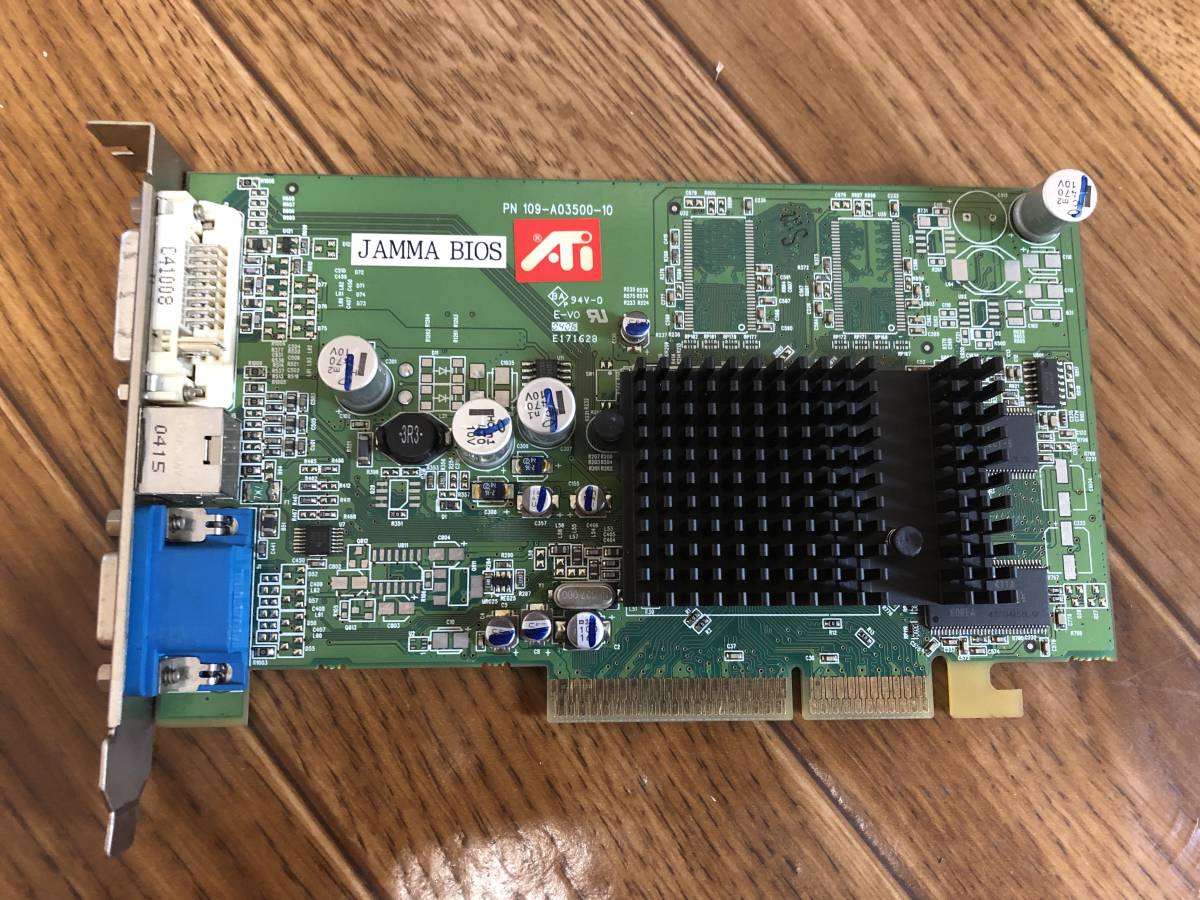

this is a 9600se gold. Which seems to be the version that uses the exact same pcb as the original taito card.

It may work if you install the latest video card drivers for your specific card.
the drivers are already on the disk image, the ATI GPU BIOS needs to be dumped and reflashed.

I am trying to dump the ATI BIOS (GPU) on my original TTX.
So far Rabit can see the card but cannot save BIOS.
I have used an older version of ATIFlash which runs on XP but which does not see any cards ?
Which tools do you use @penrhos ?
