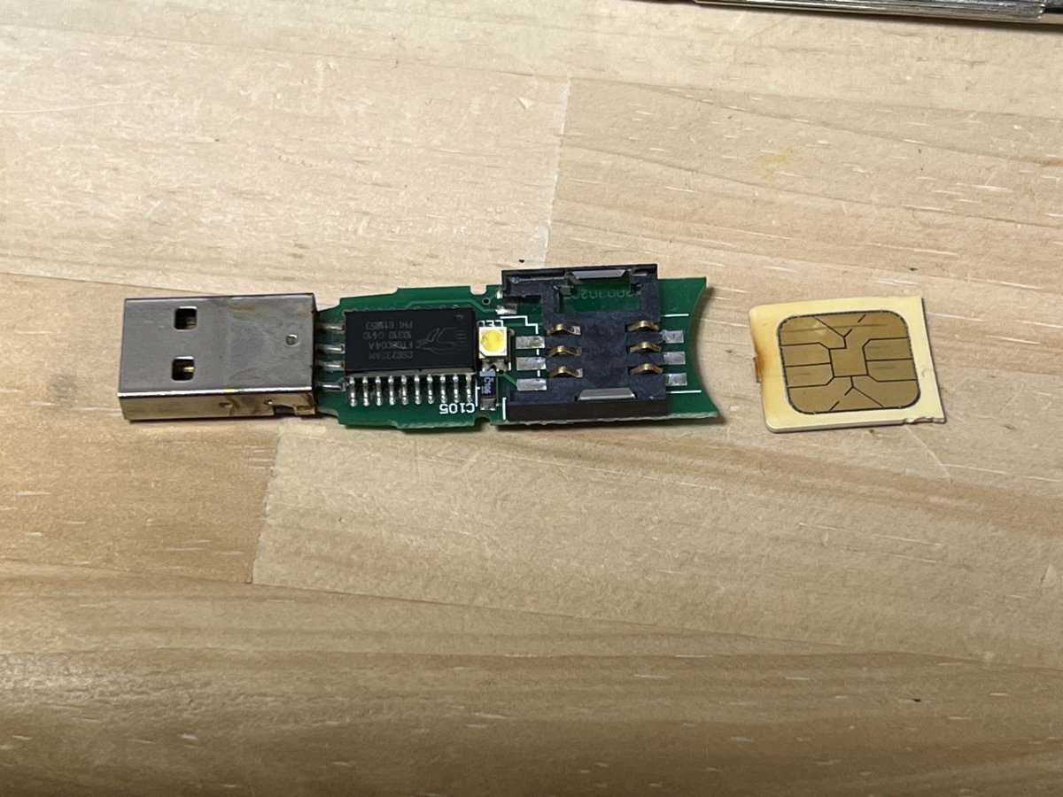

900 is that it can't read the security dongle. There's a SIM card inside the USB reader. Take it out and clean the edge connector on the card. I fixed a faulty Gigawing Generations one time by doing that.
900 is that it can't read the security dongle. There's a SIM card inside USB reader. Take it out and clean the edge connector on the card. I fixed a faulty Gigawing Generations one time by doing that.
Thank you.
I open the dongle and clean the contact, but not good.
The IC card is discolored and crooked.
It appears that heat was generated.
The LED is the first Red, after pink(White and red Lit), and blink only the red LED.
This motion is true?
If true, there may be critical damage to this dongle (chip or otherwise) or this dongle may be dedicated with different software.
The case's label is TGM...
And fundamentally, are the software and dongle closely tied together?
I am trying to use the dongle I had from the beginning for the raw drive image rtw gave me.
CODE 900 is an error with the dongle or the hard-disk.

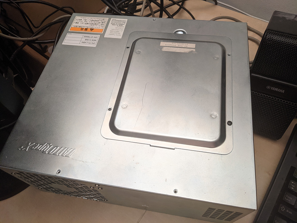

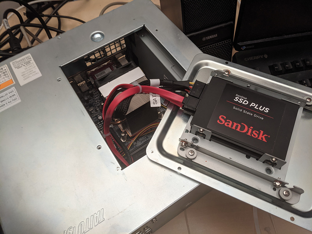

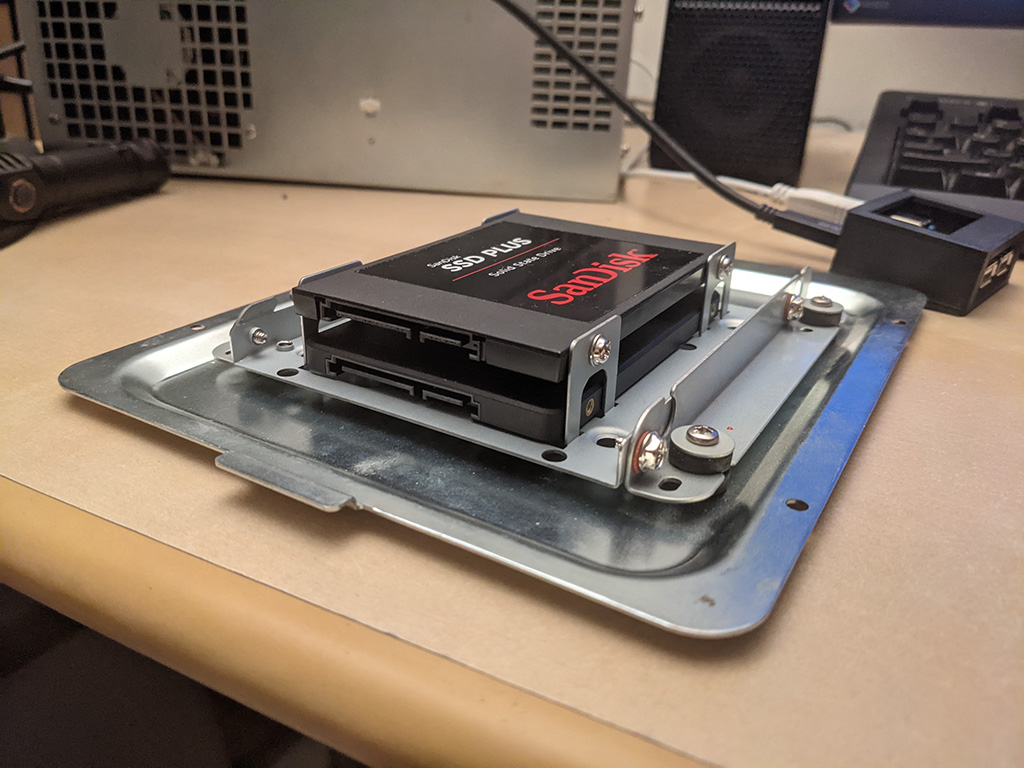

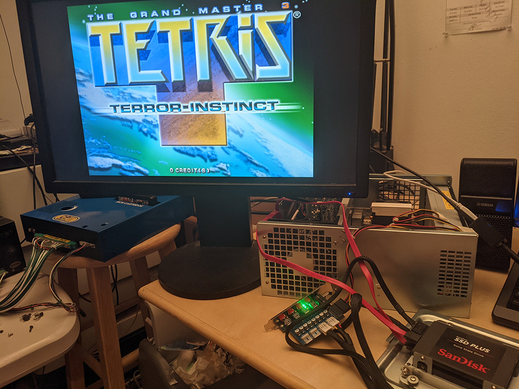

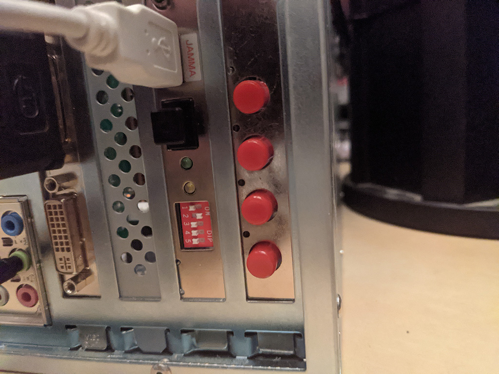

Not sure if this has been done, but here's my solution to run this and the multi without disassembly or swapping drives. I found that TTX2 will boot to any SATA port with a powered drive, so all that needs to be done is switch power between the two.
Order the following:
Dual 2.5" to 3.5" bay adapter - https://www.amazon.com/dp/B00FSVL95Q
SATA power switcher - https://www.amazon.com/dp/B07S98LRW2
SATA power extension - https://www.amazon.com/dp/B008ZB50SS
Here are the drives in the adapter mounted to the TTX2 plate, the ports should be on the same side as the tab:

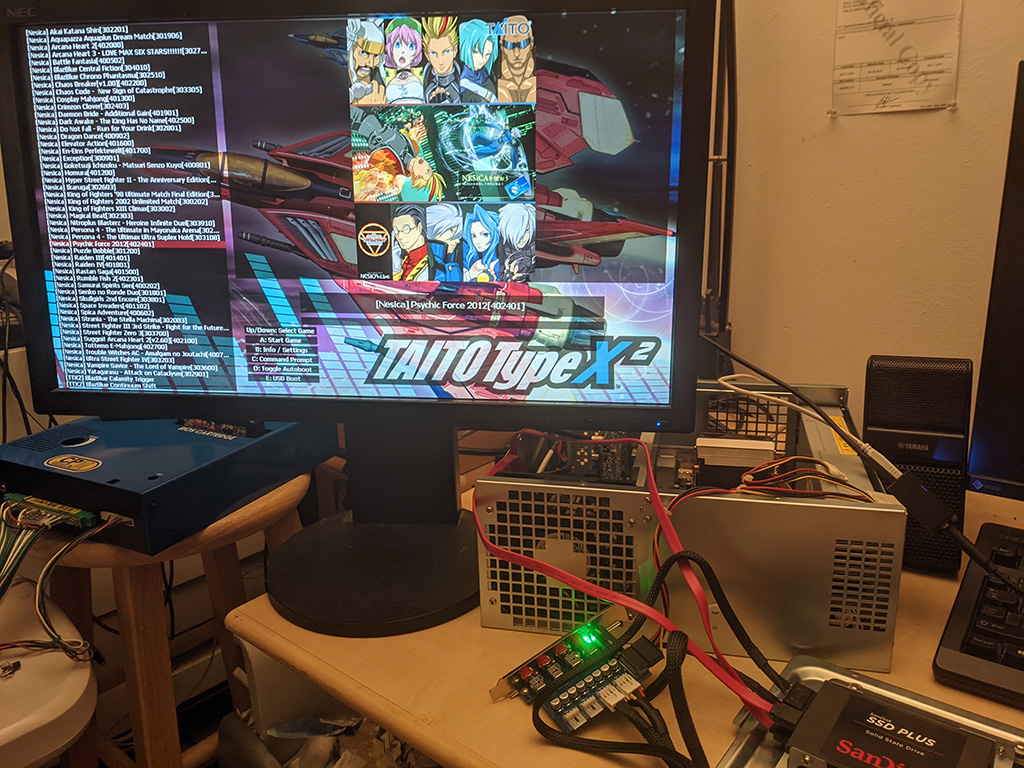

Testing before putting it together, multi is on SATA1 and TGM3 is on SATA2. The order of the EI connectors on the switcher PCB corresponds exactly to the button order, disregard what's on the silkscreen:

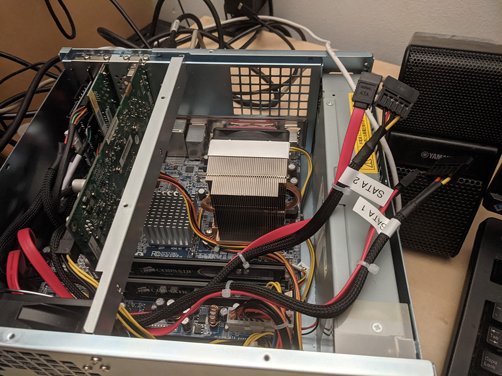

Installed the switcher and tied together and labelled the SATA1 and SATA2 power/data cables. This is so there's no confusion if drives need to be swapped later, only the HDD plate can be removed. I actually forgot to order the SATA power extension cable, and the cable from the PSU is too short, so imagine the power extension cable is plugged in to the switcher PCB here:
Top cover installed and drives connected:
It closes with no problem:
I moved the JVS I/O over so the buttons are closest to the edge. The top two buttons select the drive. Of course, this should only be done with the power off, and the previous drive should be de-selected before choosing the next one:

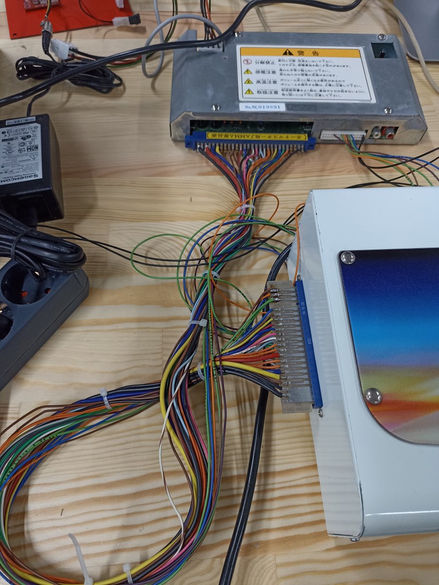

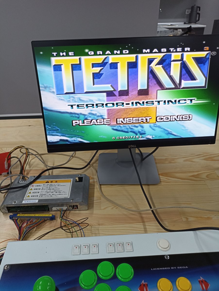

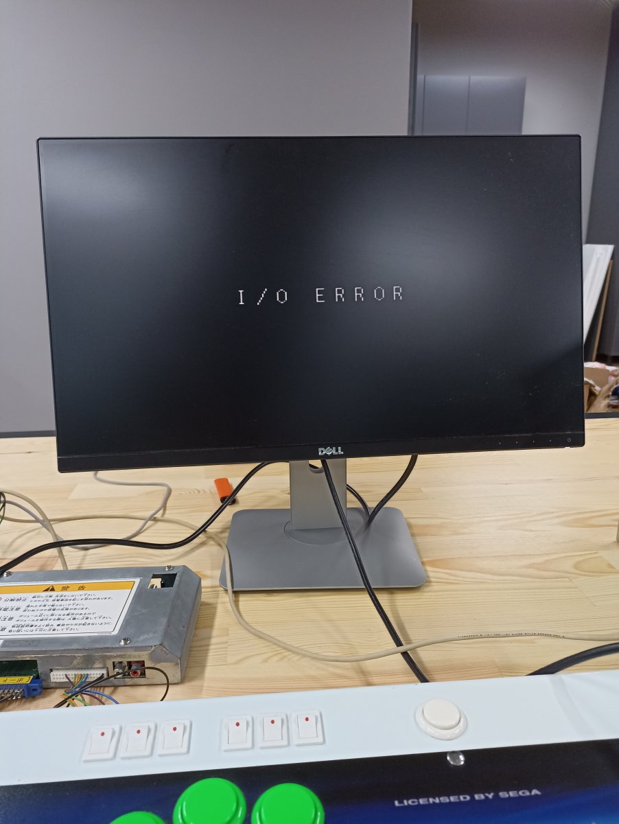

Hello people
Tgm 3 starting with my Capcom IO
But when i put the jamma connector from my board master supergun, it says Io error
There is no electricity on my supergun, i only want to use buttons.
As i said, the game opening with Capcom İO without jamma connector. But io error with jamma connector
Any idea ?
Note: my setup is working great with tx2 Niko's multi
Capcom io + board master supergun
