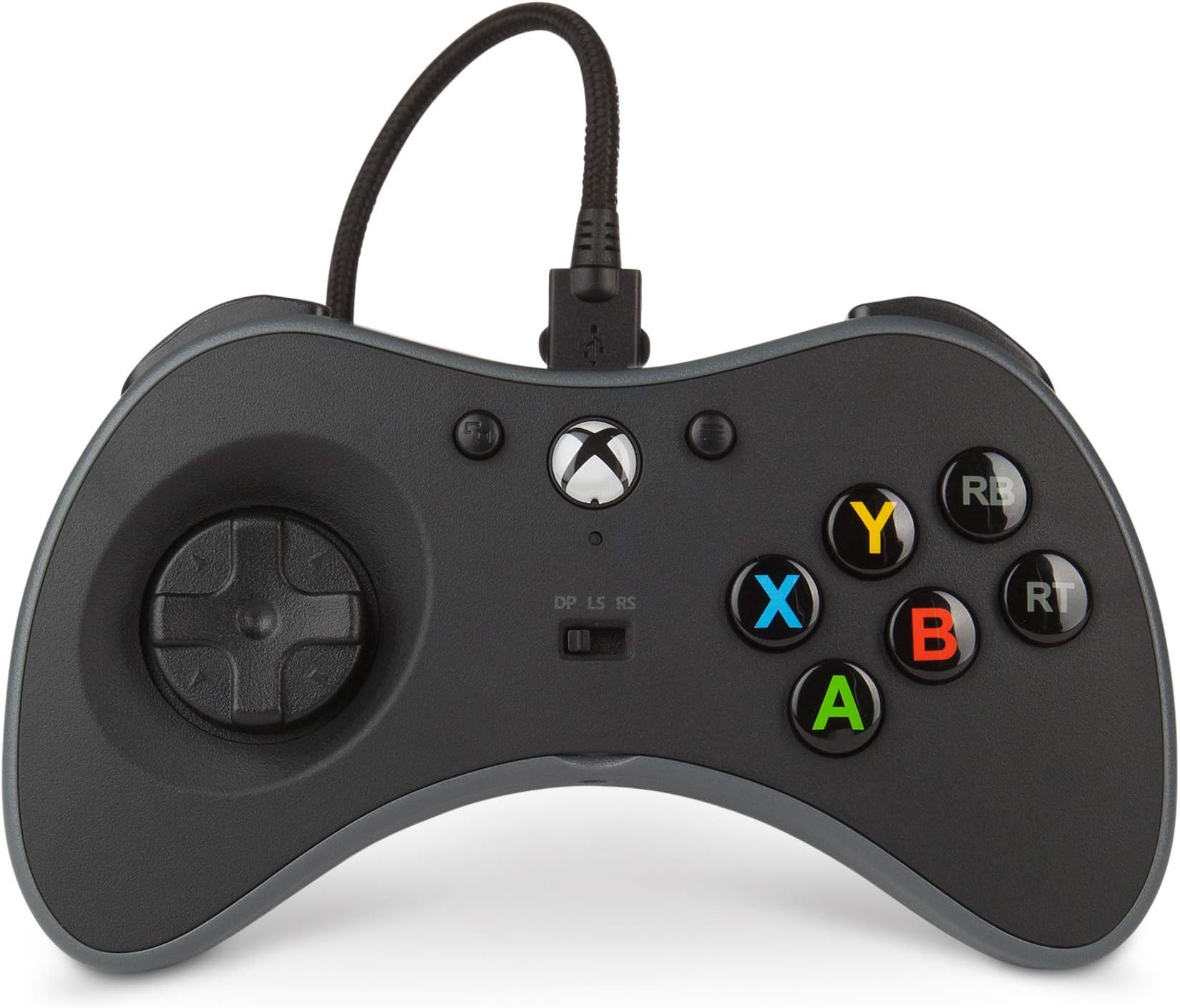

Here are the PowerA PS4 and Xbox One Fightpad
They are all officially endorsed products by Sony and Microsoft
And according to some Tournament players they are quite good
I have tried them out - They are quite good - I can do Zangief's 360 without much effort at all
But for some reason when I used these on my HAS and CPS2 and DB15 I cannot press these 2 buttons
Insert 1 Coin
and
1 Player
They just do not seem to register
Insert 1 Coin
and
1 Player
Interesting. Sadly, Coin & Start are not remappable via the button mapping mode in the decoder. Maybe some day I can find a PowerA pad and figure out what is happening.
-ud
