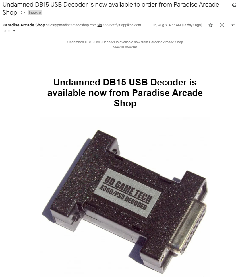

I have a large stock of DB15 that I just need to send out to distros. The Terminal Block will continue to me made by Paradise. I can probably work something out to get some of those out to other distros.
Good to know! Thanks for this. I’ll pick some up from Paradise hopefully soon then.

Is it just me or the moment they get restocked at Paradise Arcade it gets sold out instantly? 😅
